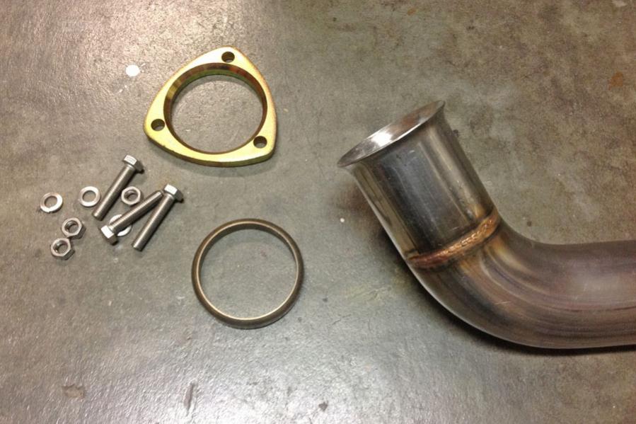

I finally got a run of 10 done and did a test install on a local coupe. Fits nicely. His coupe had the original more curved version of the pipe. The mandrel bent pipe fits great. The newer BMW ones are bent but not with a mandrel so the bends are a smaller diameter.
If anyone is interested $275 plus shipping. These will only fit the stock rear muffler that came with the 3.0. I can cut the length to your preference. The one in the photo is just about even with the outer edge of the rubber bumper.
Parts included:
2-3/8" (60mm) diameter stainless steel pipe (mandrel bent with one tig weld near muffler pipe flare). The end of pipe visible at the rear will be polished.
New metal "O" ring (for mating the two flares).
Stainless steel bolts.
Used 3-hole flange. If you want a new one then add $10, otherwise I will reuse the old ones. They need to be slipped on before I weld the tab that holds the rear of the tail pipe up.
Rubber holder and stainless bolts for rear support.
PM with questions, etc.
