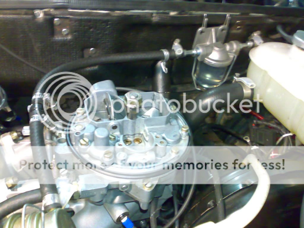

I run a clear filter for my triples. Between the tank and pump. Reassuring to see what's inside.

Yea, in theory you can inspect the plastic filters for debris. But my sense is that by the time the sediment became easily visible, you would already be experiencing problems.
