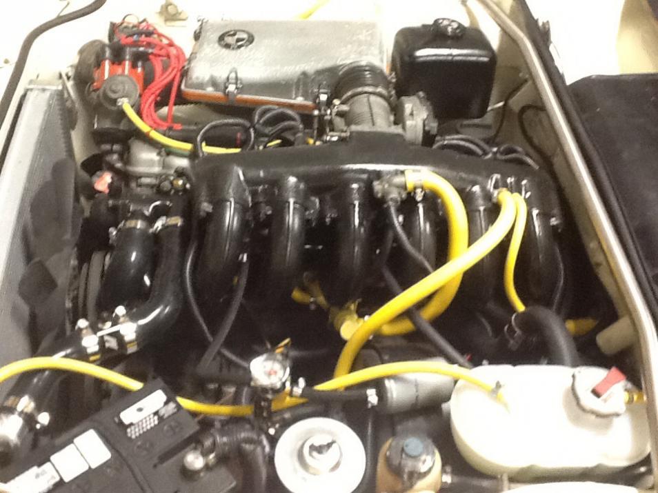

Chris, maybe you can persuade me that stock is bliss, but I doubt it. I did take that funky air intake out -- gave it to my son for his 240z. I am leaving the yellow hoses though! I like those.

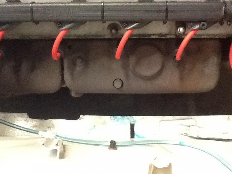

Steve and Barry -- neither of you installed headers? I suspect they're just a waste of money; a younger me would "need" them, so I could say I had headers...

Toned it down a bit; stock air now... Yellow tubing didn't kink as easily and replacing so many really tight bend ones... Couldn't find some of them.
