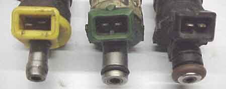

However the D-jet type injector only seems to of come in one "size" flow rate and is 2.2 ohms
Most modern Bosch injetctors come in the 14 - 16ohm range and will not work with a D-jet ECU without extensive electronic modifications.
2 physical configurations, Barb or clip connection to fuel rail
Fuelling rates (cc/min or lbs/hr) are colour coded by bosch:
Ranging from Grey through to Gold top bodies
However for a NA engine like a 3.0 or 3.5 6 cylinder BMW engine Yellow top injectors are fine.
For racing/modified engines you could use Green which is what a lot of the race rally crowd use. (typical example being Ford Sierra Cosworth)

They seem to be fine. The resistance is spot on though they are green top rather than blue.
Glad that was of some use - be interested to know which Jag they came out of. (XJ6 4.2 or Jag V12 at a guess going by the injector colour coding) Do they have D (small) or L type (large) connectors?
I suspect they could be Lucas injectors as I know they got into injection systems and many 1980's - 1990's UK cars have a mix and match of Lucas and Bosch EFI bits
Must of been a licence agreement in there somewhere. Kind of ruined the Lucas "Prince of Darkness" reputation being relatively reliable :wink:

My car currently has green topped injectors 0280150035
Perhaps I have found the reason why it is running out of power under heavy load?? These flow 380 vs 454cc/min that the 043 injector does??
