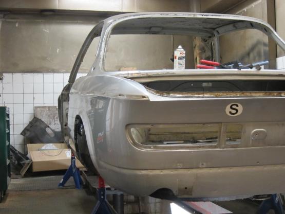

I rent the place from a friend. Here comes a few pics, before and after.

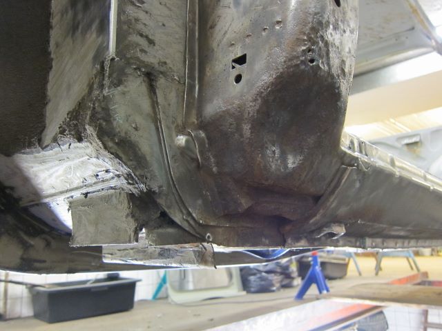

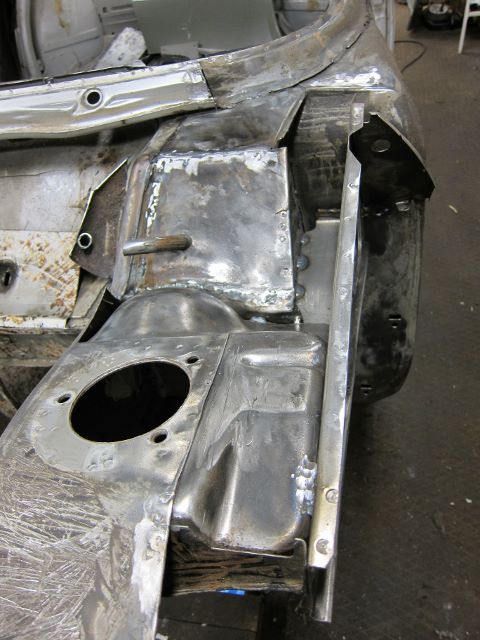

The car [CSI 3,0 from 1974] was possible to drive two months ago. The paradox with the rust issues is that some places, like front, back and under the car, was spotless but bad on other, like the lower A-post and outer sills. The rust was hidden. We have replaced all door mirrors, both plates in the trunk, all floor panels, outer sills, panels for front and rear sills and a lot of panels in the front that holds the fender etc. I think that the car will be more stable after we have strengthen the major places. The 2,5 mm plate on the right side, that hold the MacPherson, was loose f.e.
I will try to post some pics duringe the work.
/T
