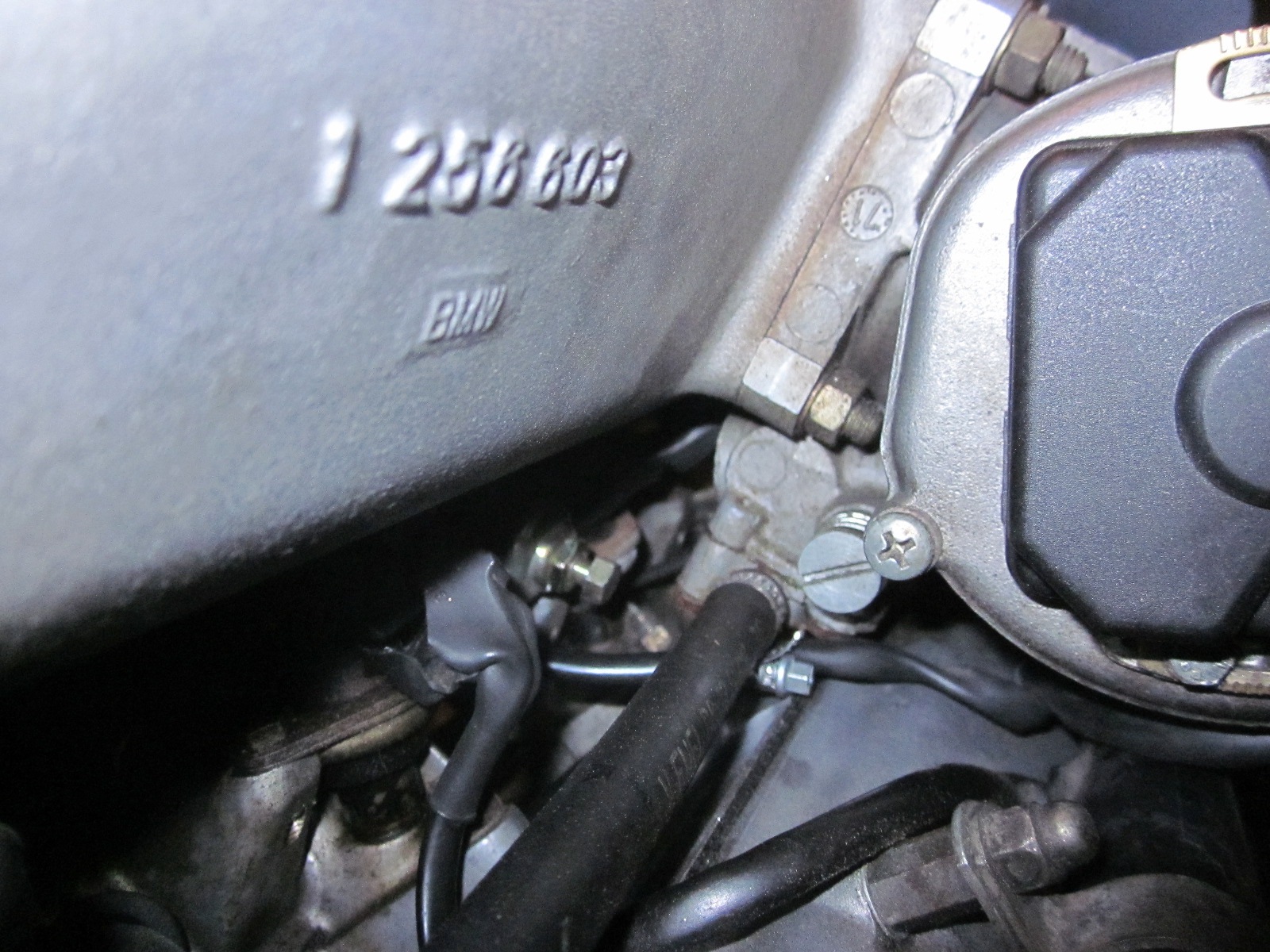

Idle is controlled by 2 separate screws. Most likely the one on top of the throttle body is adjusted far from correct specifications. The large screw under the throttle body fine tunes the operating temperature idle, small adjustments clockwise or counterclockwise 1° to 5° yield vastly different results.

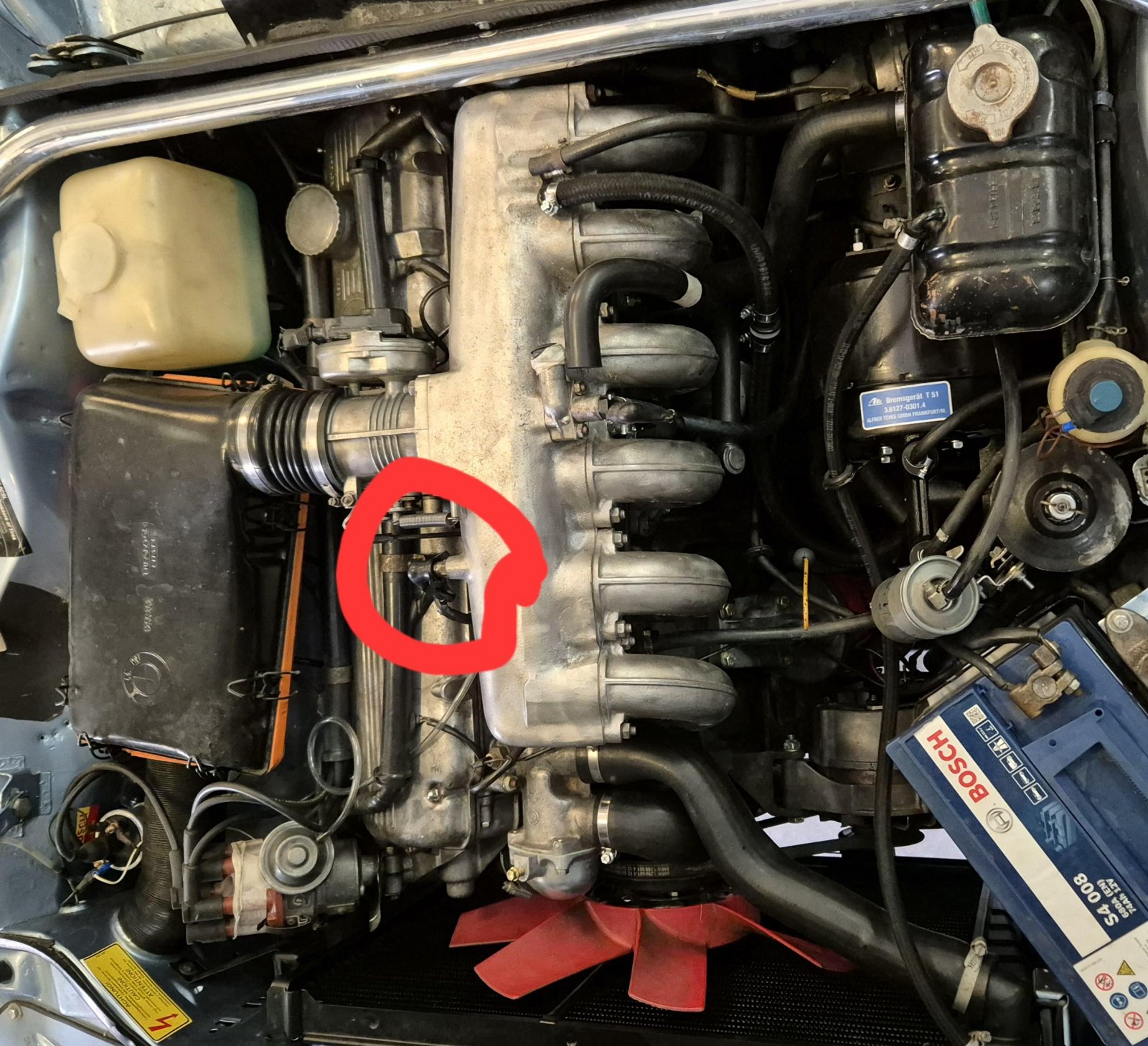

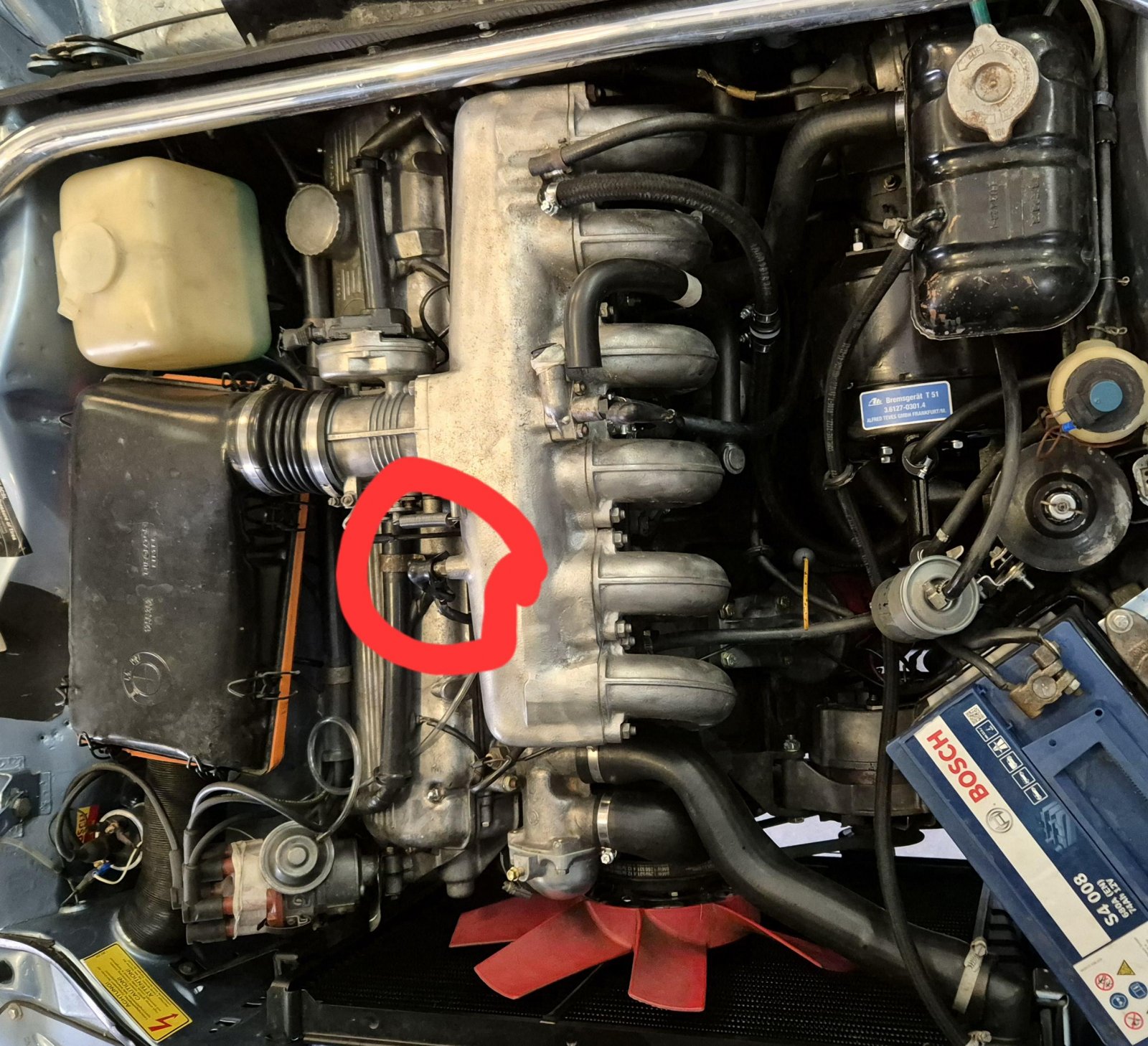

So we decided to get back the original ignition in place, then we went for changing the idle valve which wasn't working properly, found one on ebay, and now same issue.
You start and idle is fine, and the warmer the engine, the higher the RPM, if you change advance at ignition it gets down but it's not working properly, and if you put the right ignition setup, the idel is above 2.000rpm.
If I unplug this probe, it gets lower, but not enough.
I'm lost here, I'm starting to think the issue comes from the igintion unit...
Yes, if you set it up correclty, idle is way to high when in temperature, if you move it you reduce idle speed but the engine is not working properly anymore.
