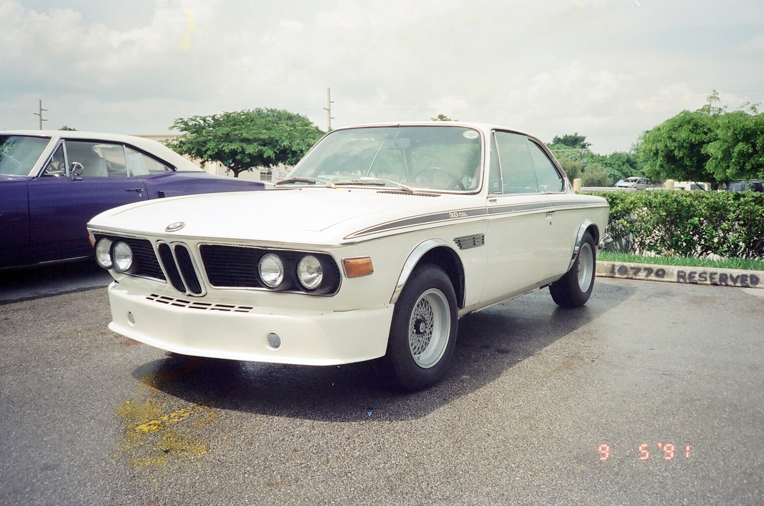

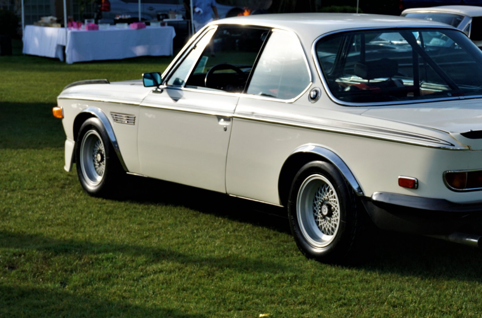

So my previous CSL had 14" Mahle wheels that had quite a bit of dish. They were allegedly the wheels that came on the car. I've recency seen a pic of another CSL with these same Mahle wheels.
Were these an option on CSLs? I remember them being quite light.
My old L and recent pic found.

They were an option. It is very easy to get the wheel incorrect also as there were numerous iterations during this time period.

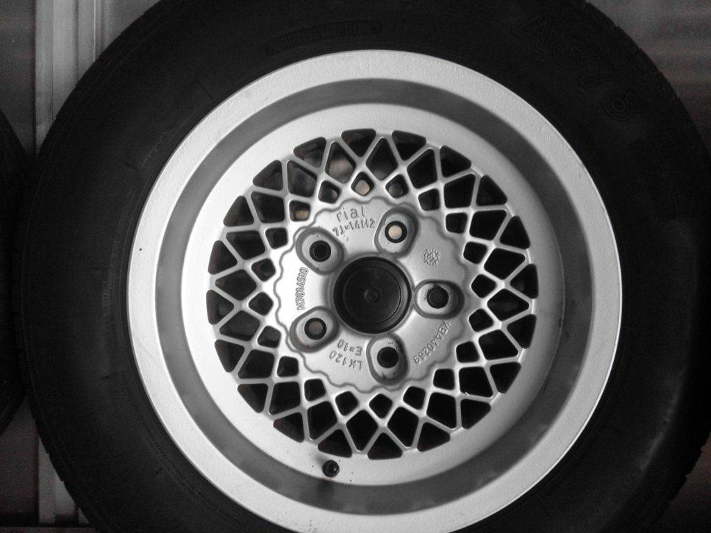

Basic dumb questions. What are Rials? Aftermarket wheels made to look kind of similar to these or were they original equipment on anything? To me all these are best on sportier cars than mine, but I got tempted recently buying some other parts from this seller/member.
Jay, not sure what you are looking at. The majority are 15s...

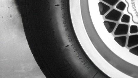

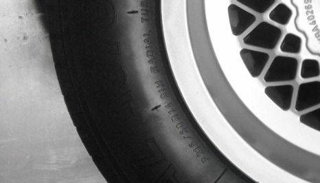

As I told a young associate, if you'd just improve your mind reading, I wouldn't have to explain things clearly. I was talking about the tires on the Rials for sale. The tires in the pictures in the Rial ad look like 215/60 R14. I don't understand how those work on a 7x15 wheels.

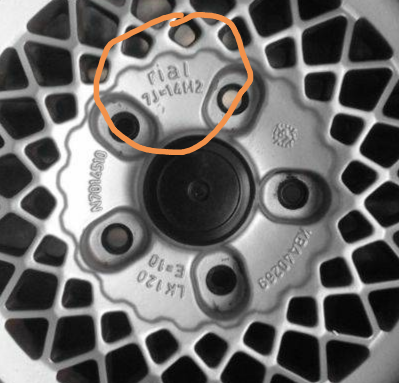

The wheels are 7x14", seems like the seller doesn't know what he has. If you look closely in the center you'll see the 7x14 markings :D
