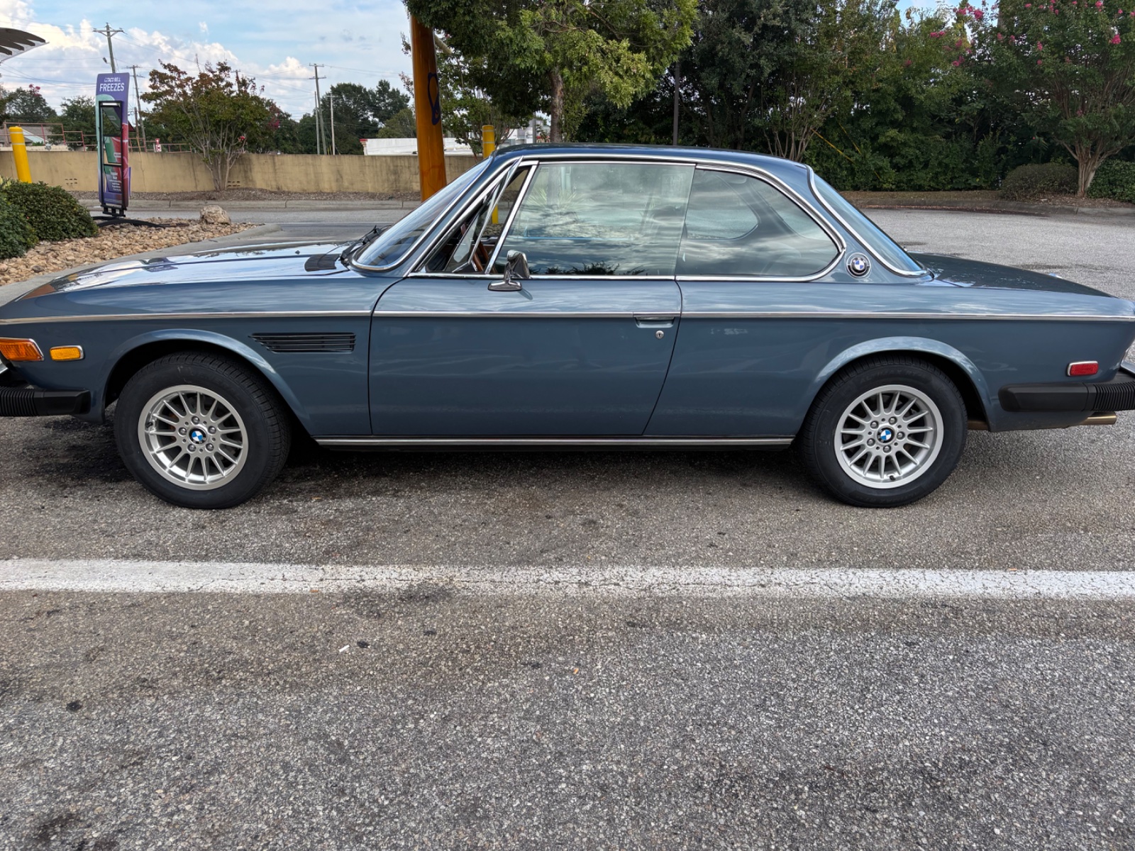

Alloy Wheels Direct out of the UK has custom wheels for sale. The wheels I bought were 15x7 style 32 from the e34 spec. They are 5x120, et20 with the 72.6mm hub diameter. I mounted General Altimax 205/60r15 tires on and the revs/mile is 842. The speedo at 80 corresponds with WAZE gps precisely. The wheel gap at the strut is approximately 6mm. To be safe in spirited driving, I ordered 2mm spacers from Dinan. The tire clears the fender by a good amount and doesn’t appear to need a fender roll. Attached is a photo of the installation. Dave
