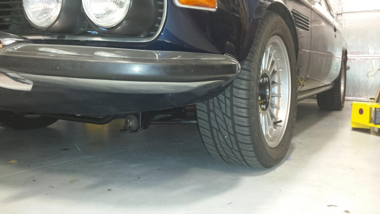

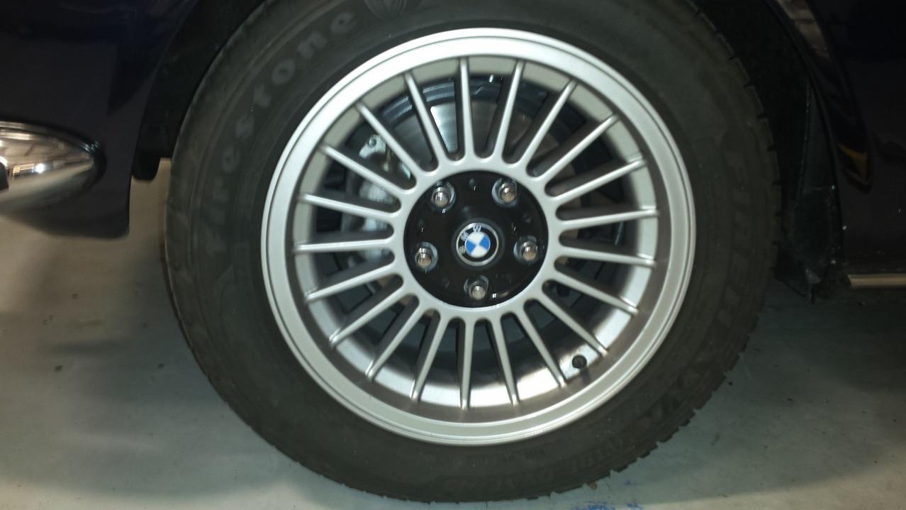

same on all 4
So here are some shots of the tires they are 225/50/16 Firestone/Firehawk. I was much more trying to get fitment at the time than performance but I do like them. As I mentioned below, grip is very good but ride can be a bit "harsh"; I put that up to the Bilsteins, CN springs and the 16 in. wheels more than the tires. I also have (-) camber plates front and adjustable rears. Hope this helps.
