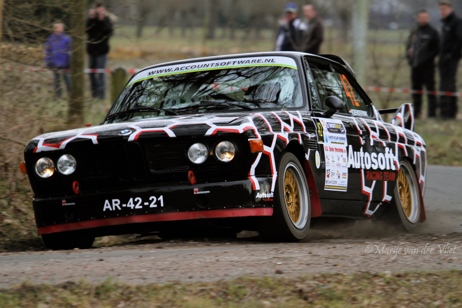

as i don't want to go of topic in rsporsche steering wheel thread , i started this one...
it seems some do not like my Schnitzer rims . :p:D
But what options are there ? i need 8.5 x 17 ET13 and ofcourse the exact diameter centering , no fiddling with adaptors !
17" to clear the Wilwood calipers
8.5 as i want 245 tires
Don't mind the 17" ... they are indeed big for a E9.
I have 2 sets now , the grey ones with rain Michelin Alpine , the black ones with dry Kumho semi slicks.
I can buy those rims around 500 euro/set , so i don't have to worry if i may damage them in rally.
I'm open to suggestions :)

Barry, I like your car and the black Schnitzers look great! Perfect to that rally look with extra headlights and stickers. But keep the outer chrome ring on the wheels as you have, they make all the difference!

I think he already has 8.5 width wheels and gave the exact offset that he wants/needs. The wheel he describes is just about three quarter inches closer to the strut, and three quarter inches closer to the fender than a factory 14x7 ET11. An ET20 17x8” wheel such as a commonly run RC090 is actually even closer to the strut (.8 inches total) than an 17x8.5” ET13 wheel. So, as long as Barry has the proper fender clearance, his 8.5” wheels (that he is already running) should be fine. Looking at the pictures of his car, his front fenders are a good 1” wider than factory. It looks like he has this covered.

Didn't notice until now that those look like fender flares on his E9. That explains how he can get some wide rims/tires on the front.
Thanks for the suggestions so far ! Indeed , the fenders are "flared" to accept the 8.5" ET 13 rims with 245 tires.
Tires just clear the suspension .

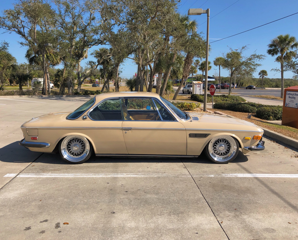

Do the front wheels turn on this? It doesn't seem possible from the photo, but I guess they must.
It has adjustable air ride suspension. It’s sitting on the oil pan in those photo because there’s no air in the bags at the moment. Once I get in the car and push a button to my desired ride height it will be at a normal height
