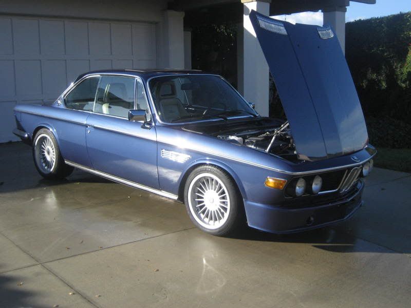

Maybe I imagined it, but I swear I saw a picture recently posted of an E9 with 17 inch staggered Styles 32 wheels on it. I believe the picture was taken at a car show and the car was Polaris. Anyone have the picture or other pictures of that car? I recently picked up a set of these wheels. I have no intentions of putting them on my coupe but now, out of curiousity, I'm wondering if they would fit.

Thanks for link! That's exactly what I was looking for. It looks like they fit, I guess the jury's still out if I like the look.
Hey Vince
That 3.0 with the style 32 is my car. They do fit and the ride is surprisingly not bad. I am running a 255 series rear and the will rub the lip if not rolled. I have still not figured out if I link the look either I will know better once my suspension is done then I will make my decision. I swapped just because the originals had some major dry rot on the tires and this set up was laying around. Believe it or not my 73 is parked side by side with the 74 which is stick and they have the exact same ride height.
