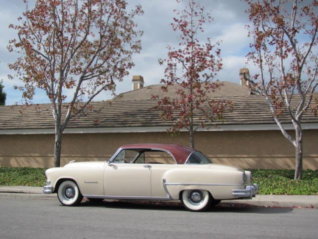

Last, a photo of our '53 Imperial Newport (an original 68K example and one of 823 built).
