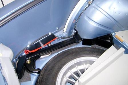

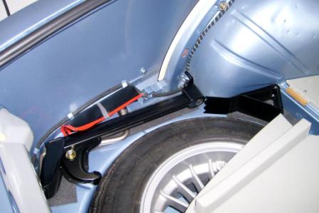

I am in the process of completing my car, I was hoping the forum could shed some light on how the jack, tire iron and wheel chalk mount in the trunk of the car?
Here’s a pic from a members car……. as to the correct placements. Don’t mind the toll roll, you probably have a took ‘box’ attached to your trunk lid.
