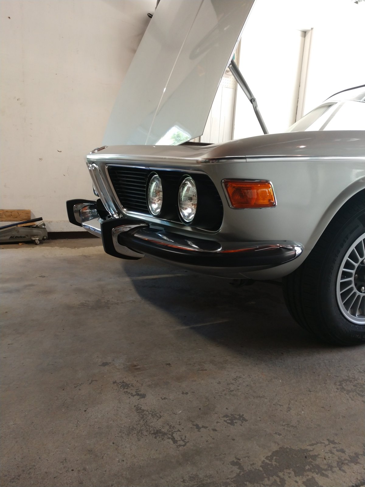

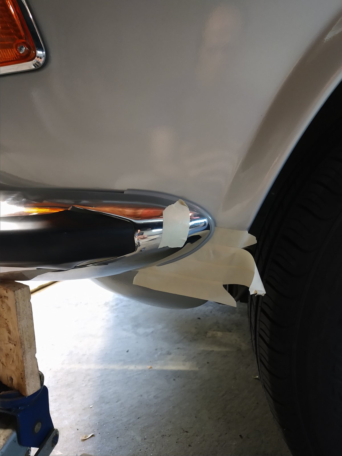

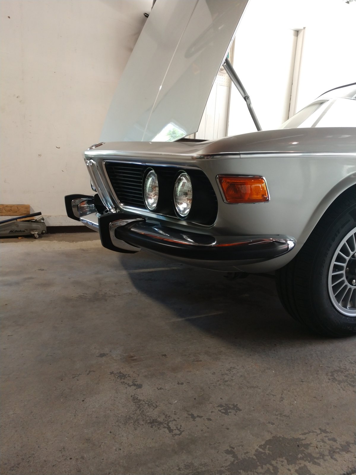

My front fenders don't have mounting holes predrilled so I'm getting her as close S possible to stock look. How does this look? Up and down alignment is centered over the stone chip line, and in / out adjusting is aligning bumper edge nearly to wheel arch lip.
More important to me, anyway is the 10' test of "does the bumper parallel the earth"...then all is good.
I overthink everything on this rebuild, this phase included. Thanks for the tip to trust my eyes! Wasn't too bad to line up.
