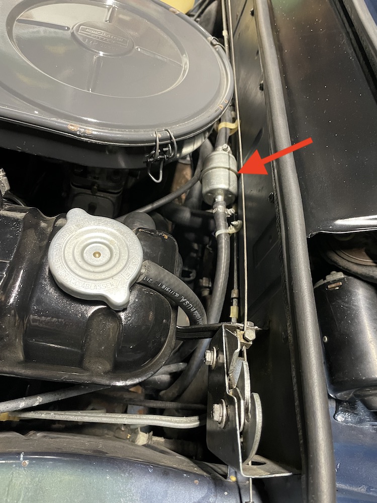

Here is an example of what Chris mentions...
Thank you @Dick Steinkamp I was peeling back the firewall foam trying to look for a filter back there in that position. I'm just so surprised there isn't an in-line filter, I was following the fuel line all over the place and just knew there had to be one somewhere -I guess not! o_O

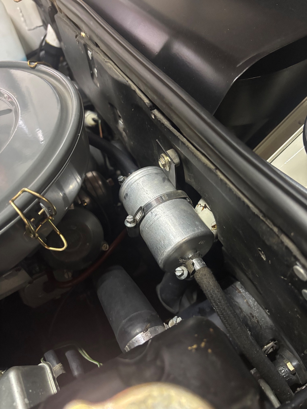

The m10 motor with mechanical pump in my NK with a Weber carb uses the Tii metal filter mounted next to the battery. It works just fine and looks correct.

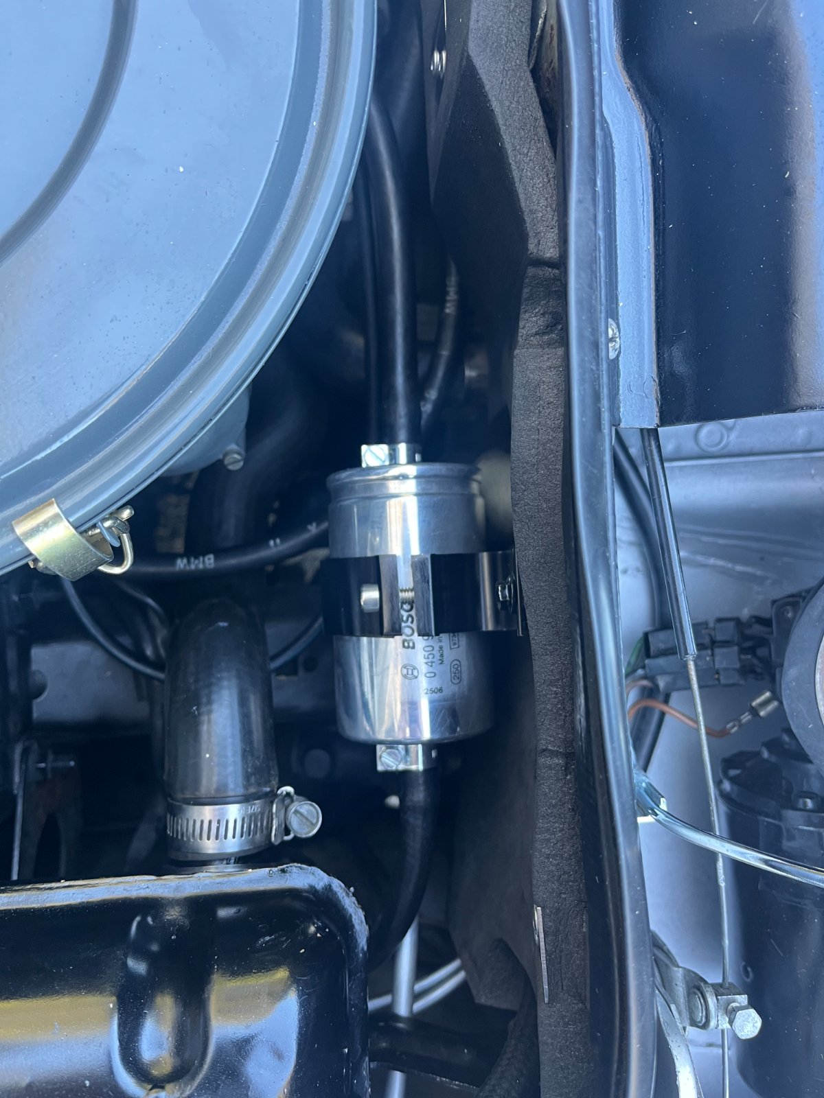

For 1971 2800CS
I just ordered the Bosch fuel filter and would appreciate any feedback on mounting options. Photos would be especially helpful.
My current plan is to mount it on the firewall, similar to the setup shown in the photo that Dick Steinkamp posted.
One question I have is about how best to secure the filter. Would it be better to use a single 2" Adel clamp around the body of the filter, or two Adel clamps on the fuel lines on each side of the filter as shown in the picture?
Any advice or photos of how others have mounted theirs would be greatly appreciated.

That’s extremely helpful. I hadn’t noticed the two existing holes until seeing this post. Now I just need to find the correct bracket to mount and hold the filter.

I used a 50mm filter bracket from Amazon (link below). To make it fit properly, I removed the rubber insert and added electrical tape for padding.
For mounting, I reused the existing upper hole and added a self-tapping screw for the lower hole.

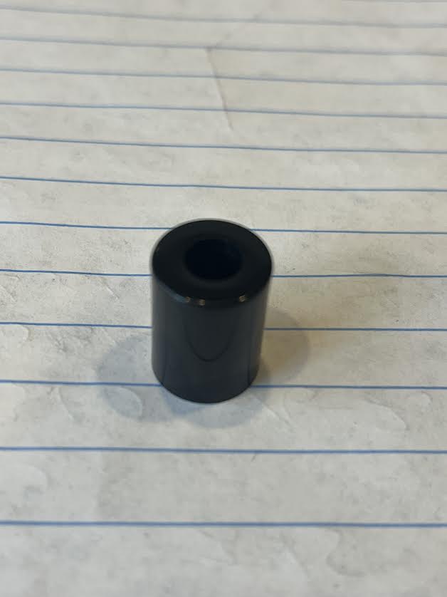

To avoid crushing the foam firewall insulation, I installed two spacers. This also helped position the bracket outward for a cleaner, more secure install.
With about half a tank of gas, I let the car sit before opening the gas cap. No fuel leaked from the line during installation.
For cutting the line, I used a PVC pipe cutter, which made for a quick and clean cut.
