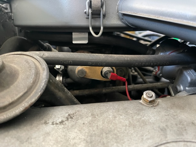

You are spot on. Got the car home and yep, the soldered connection had fallen off. Here's a photo of the idle valve. If you have an extra idle valve I will be happy to buy it from you. Thanks, E

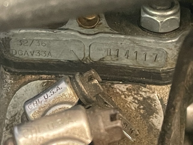

Here's the carb info as well...E

Well that's a very different solenoid! I unfortunately don't have anything like that version. I can only guess that the carb itself is some model specific DGV and probably from the 80's. I also don't see a way to substitute that part with just a jet and a cap to eliminate the solenoid altogether. If the carbs are Italian (read at least 30 years old) and haven't been rebuilt recently, it might be time to upgrade to newer carbs, side drafts, EFI, electric, pedals, ...

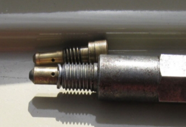

The idle shutoff solenoid can be replaced with a regular idle jet and jet holder. Note that there are two different sizes of jet bodies and jet holders. Get the ones that match the solenoid and jet in your carb. IIRC solenoids go with the large jets
So, you can interchange the shutoff solenoid with a large size idle jet holder. But not of your carb uses the small jet and small holder.

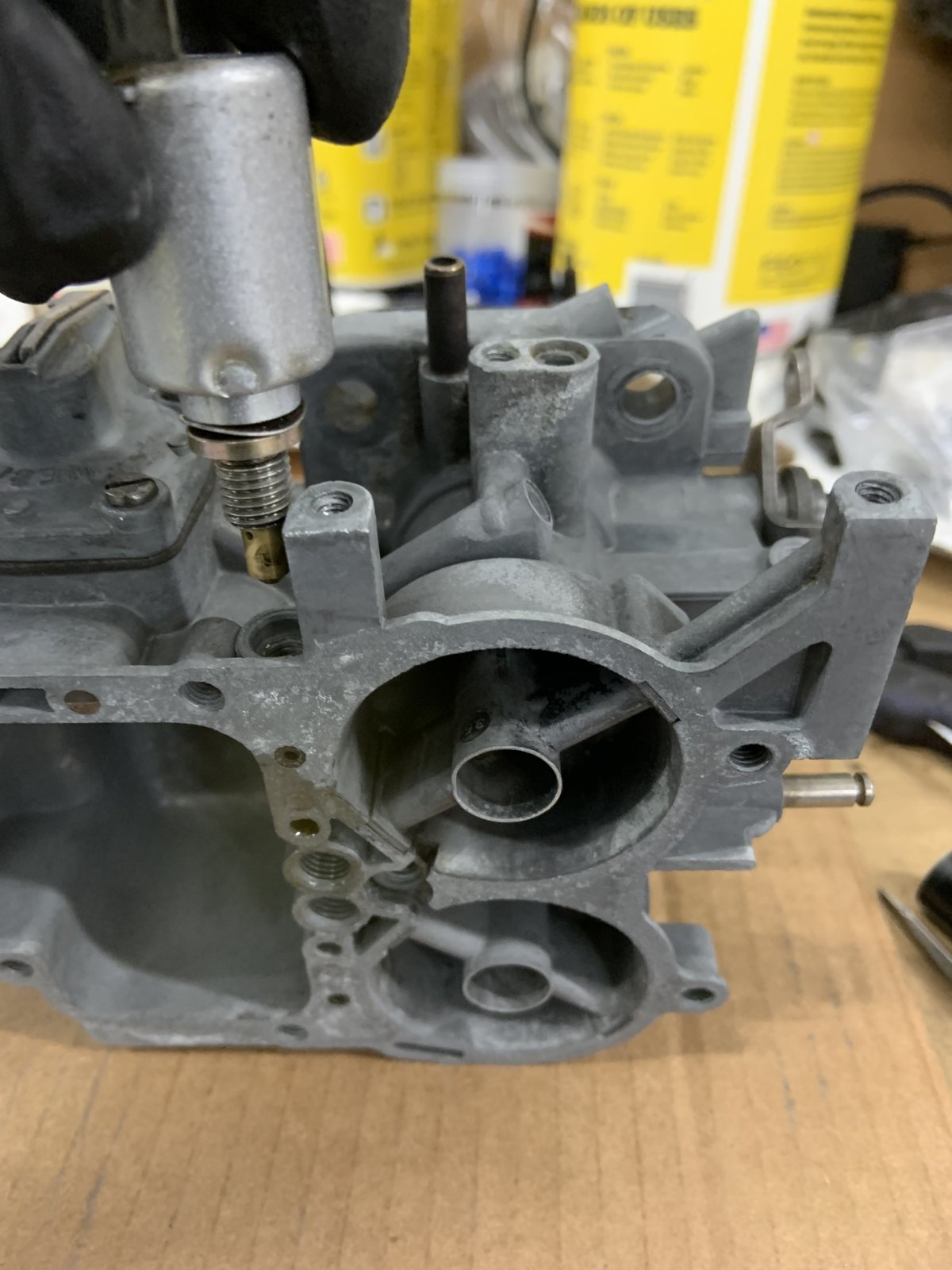

It would be helpful to see a close up pic of the carb where the solenoid goes in, and of the end of the solenoid assembly where the jet is installed.
Here is a picture of small jet and holder and a large jet and solenoid. To give an idea of what I’m talking about.

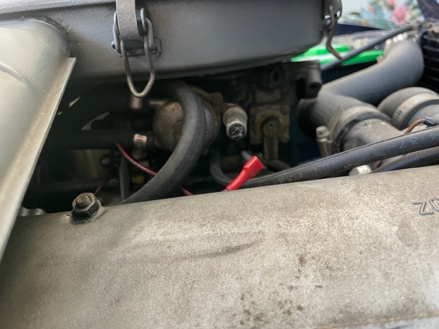

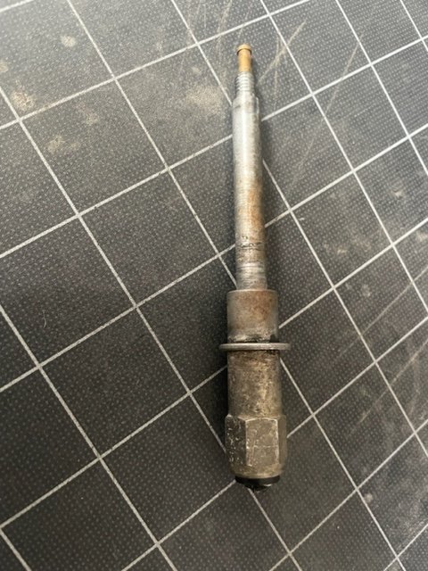

Is this the photo you need to see? 1. Idle valve 2. working idle valve 3. Broken idle valve. The red wire connects to Idle Valve. Can get tighter if needed...

FWIW, I have discovered that there are different idle valves. The longer valve you have has smaller diameter threads. Your carb base has 3 posts that attach the water choke where the ones that are on my carbs with shorter idle cut off only has 2. The attached pic shows the the 3rd leg for the water choke and even if that leg wasn't there, the threads on the longer valve are smaller. Not sure what the difference is except that the model number is slightly different with "32 36" and "DGAV03B".
