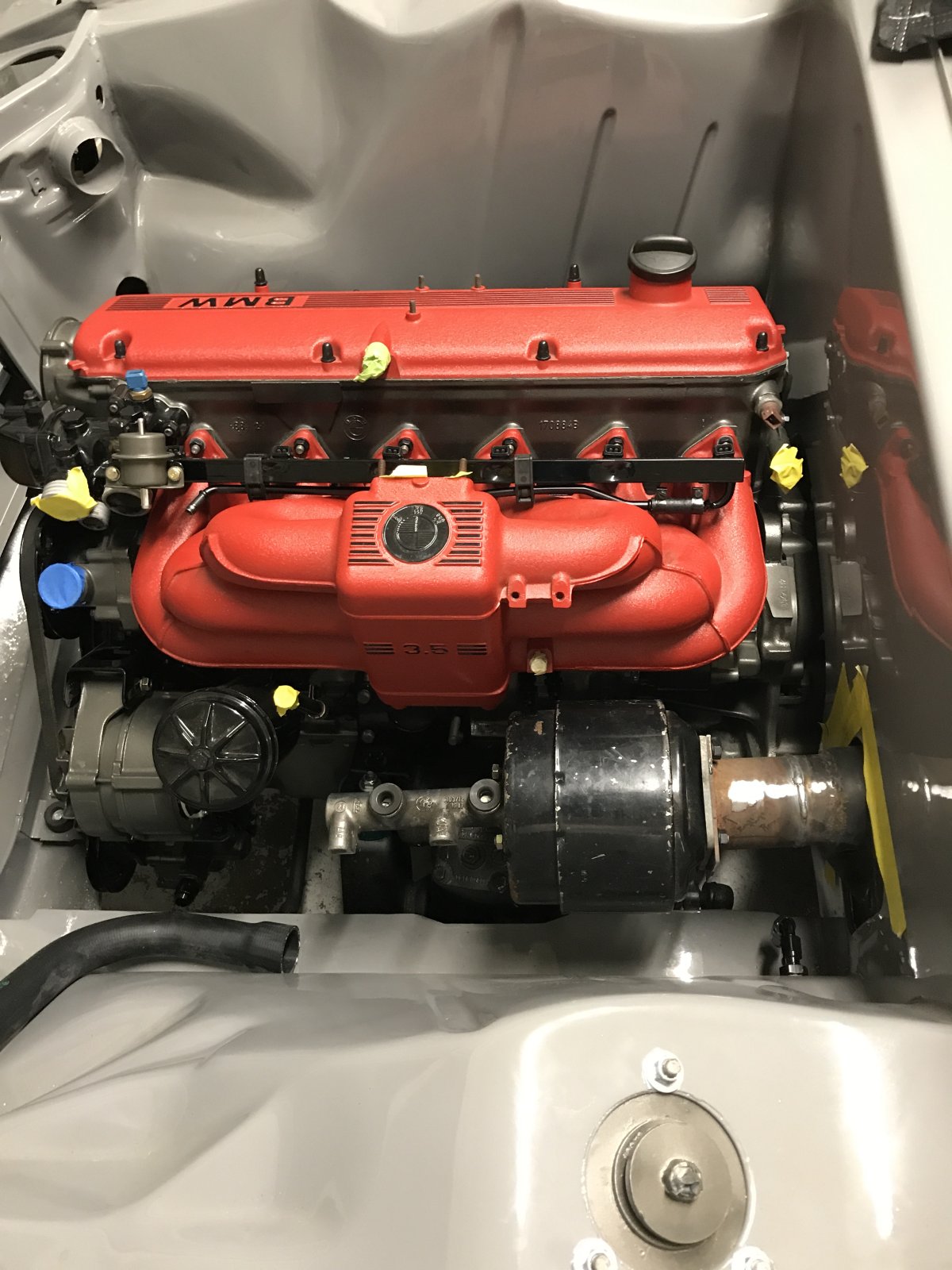

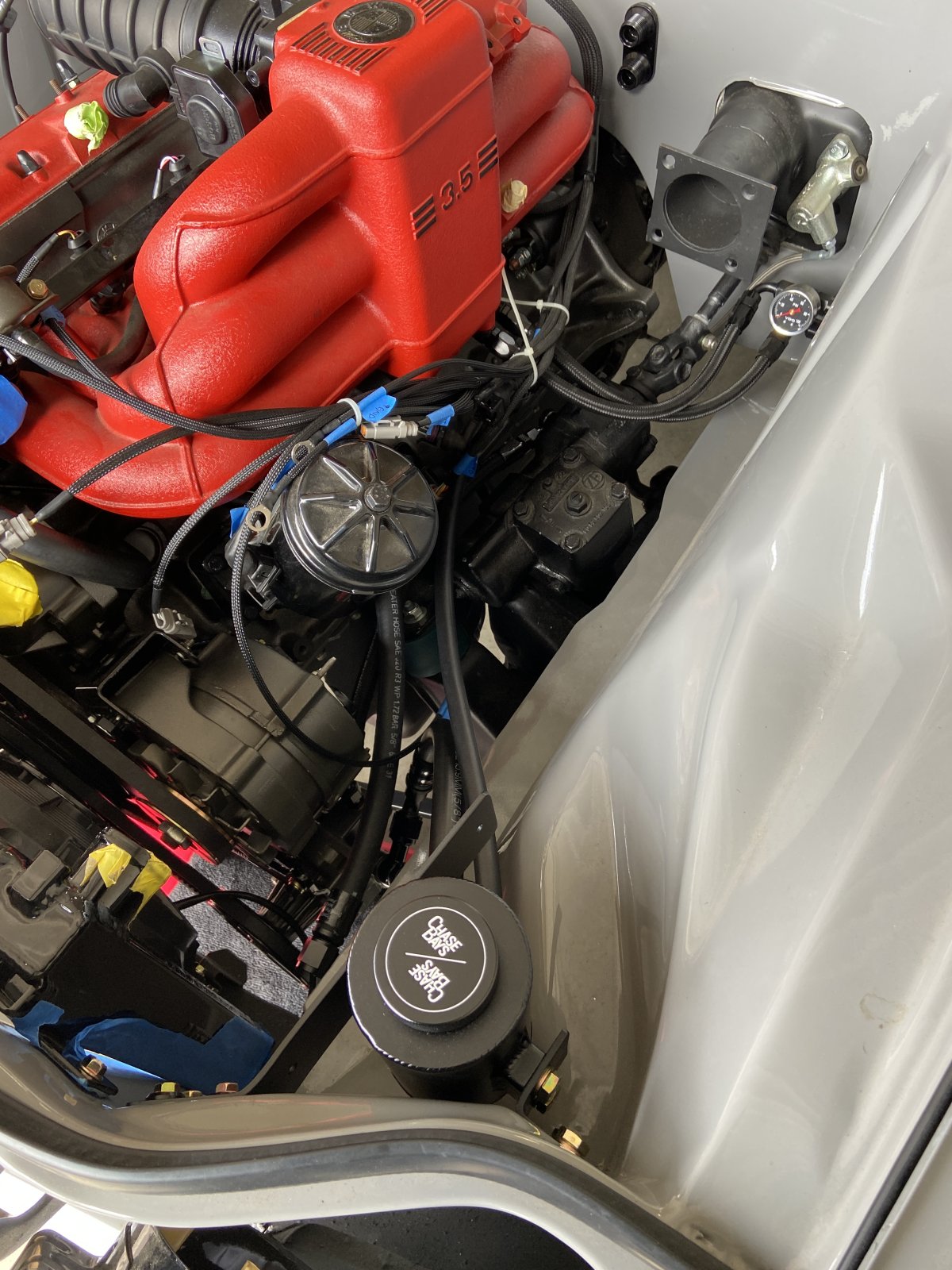

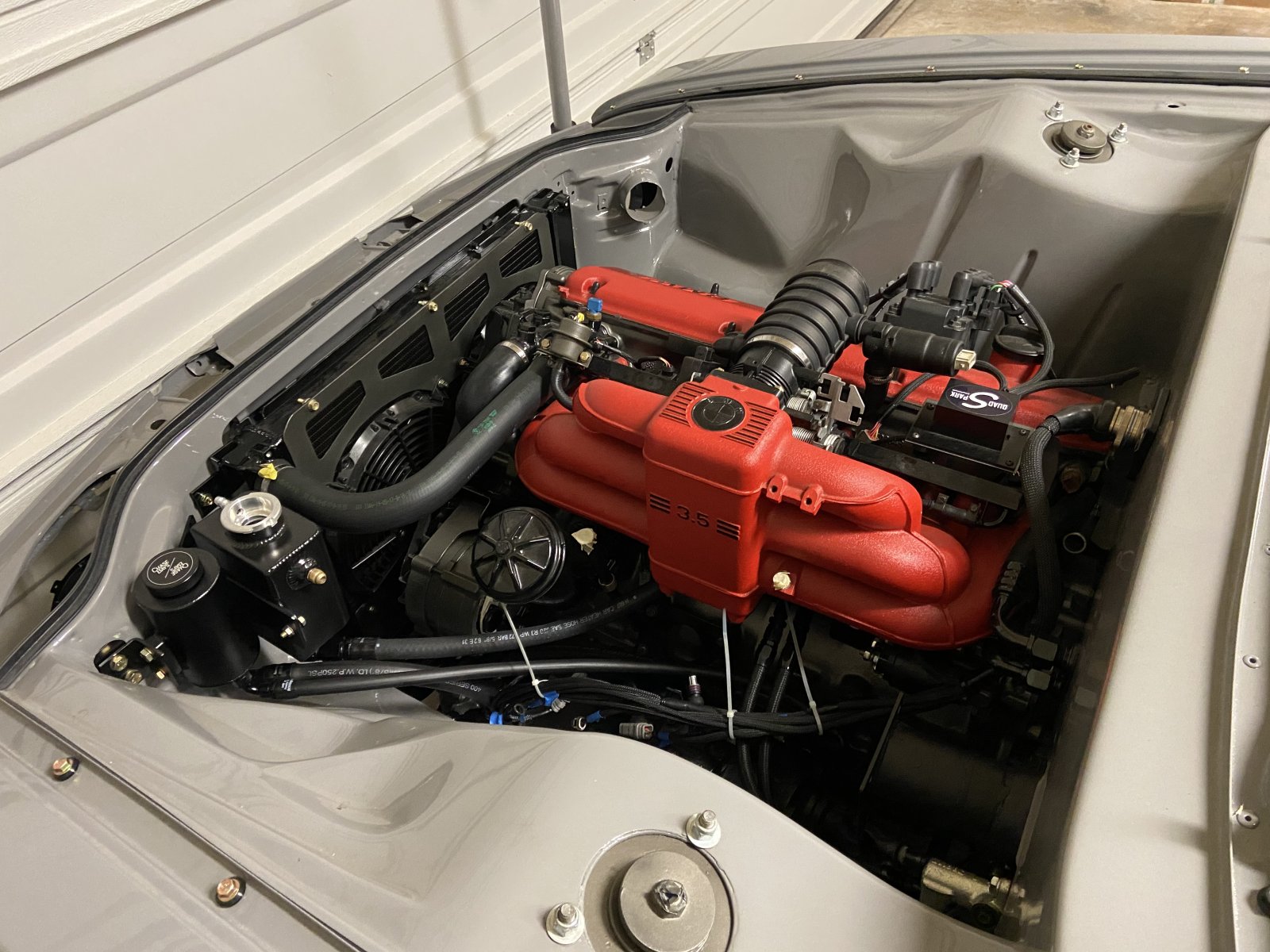

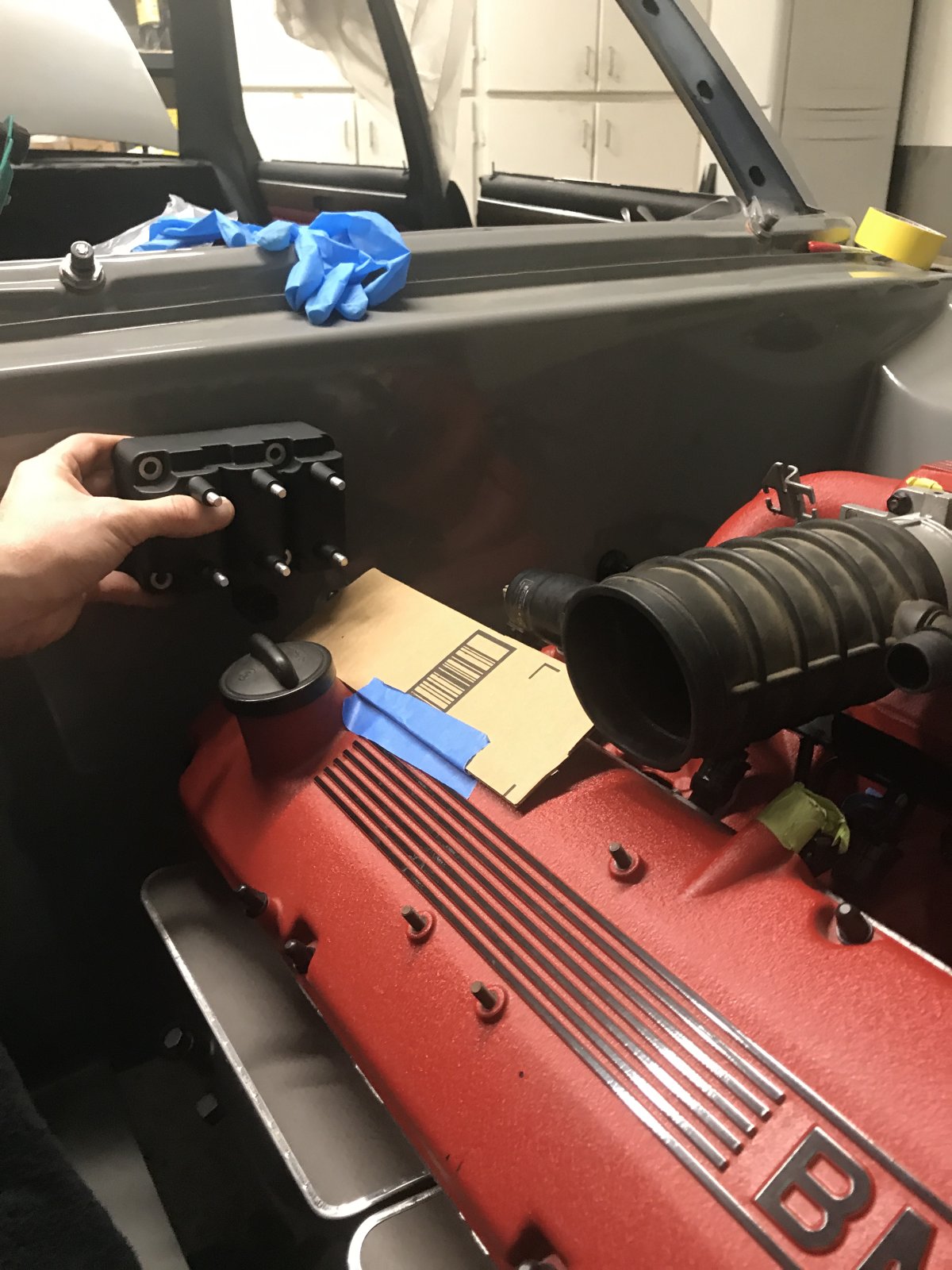

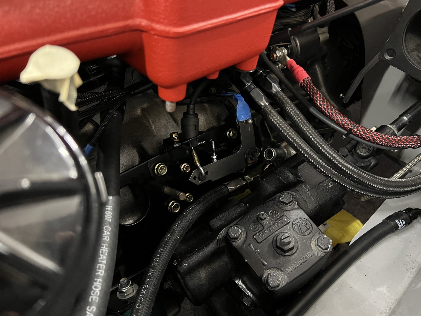

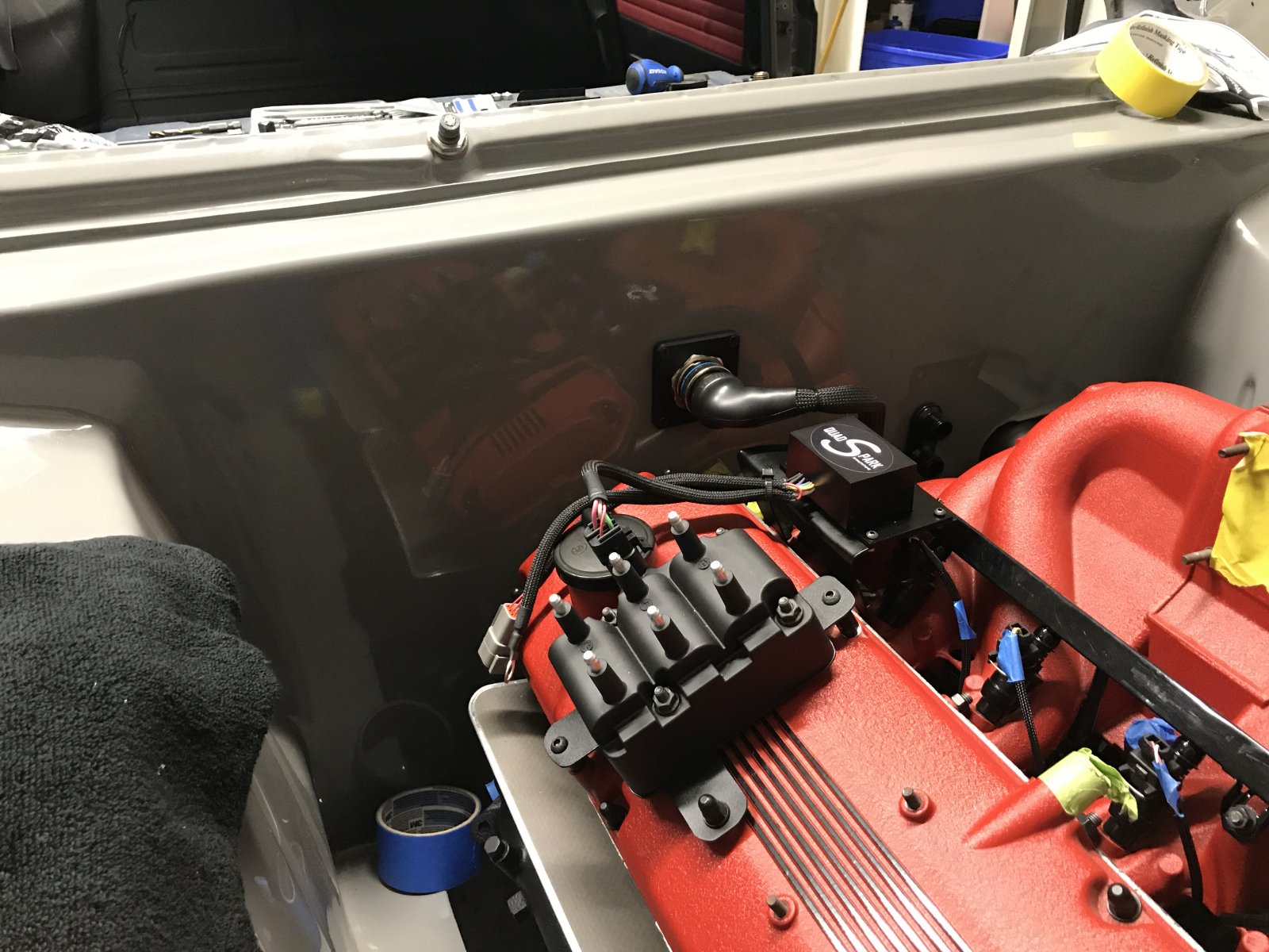

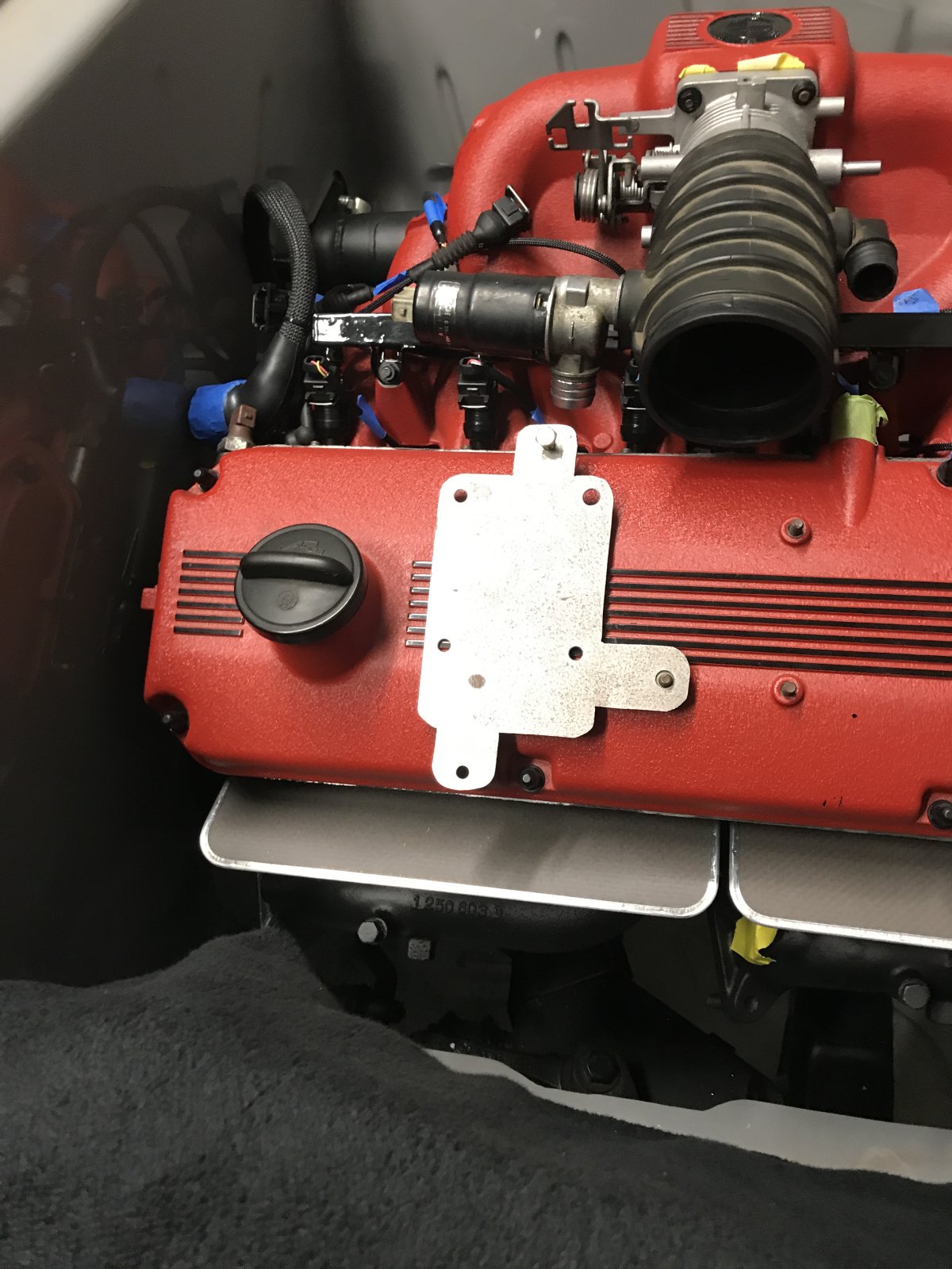

More pics... getting filters on the trumpets. There isn't much info on what to run if you don't have a plenum. On the Bav, there really isn't any space to do a plenum given the proximity of the brake booster and other stuff. I settled on these itg filters. They have a plastic structure on the inside and fit around the trumpets in pairs.

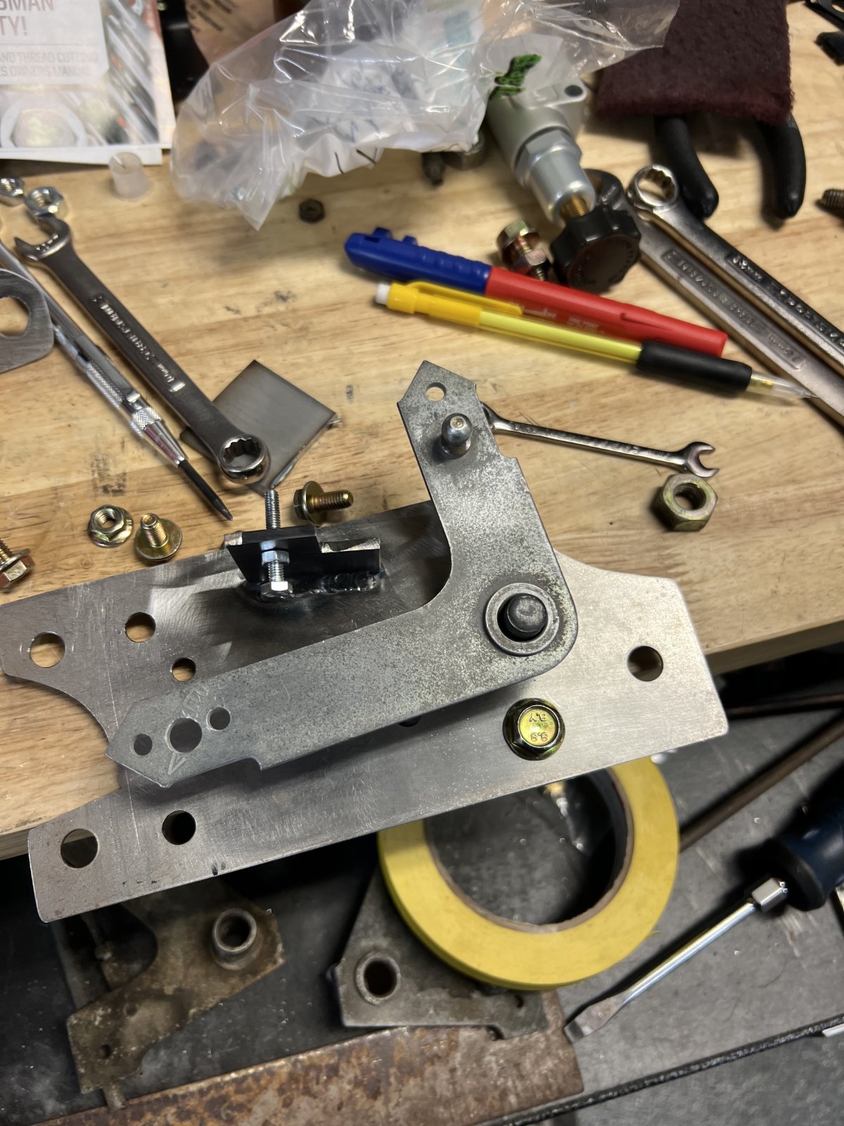

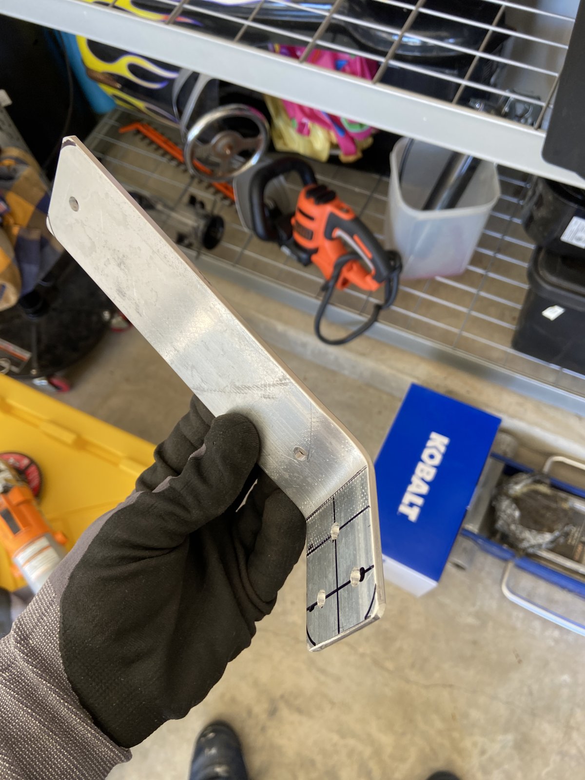

I modified part of the bracket that would typically mount the plenum to mount the intake air temp sensor.

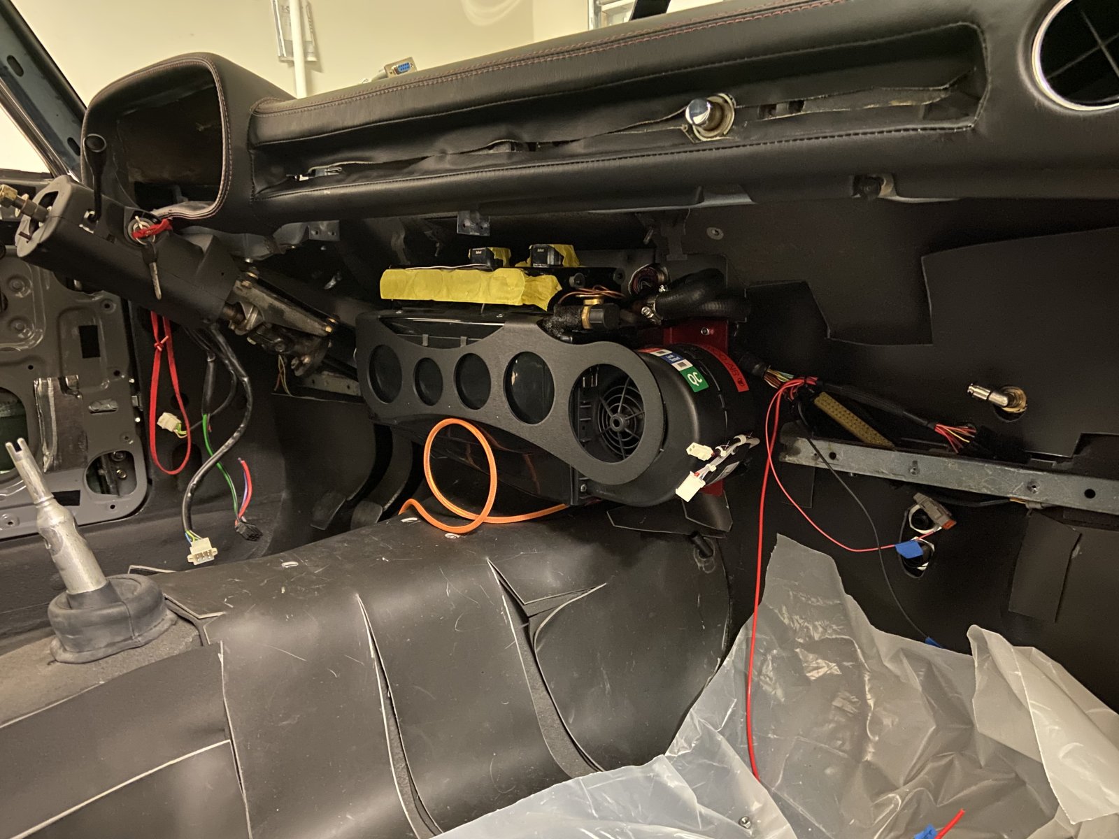

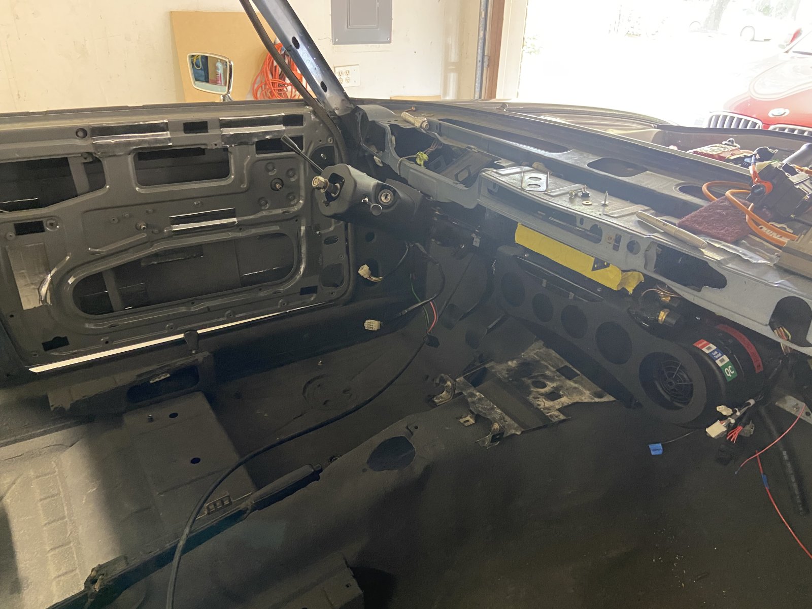

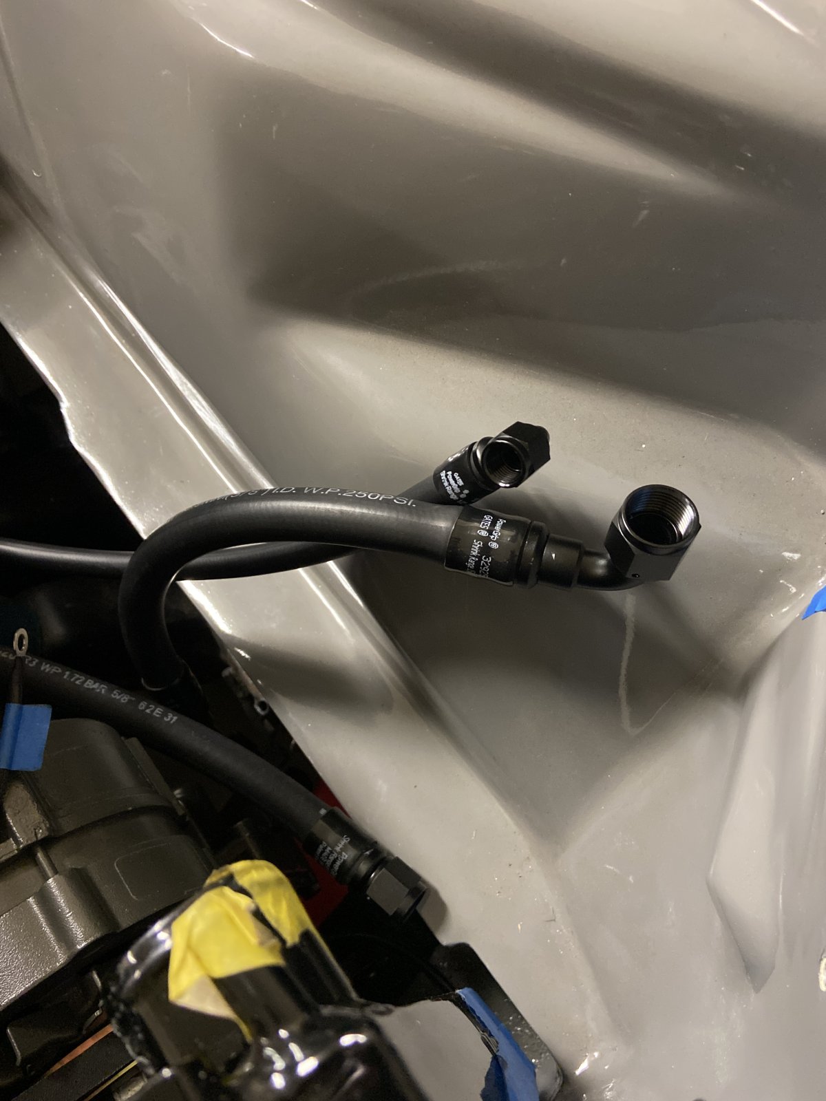

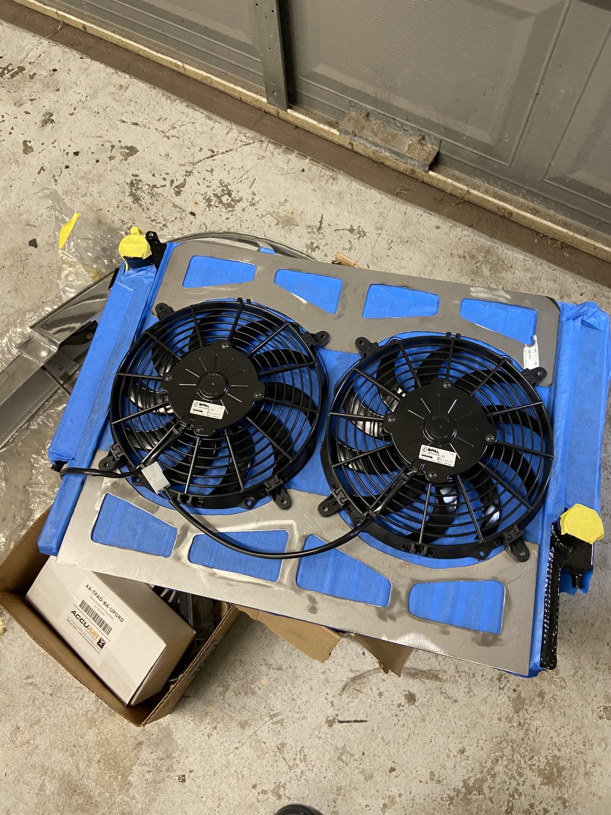

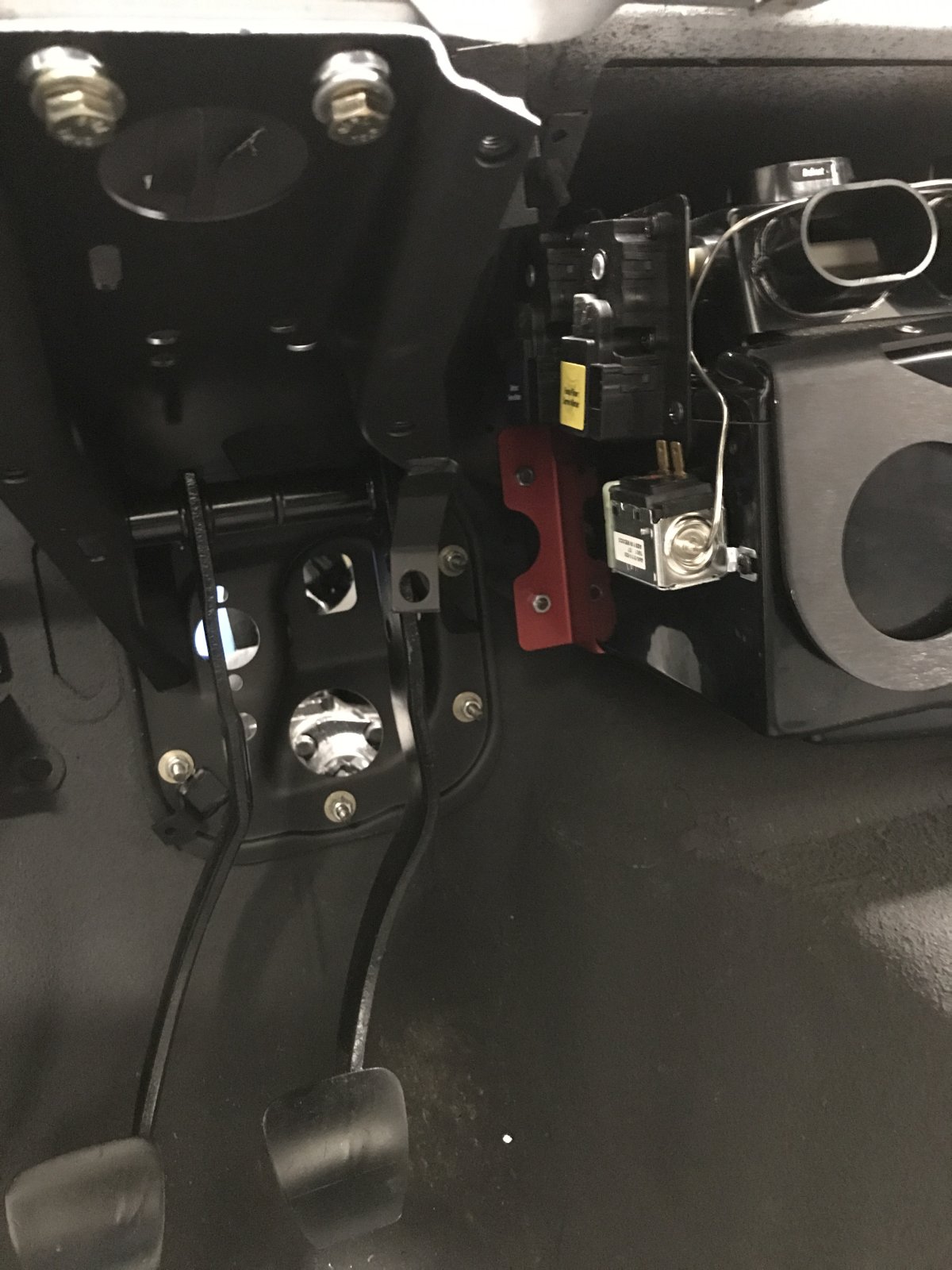

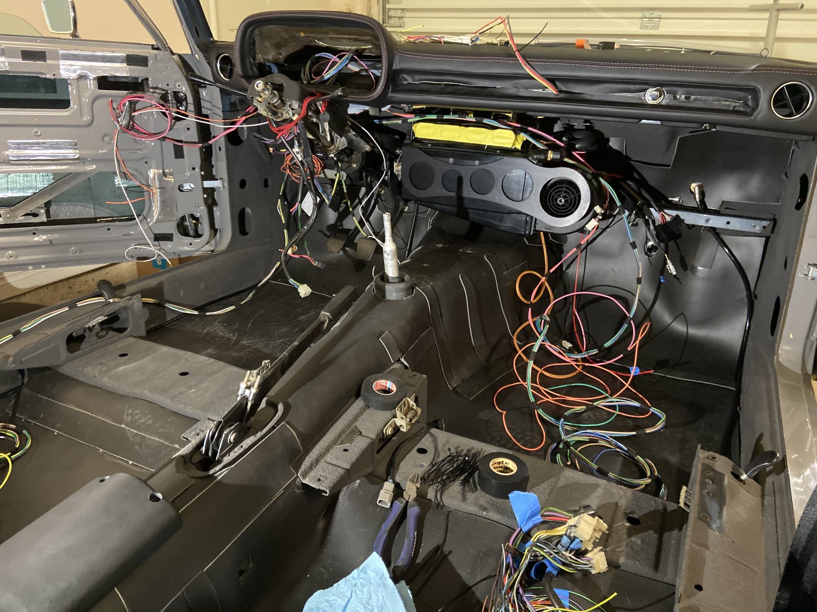

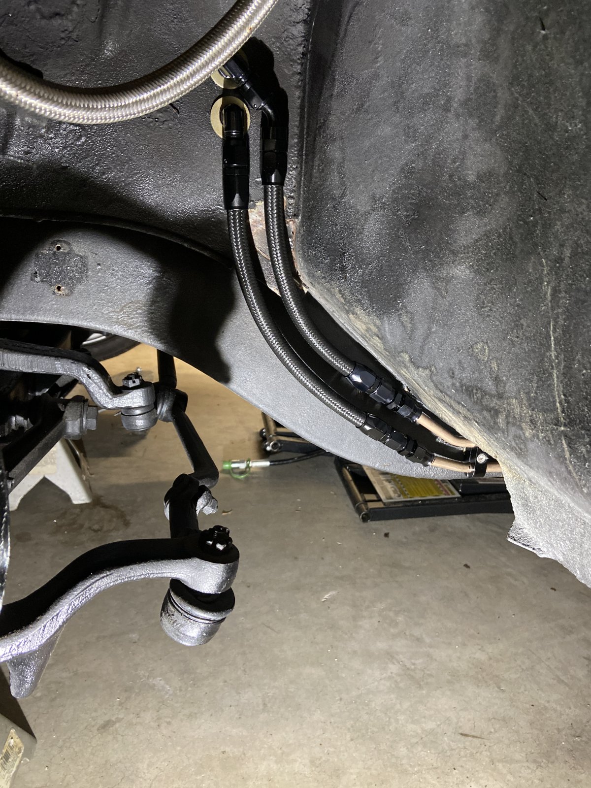

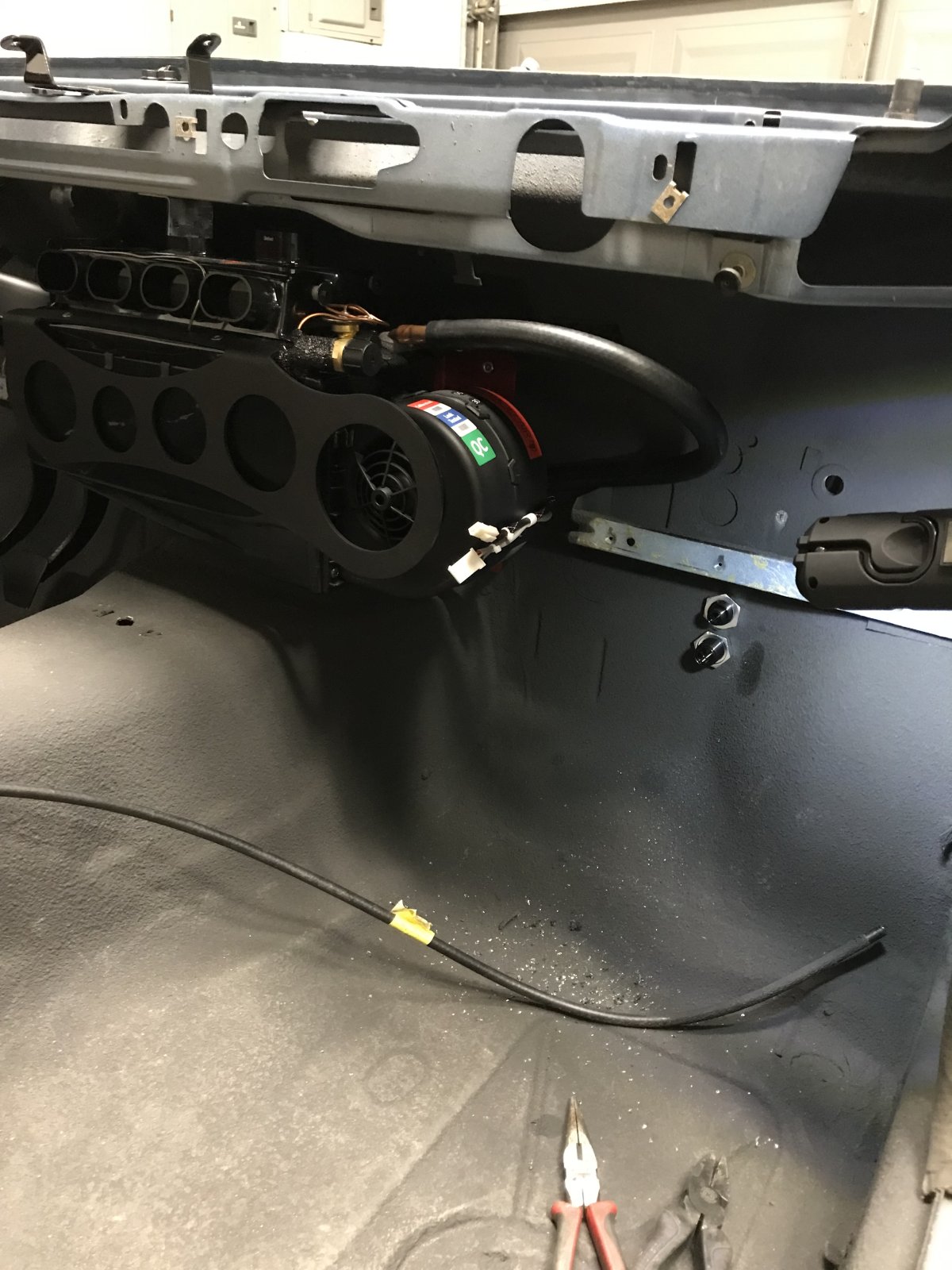

AC system... I have a Resotmod Air blower/evaporator/controls in the inside, a SPAL pusher fan in front, and an Amazon sourced condenser. The lines were all custom bent Restomod Air and Vintage Air. I also used their end fittings... you cut the hose to length and push them on the fitting, ship the lines to them, and they'll crimp them. For the harder to reach areas, I bent Vintage Air lines. Trying to keep everything out of view gets tough with these bigger hoses.
