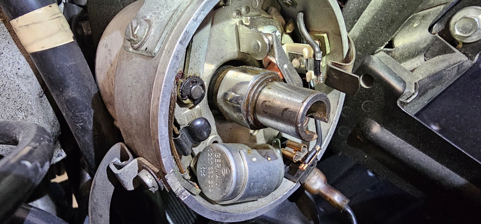

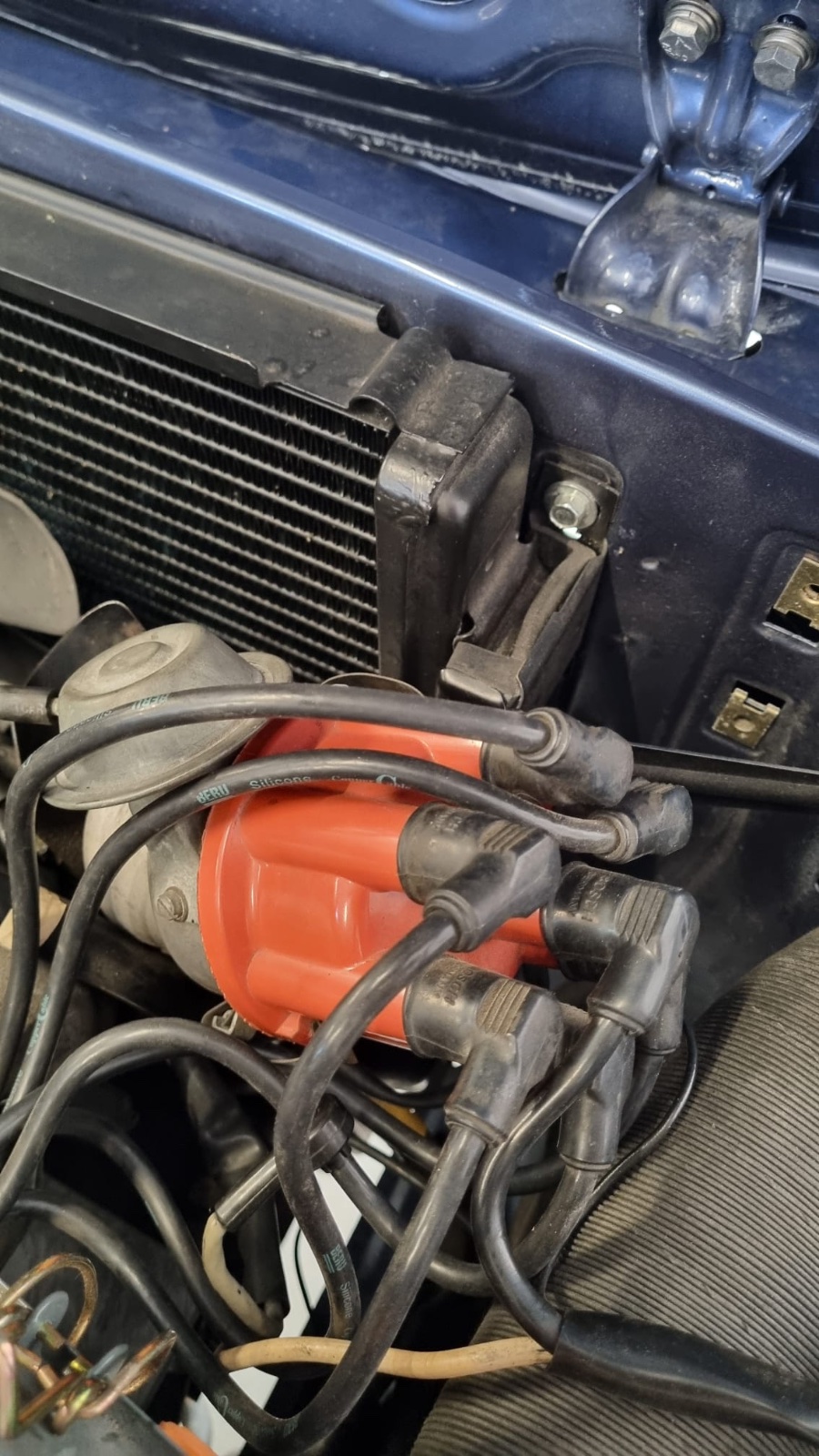

Pic of your distributor please?

My mechanic currently has the car and will go through the ignition. Therefore no current pictures. It's difficult to debug as you have to drive for a bit before the problem occurs. I will pass on every suggestion.

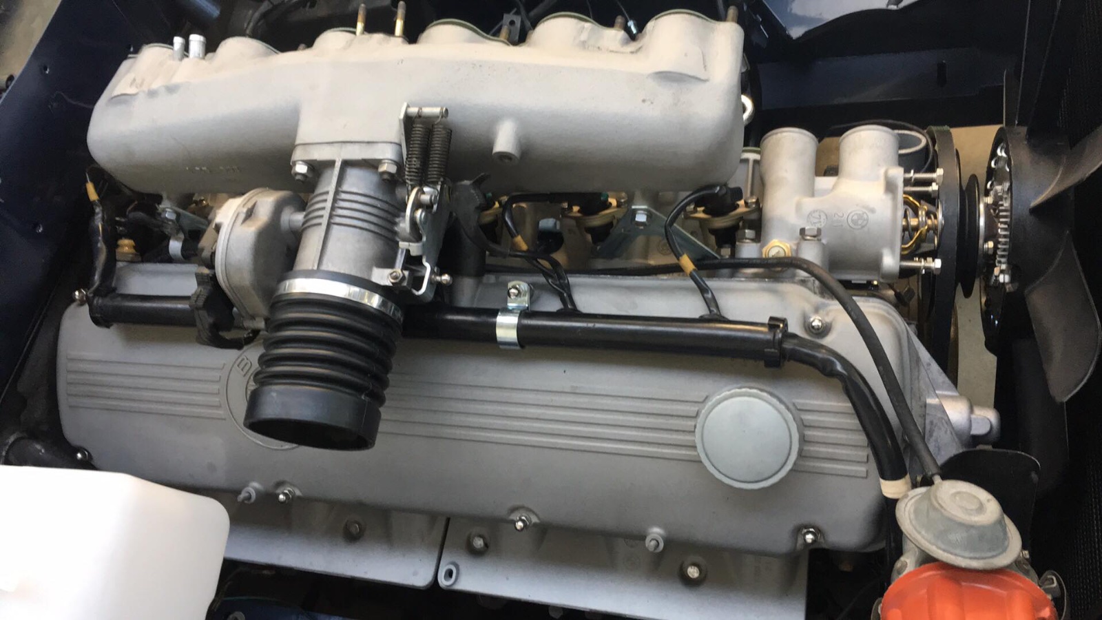

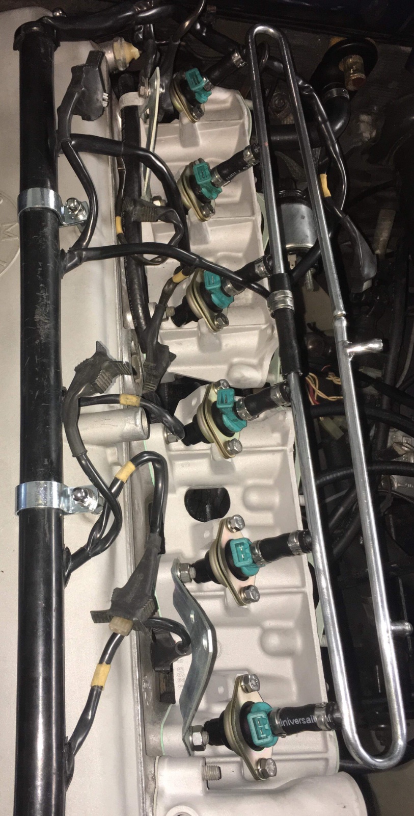

A photo from a couple of days before the problem manifested itself and some form 2018.

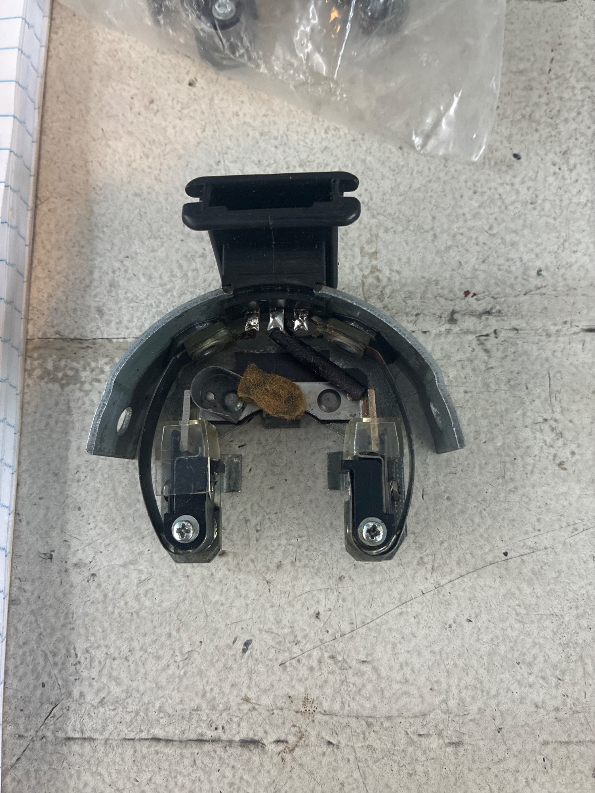

You are also looking at a typical problem that can be caused by a worn TPS -
The new ones I have made have an additional diode installed to stop the dropping out signal issue as the wiper arm moves slightly between positions.
And also a typical problem caused by worn trigger points- the ones installed in side of the distributor.
Also look at shaft play in your distributor…

Just looking at your plug wires- they should not be touching grounds as they are and they look really old?
When replaced last?

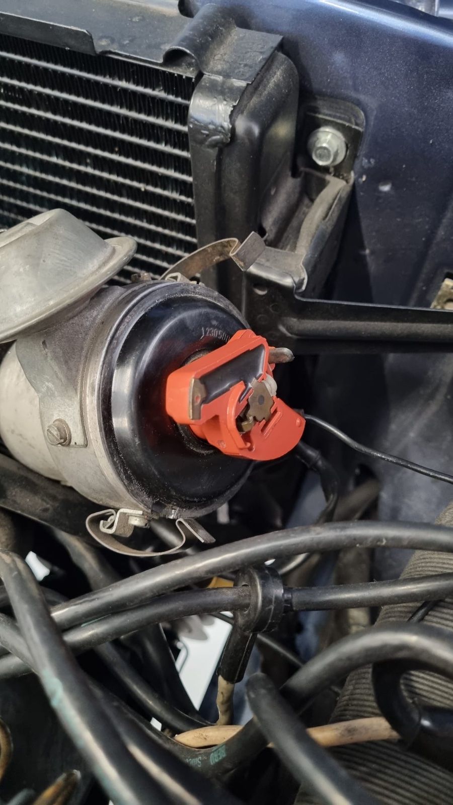

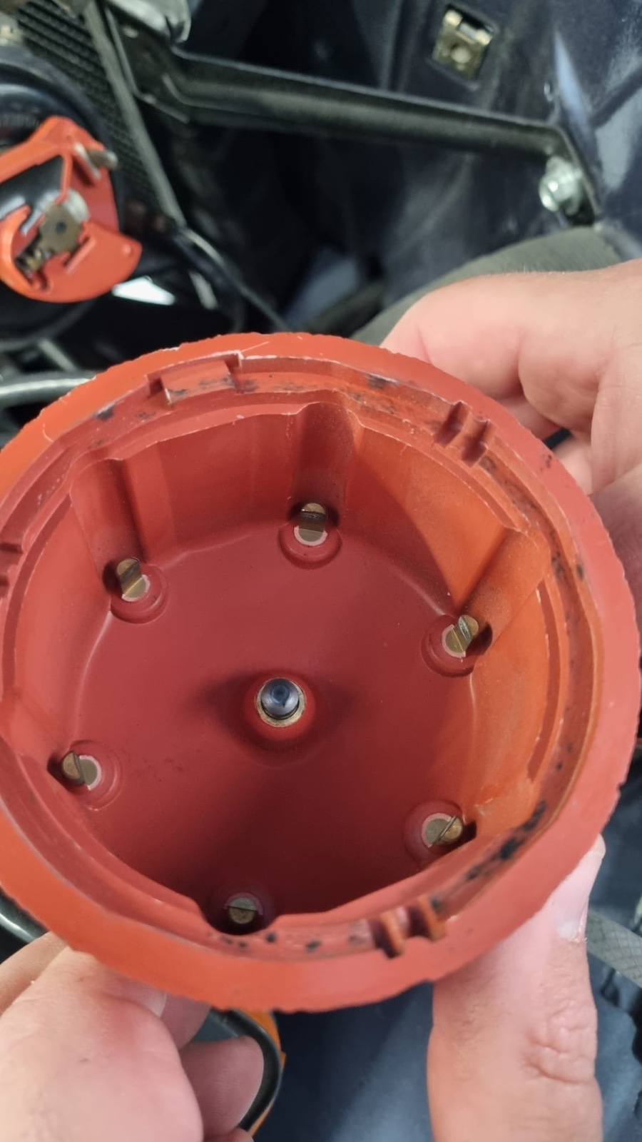

Looking into all this. The distributor is not new, but appears to be in good working order.
The diagnostic cable looks so-so. Will have to try with a plain wire.

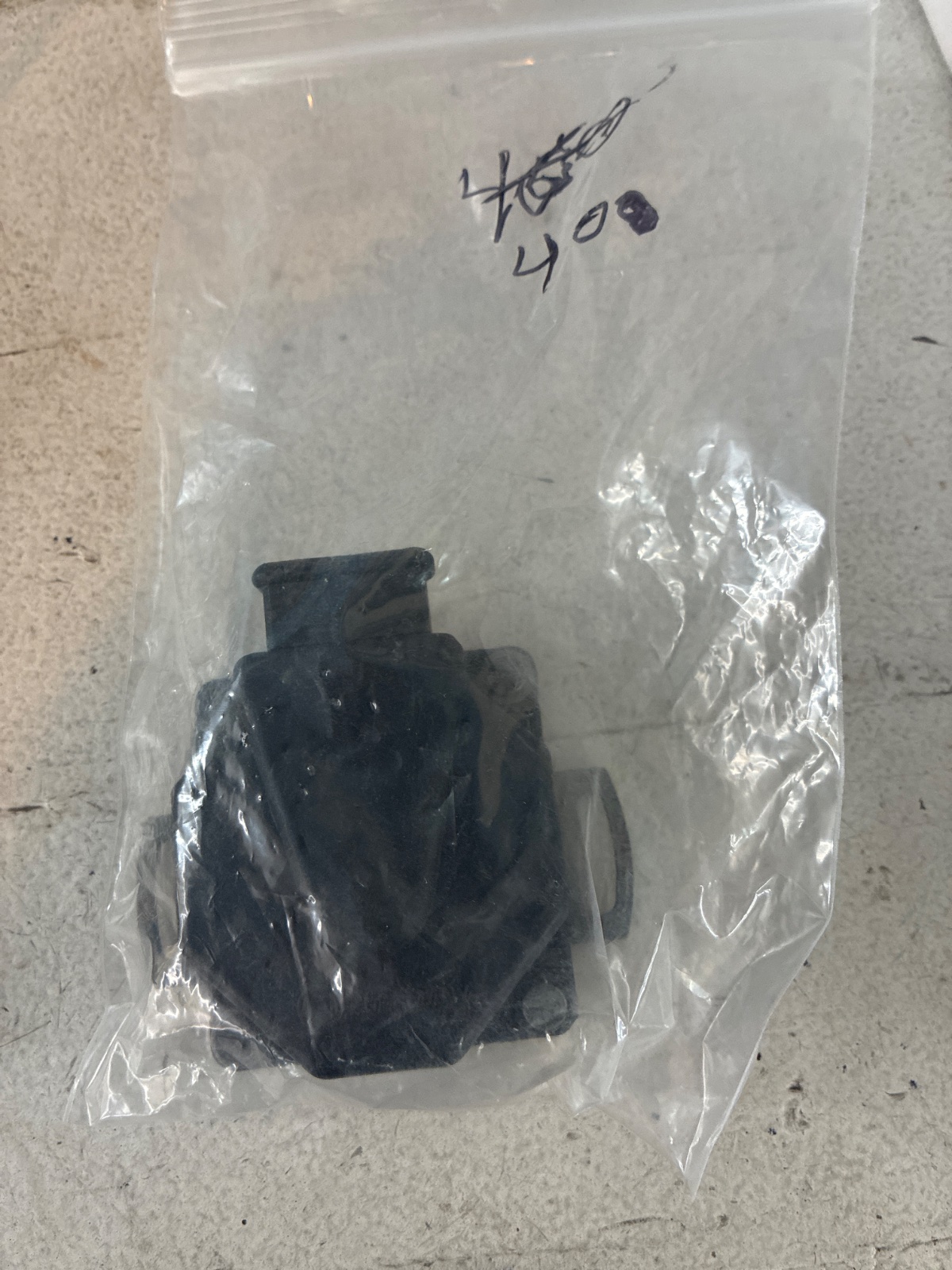

What are you asking for TPS, rebuilt distributor?
Did you remove and inspect the trigger points on the side of your distributor?
The trigger points were like new 3000km ago (when debugging what turned out to be the fuel pump/regulator issue).
How much for the TPS? If you have the price scribbled on it, I can't quite make it out. My mechanic thinks that's a possible source for the problem.

Shaft play sideways 0.11 mm and lengthwise 0.53 mm
