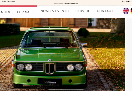

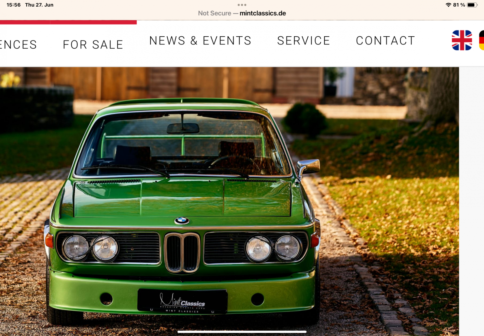

Drew, (AFIK) the 4 slat grill is only for the face lift E3’s/ 1974/75 and never for any of the E9’s.
All E9’s with 5 slat kidneys. All silver up to face lift, after which the 5 slats were black anodized
All CSLs, regardless of model or year had 5 black anodized grills.
The misconception probably sneaked in due to lack of availability and the price difference between the two types. The E3/ 4 slat grill looks similar enough, fits somewhat ok, costs a third and are easily available.
Even this currently for sale 600K Euro Batmobile has the wrong E3 grill. That’s how far the misconception has spread.

Thanks for the clarification, Keshav. I have seen numerous E9's with the 4 slat kidneys on BaT,and even a few CSL's with the black 4 slat grills for sale or up for auction.

Very true…sadly so since the grill is the about the first point of recognition of the car! It’s about the level of commitment
