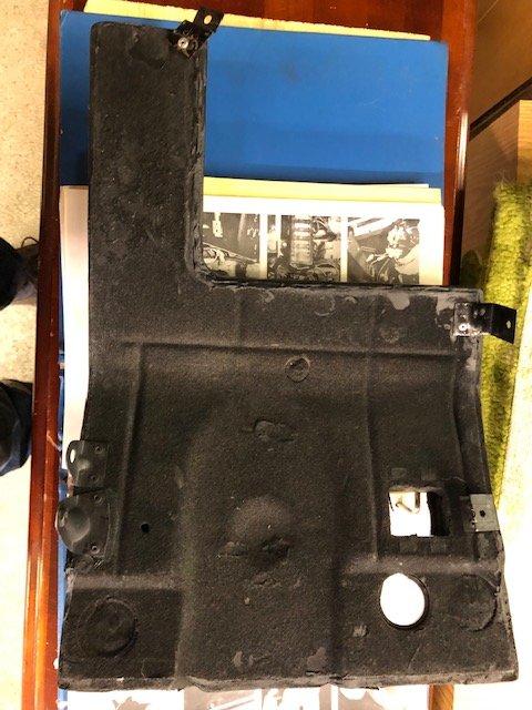

Need some advice on the steering column trim piece. It's been a number of years since this was removed I don't see the points to attach the brackets as shown on the included PDF can anyone advise?

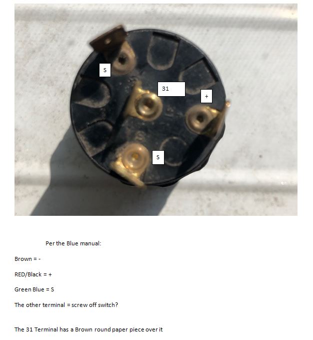

Also the rear window heater switch has four terminals I see three wires in a bundle that match the colors in the manual but the switch does not match the designations as shown on the included PDF. The fourth terminal I don't know what wire goes to which terminal. I have one lone wire without a home it is a Brown and green stripe wire is this also used on the switch?
I can see that all four terminals had wires attached. The middle terminal which looks like it has a "31"designate has a brown round paper over the terminal (missing on the photo)

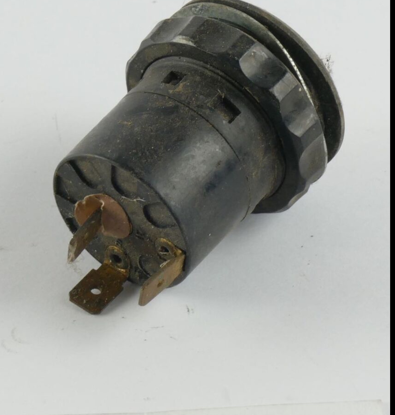

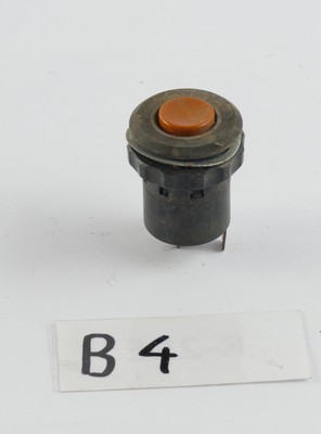

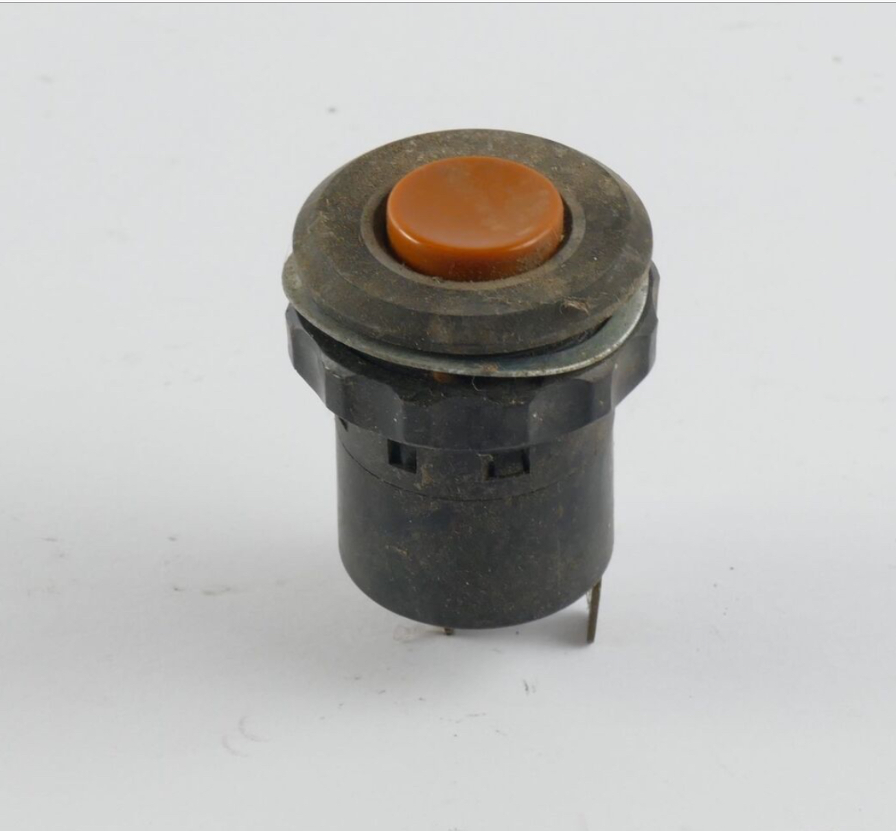

Maybe you need the 3 terminal type?
NMNA! Here’s the eBay advert in case, but you should be able to find one locally if that’s the solution. The seller mails international and claims part is in working order

THE STEERING COLUMN PIECE
should have two holes at the top and go into to sht metal clips at the bottom front of the dash
if you dont havethe holes you could screw in two little plates for the top and to the dash
the fourth center is power from the switch wire to lite the buttom typ on all switches
i just slpiced from that wire to the center so when its on the buttom lites up
