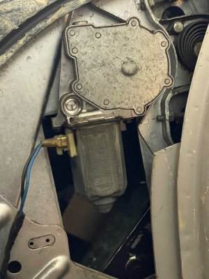

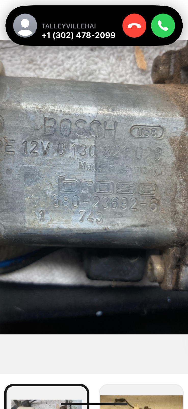

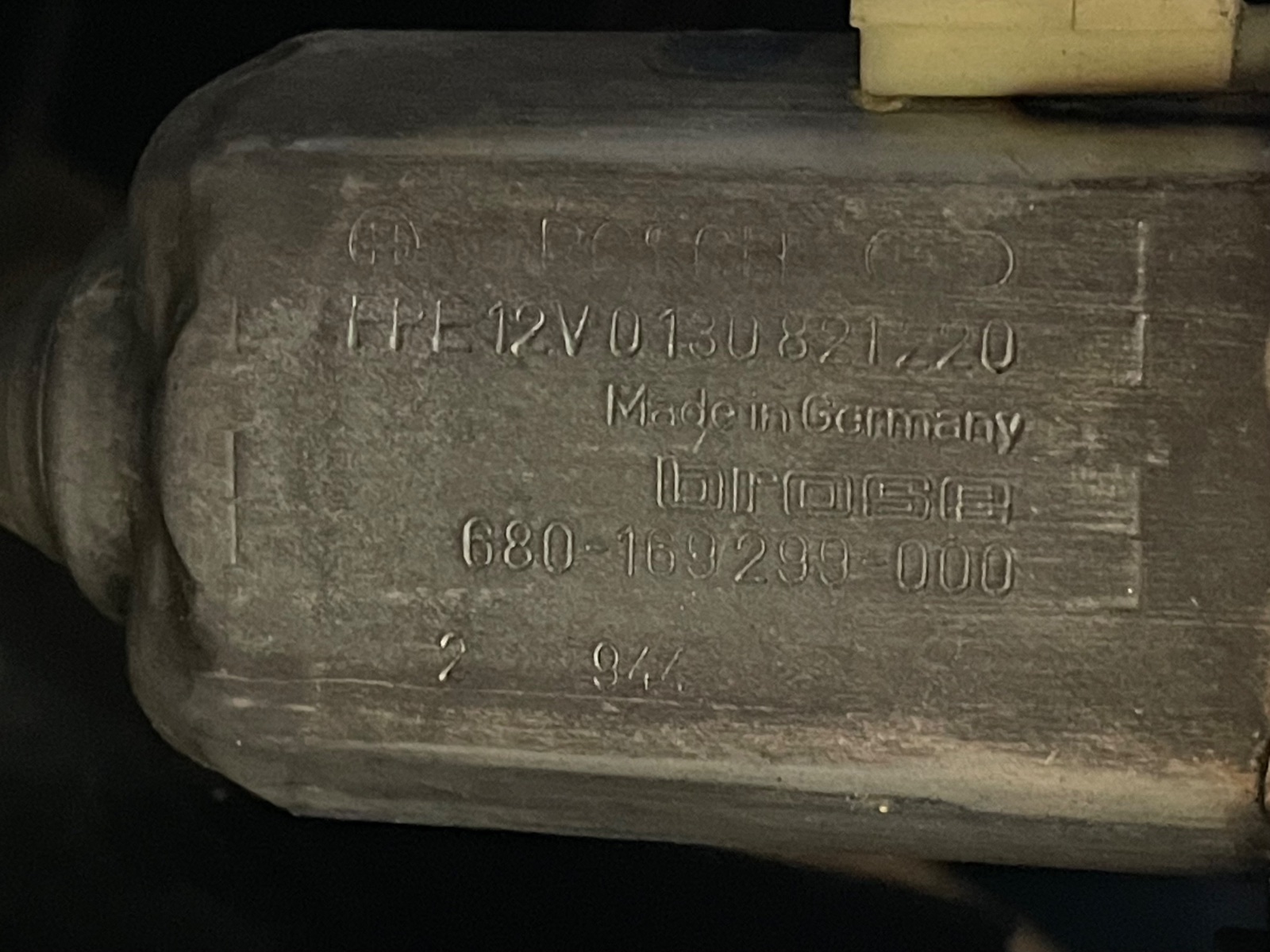

I finally took off the rear side panel to address my very slow windows. The pictures attached are what I found. I expected sardine can motors but these look like E28 motors. Was there a transition year in 73 to newer and better/faster motors? The car is remarkably original and untouched. I will remove the regulators and clean and grease them but had been hunting for E28 motors that perhaps I don't need? These are 2 wire motors.

Feb/Mar of 73 the improved motors were introduced (along with circuit breakers under the dash) and they have a black plastic cover, same shape as e28 though and both have only two wires.

I think 73 and e28 motors are pretty comparable. What makes a huge difference is removing the rear front window door rail, there are four steel wheels with ball bearings in them. Remove and soak in gasoline, makes a big difference. Everyone just greases the rails and adding more grease on top of petrified grease makes it worse.

Just finished mine this past weekend. My motors were the same as yours, and the upgraded ones are 2x faster. The tutorials on this site were excellent, and aligning the windows was less of a drama than others experienced. Only snag I ran into with the E28 motors was to shim the motor mounts to add clearance between the motor and the regulator arm. I also ground and polished the motor cases where the regulator arm was catching.
