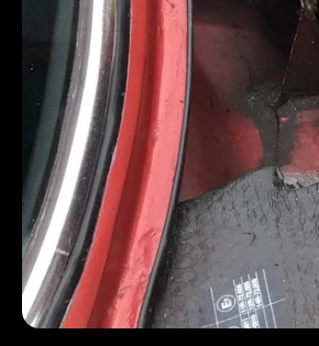

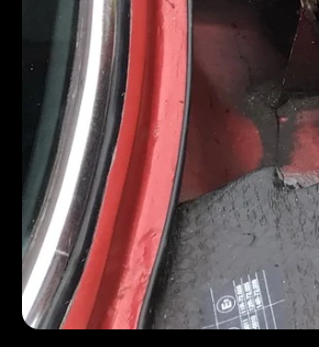

I'd be interested to know what causes the surface of the rain gutter in front of the right front window corner to look no-flat; it seems like there is bubbling unerneath the red paint?
