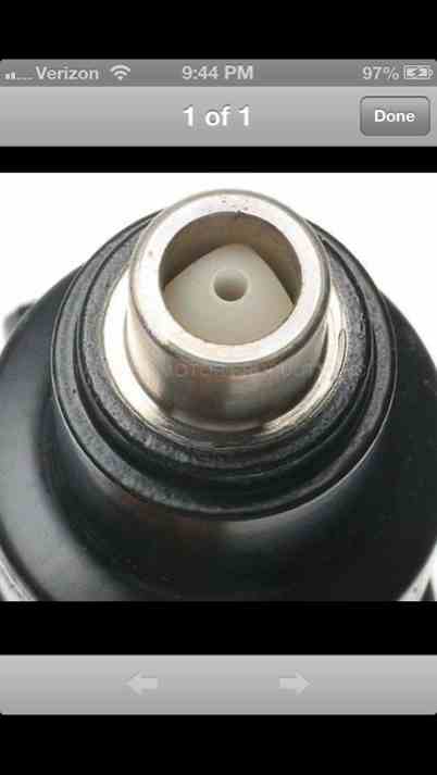

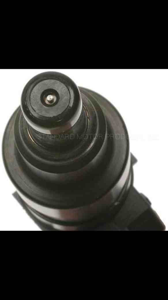

Last update the AAV wasn't functioning, that I believe is satisfied. I decided to use injectors that haven't been fired in 30 yrs almost. I power tested them on a bench, they all pulsed, so I gave it a shot. Two injectors didnt spray fuel. I decided to purchase rebuilt injectors on eBay and replace all 6. Here is what I got
5 that look like this
And one that looks like this
They were listed as standard fj709 as I believe the car calls for.
Should I be concerned about the difference ?
I have seen both styles in other photos. Ideally I'd prefer them to be identical ,

It's running on 4 cylinders. But I haven't put the new injectors in yet. Don, are you familiar with both style injectors? Fred
Disconnect those ASAP and just get the right ones.
You can read the number on the old ones and call Robert White jr at FI corp for the ones you need.
Just re-read your post- looks like I missed your point.
Will the odd one even fit?
You need to tell seller you want matched set.
What number is on the old injectors and new injector and the odd one?
What resistance in ohms ?
