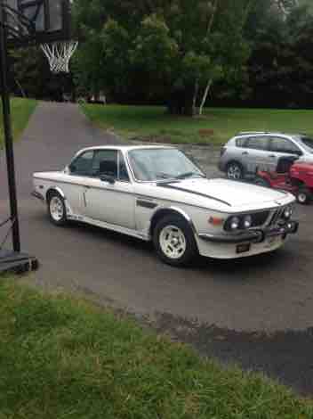

Well my car is still running poorly. I have only been sinking a few hours a week into it. Winter is coming, and I'm going to store it for a three months. If you all remember, I removed my original 3.0 csi motor because it was stuck from sitting many years. Once removed it freed right up with the head off. It revealed a healthy looking engine with high compression piano top Pistons believed to be rebuilt in Germany circa 1980s. Not sure if those Pistons are original to the car? Anyhow I put in a 1977 3.0 sedan engine in an attempt to drive the car and sort out the electronics and so forth prior to beginning any type of dismantle/resto. I would at least like to start with a functional car so when it goes back together there are less mysteries.
