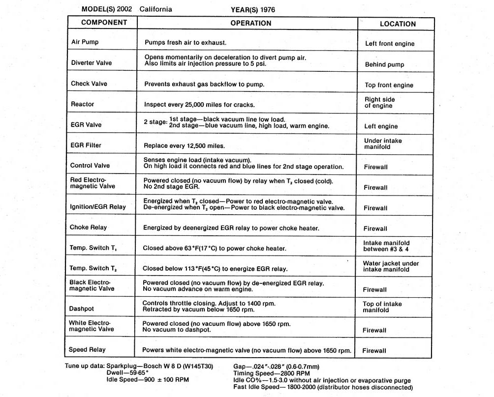

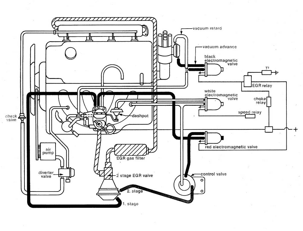

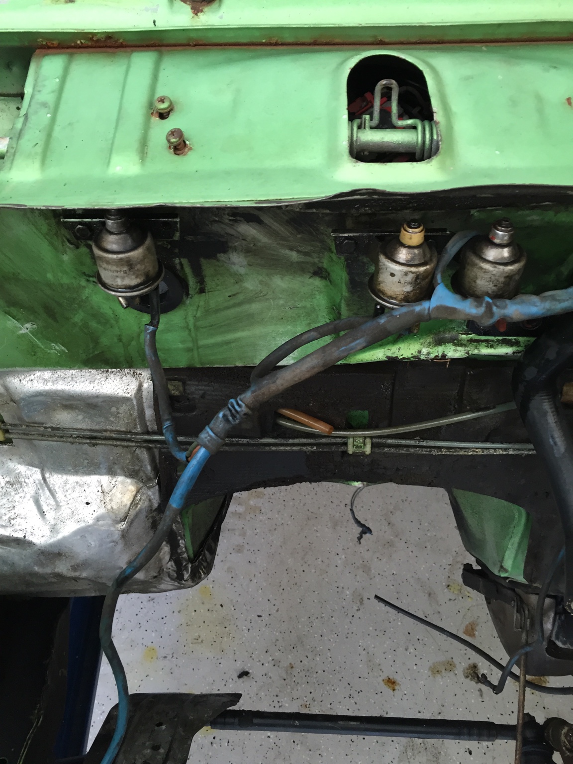

Here's a few engine compartment shots of my '76. For the most part, all of the emission equipment is there, including the thermal reactors, solenoids, egr, etc. If much of this stuff is missing on that car it can be a REAL challenge to get it right.
Even if the equipment is intact and working, many of the Smog examiners are clueless regarding basic visual inspections. Many were born well after the age of ignition points and leaded fuels. I recall an ugly argument many years ago regarding the apparent lack of an 02 sensor and catalytic converter on a '73csi. On another car, with original Zenith carbs, an examiner determined the vehicle failed the visual inspection because metal "CARB tags," similar to the one in your picture, were missing.
