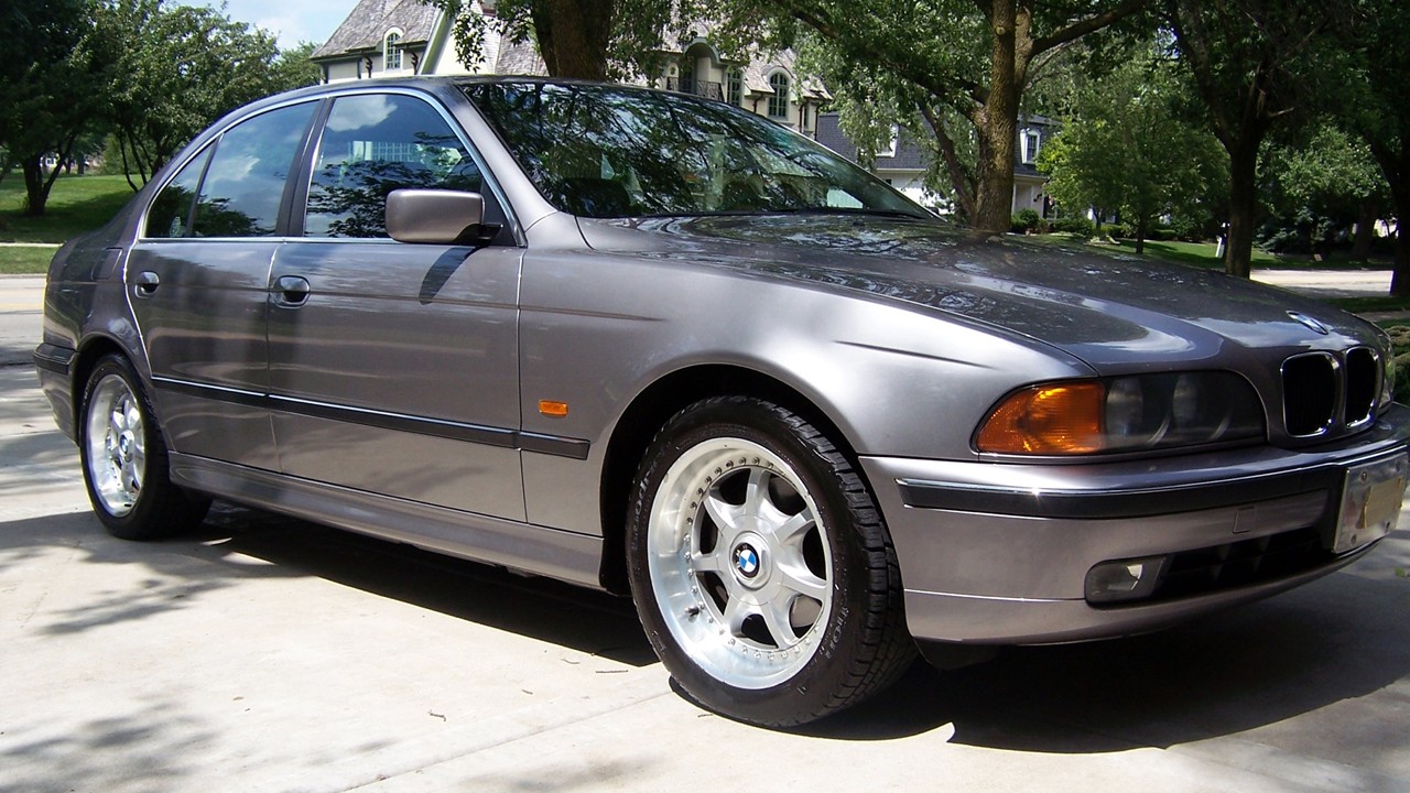

My 97 E39
X3 on cooling system. Water pumps had plastic impellers, plastic thermostat housing, plastic expansion tank, plastic radiators etc. all items should be replaced as regular maintenance. Disa valve and the PVC breather are also items to consider replacing if they haven’t been. Also check the the blower fan is operation. Blower motor resistors are known to fail causing blower to be non op.
Still, E39s are great cars.
