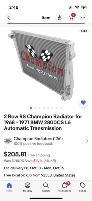

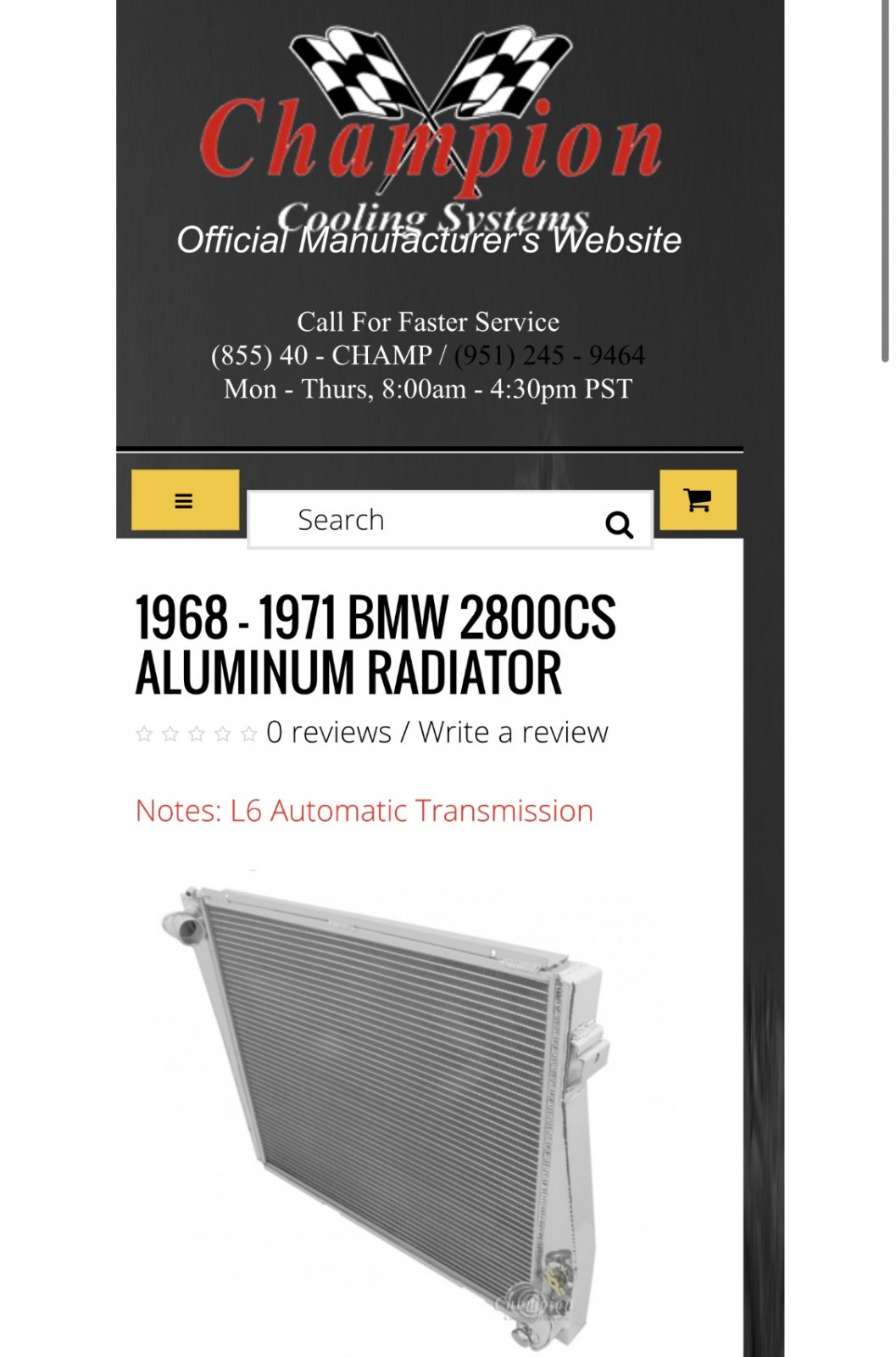

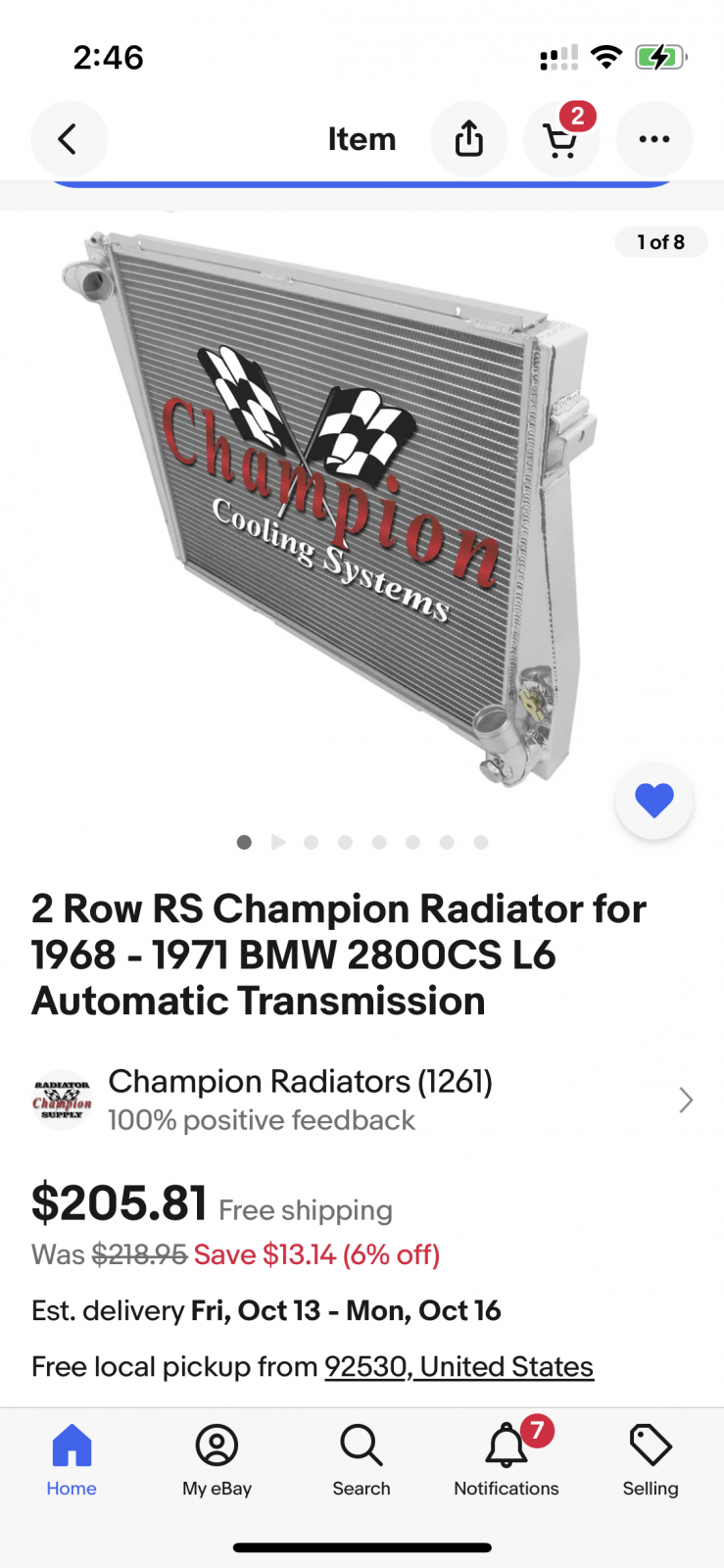

eBay has a Champion Aluminum Radiator for $206 with shipping (pretty hard to beat).

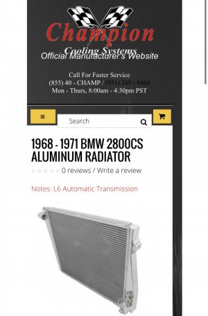

Only odd thing is that they say “Notes: L6 Automatic Transmission” and doesn’t list any other parts for manual.
See link below: https://shop.championcooling.com/Pe...800CS/1968-1969-1970-1971-BMW-2800CS-SKU-6974
?Will this fit my car even though it says automatic and mine is a manual? Looks like it could. Anyone bought one before?

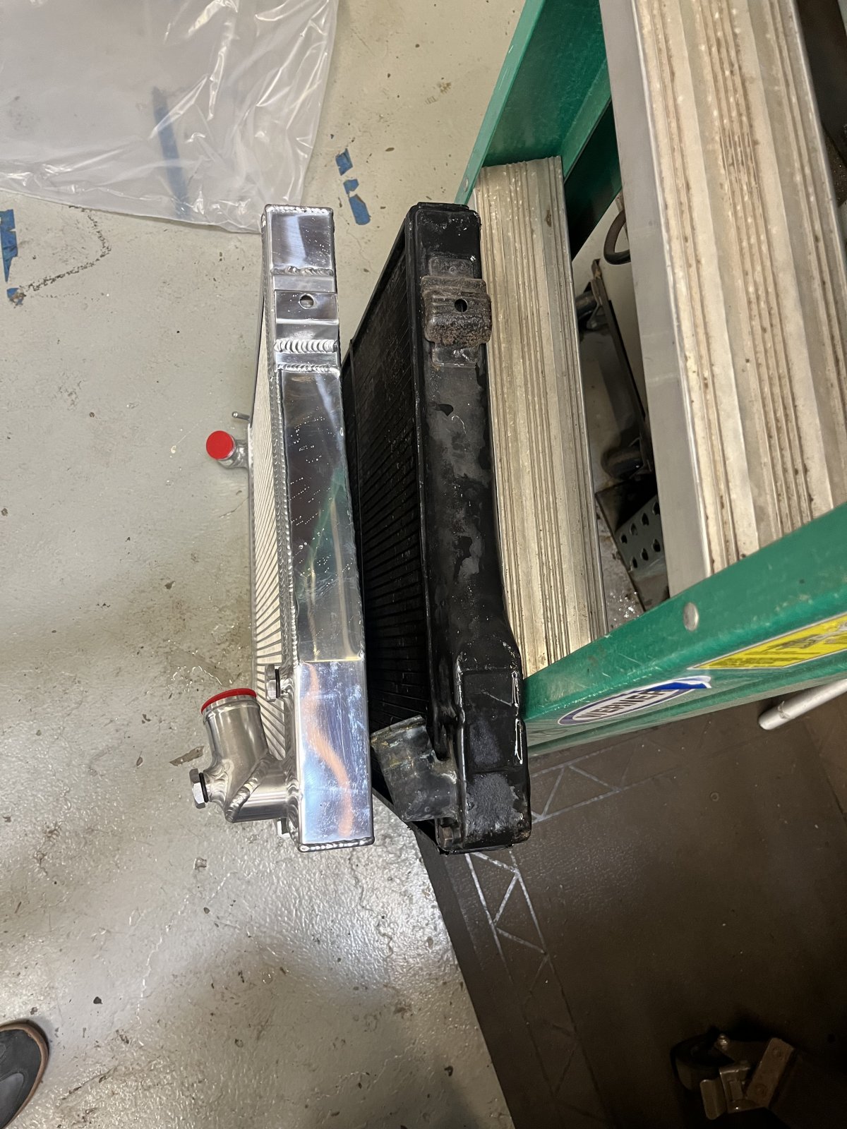

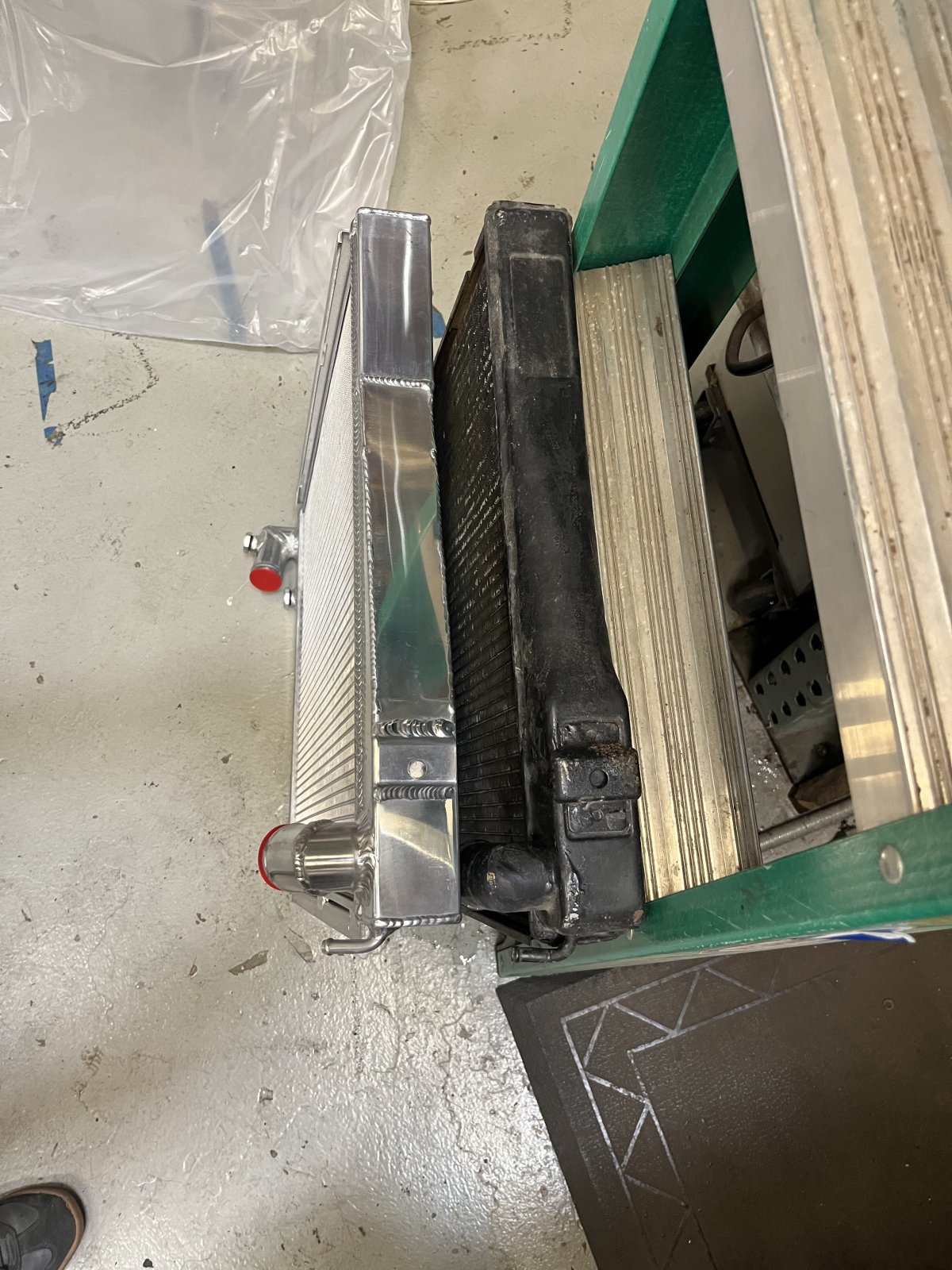

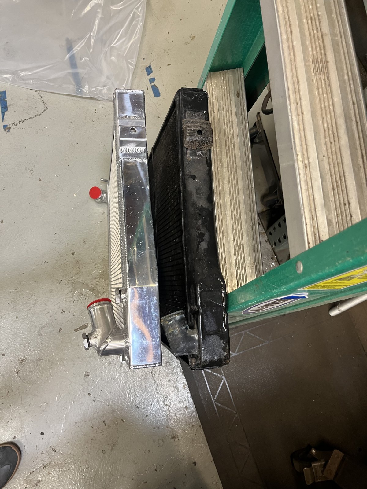

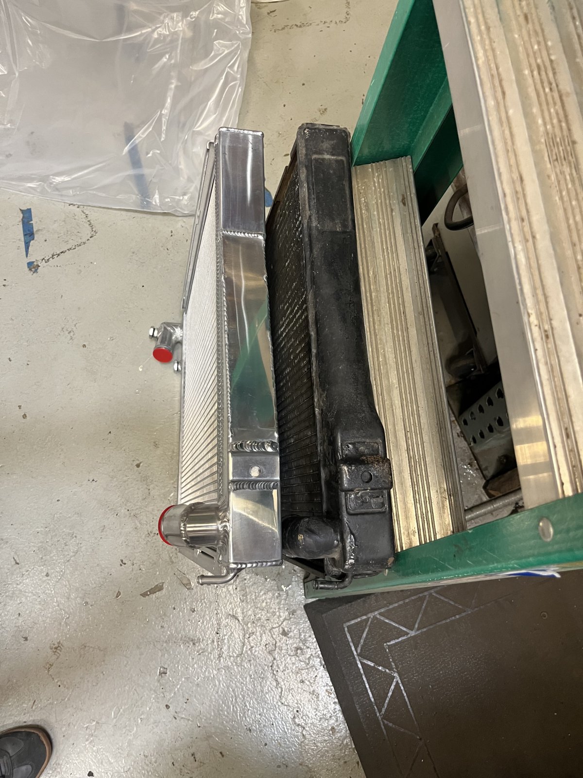

Both radiators fit but the bracket on an auto rad is shorter as the rad is wider for the trans cooling on the passenger side. Pic shows a manual radiator btw.

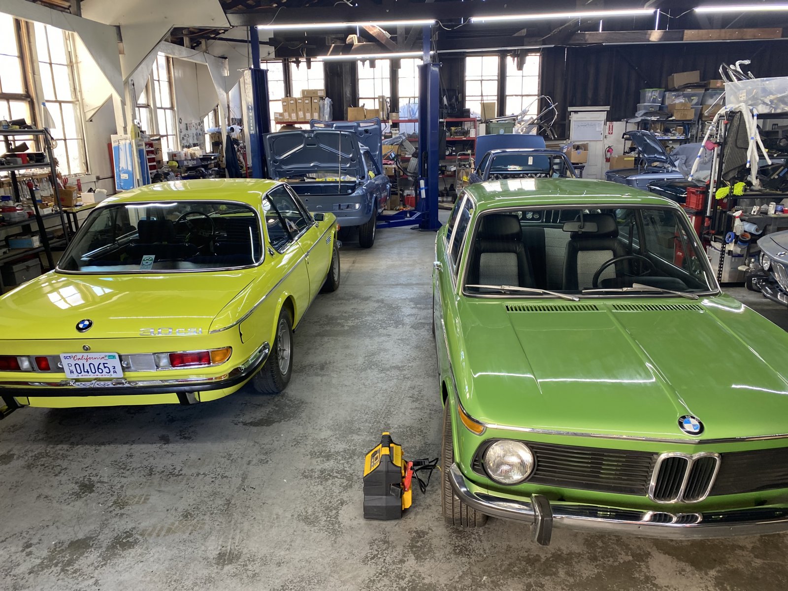

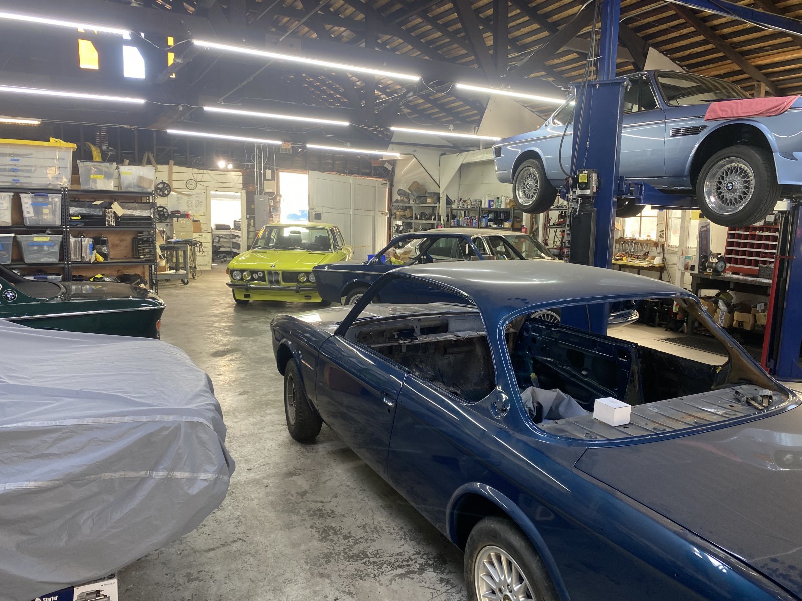

Visited SFDon at his shop and was very impressed by him and his team. Never seen so many CS’s in my life. Very clean work and many b35 swaps.

$220 on eBay including tax and freight does gets you a Champion aluminum radiator that came in 2 days. (I can re-core the original later if I want) . The Champion is actually better than the eBay photos and has 2 thermostat plugs (one which looks to be the drain). I did have to slightly bend the bottom 2 metal supports more open since the aluminum radiator is a bit thicker than the original and with the bottom oem rubber pads it didn’t quite fit. (Could have also trimmed rubber).
