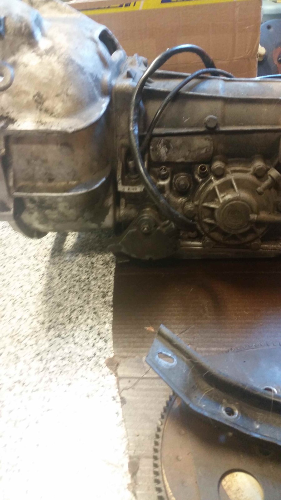

I am pretty sure I pulled a ZF 3HP20 from my car, but would like to be sure I am offering you the right part. Here is a picture of my transmission. Compare the ribbing on the top, which should also be present on your transmission and which is not present on the BW65 and also the location of the electrical switch that illuminates the gear that is selected. On my transmission, it was located toward the front of the transmission just aft of the bell housing; on the BW it is located toward the rear of the transmission.

I am pretty sure I pulled a ZF 3HP20 from my car, but would like to be sure I am offering you the right part. Here is a picture of my transmission. Compare the ribbing on the top, which should also be present on your transmission and which is not present on the BW65 and also the location of the electrical switch that illuminates the gear that is selected. On my transmission, it was located toward the front of the transmission just aft of the bell housing; on the BW it is located toward the rear of the transmission. View attachment 75203
Can I get a picture of the dip stick and tube. I measure my tube and its 17 inches if that helps?
Sorry Bob to get your hopes up, but Chris' picture confirms that my transmission was not a ZF but was instead a BW65. My part won't fit your car.
