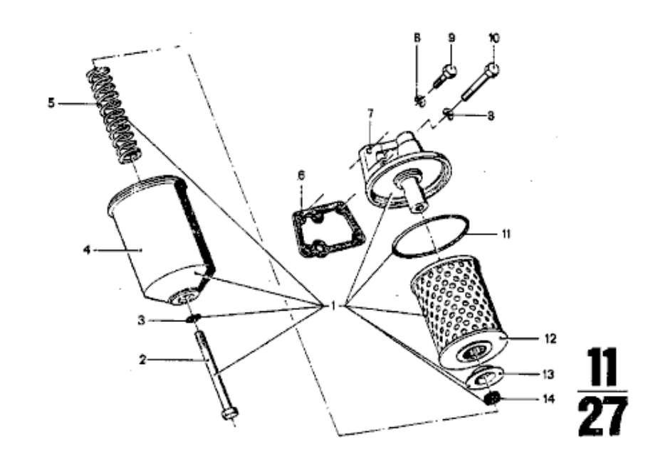

If your filter can has the bolt on the bottom the filter is the fat one and you Must use the spring! I think OX-51 is the top bolt canister and is skinnier.
Yes, my canister bolts on from the bottom. So I defenetly got the wrong filter. Will call my BMW dealer on Monday and get the right parts. Could this cause the ticking noise? Too little oil pressure? The light goes out 2sec after startup.

Are you sure the OX51 is wrong? If it is the canister with the bolt on the bottom it should look like the picture per @Stevehose post with the top bolt and per the pic attached:
Item 12 OIL FILTER INSERT 11421256714 when google cross references to OX51.

As seen on the above, the correct filter depends on whether you have the original (bottom bolt) filter housing, or someone changed to the (much more convenient) top bolt filter. I retrofitted my 3.0CS with a top bolt unit from an abandoned E12 I found on the street per a little inside knowledge from a local indie.
