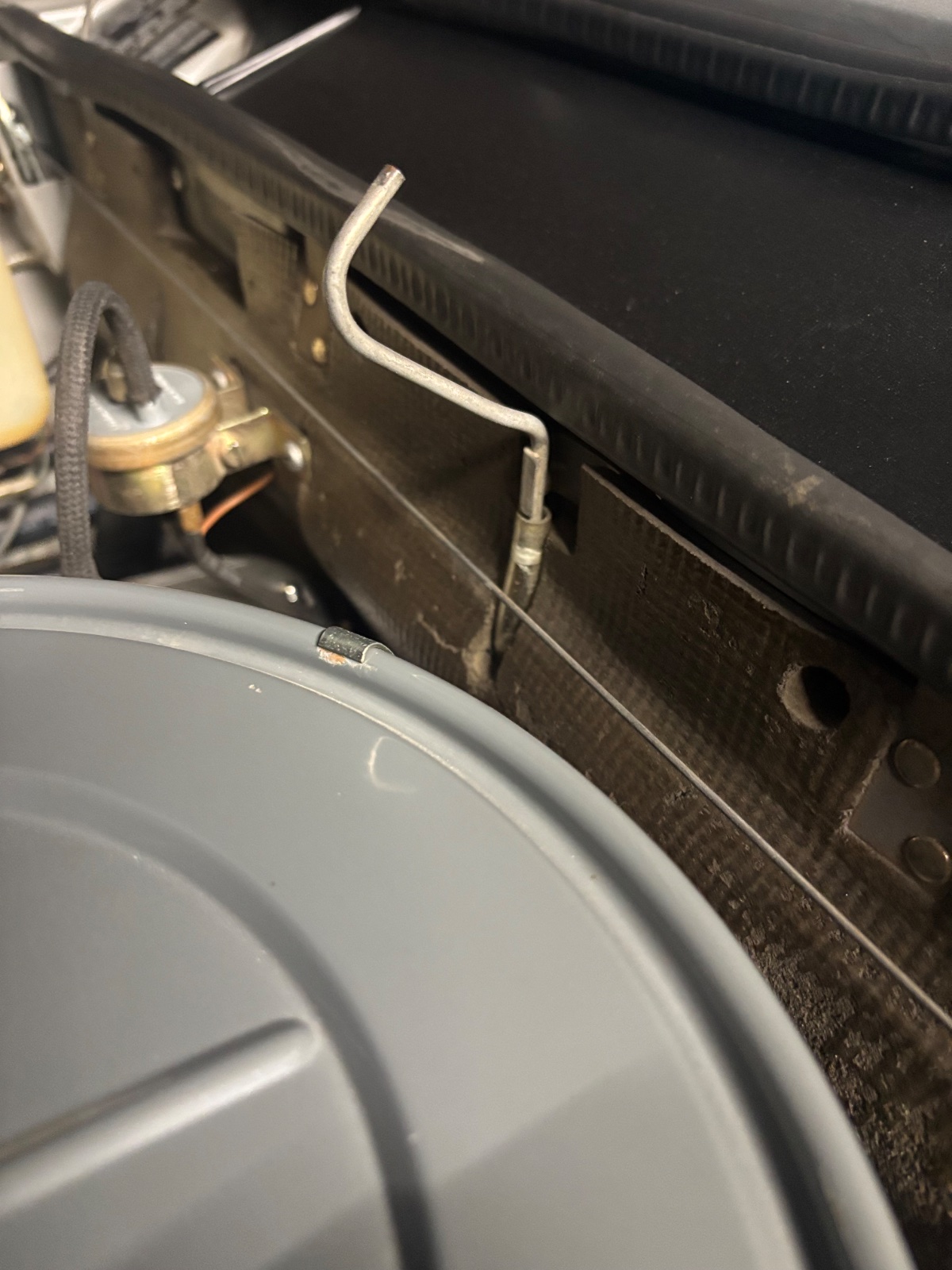

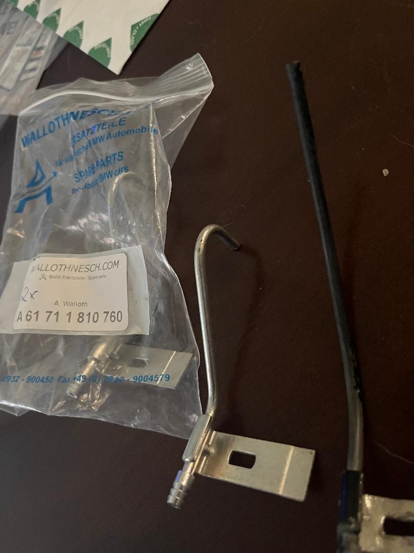

well guys, i bought a pair of new ones from W+N, part #61711810760 ... it points the wrong way. the ones on my car were painted black, so i wanted some new ones ... not gonna work. i emailed Albrecht Walloth, will update what he has to say. i bought them several years ago, so i wasn't asking for anything other than to understand how in the hell these are supposed to work. for now, i guess i will media blast the old ones and paint them silver.

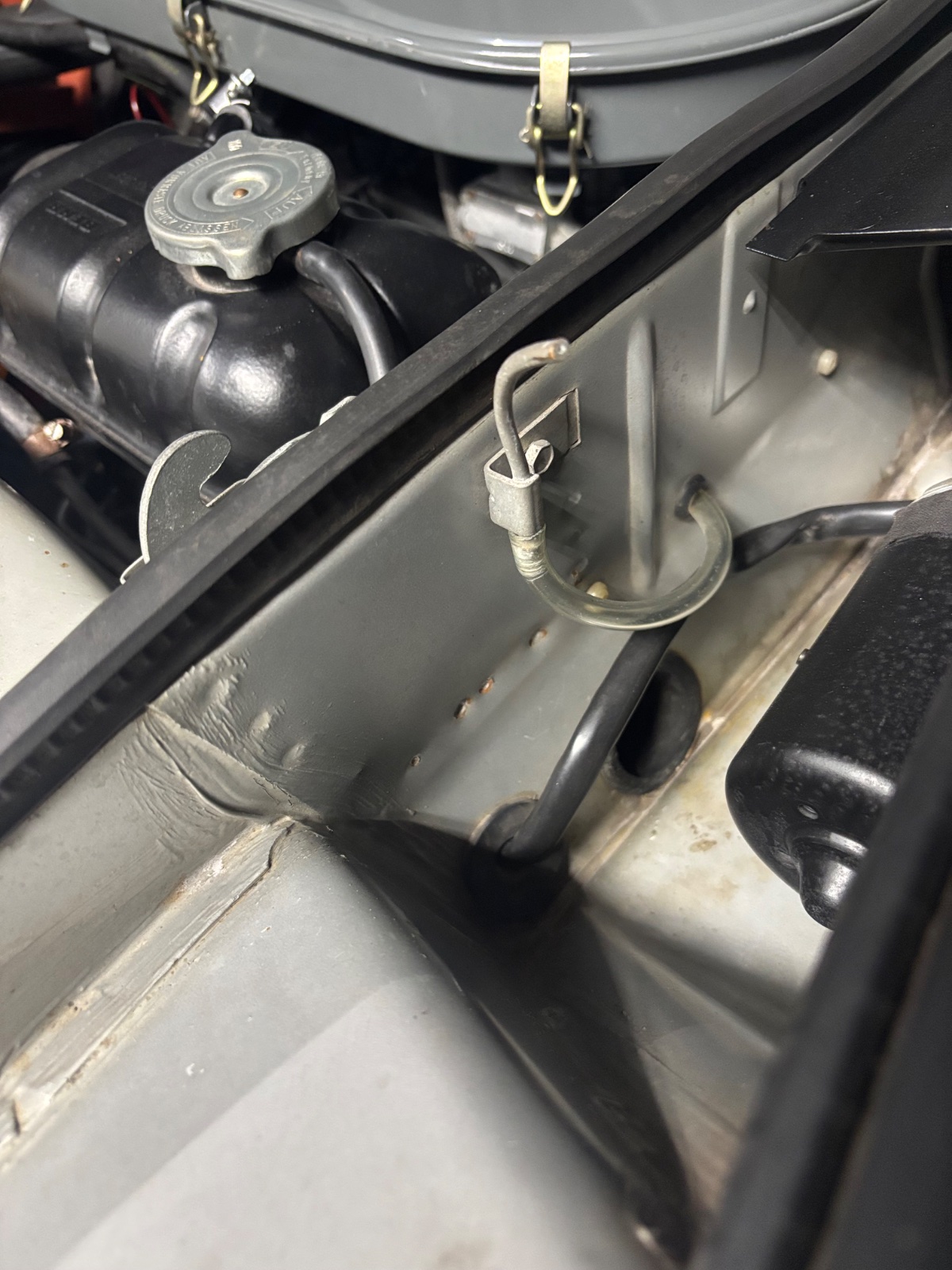

the new ones do look like the 2800 center one ... but the original ones from the 2800cs look like the side ones on your 2800. the problem with that style on the 2800cs is that if they are mounted on the engine side of the firewall it won't make it through the hood grilles as they are on the windshield side of the firewall.
