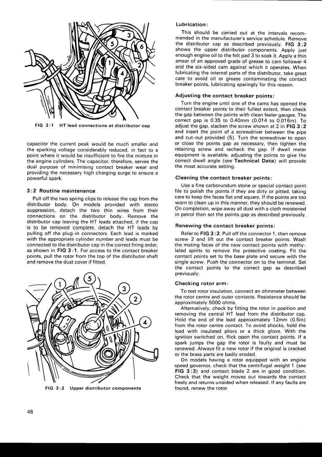

My vehicle is back firing and I believe is because I have the wrong firing sequence. I disconnected the distributor cap and the plugs to clean them so I must have put them in the wrong order. Does anyone have a diagram or a pic where I can see what goes to what? would greatly appreciate it.
