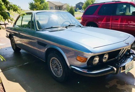

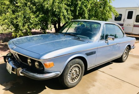

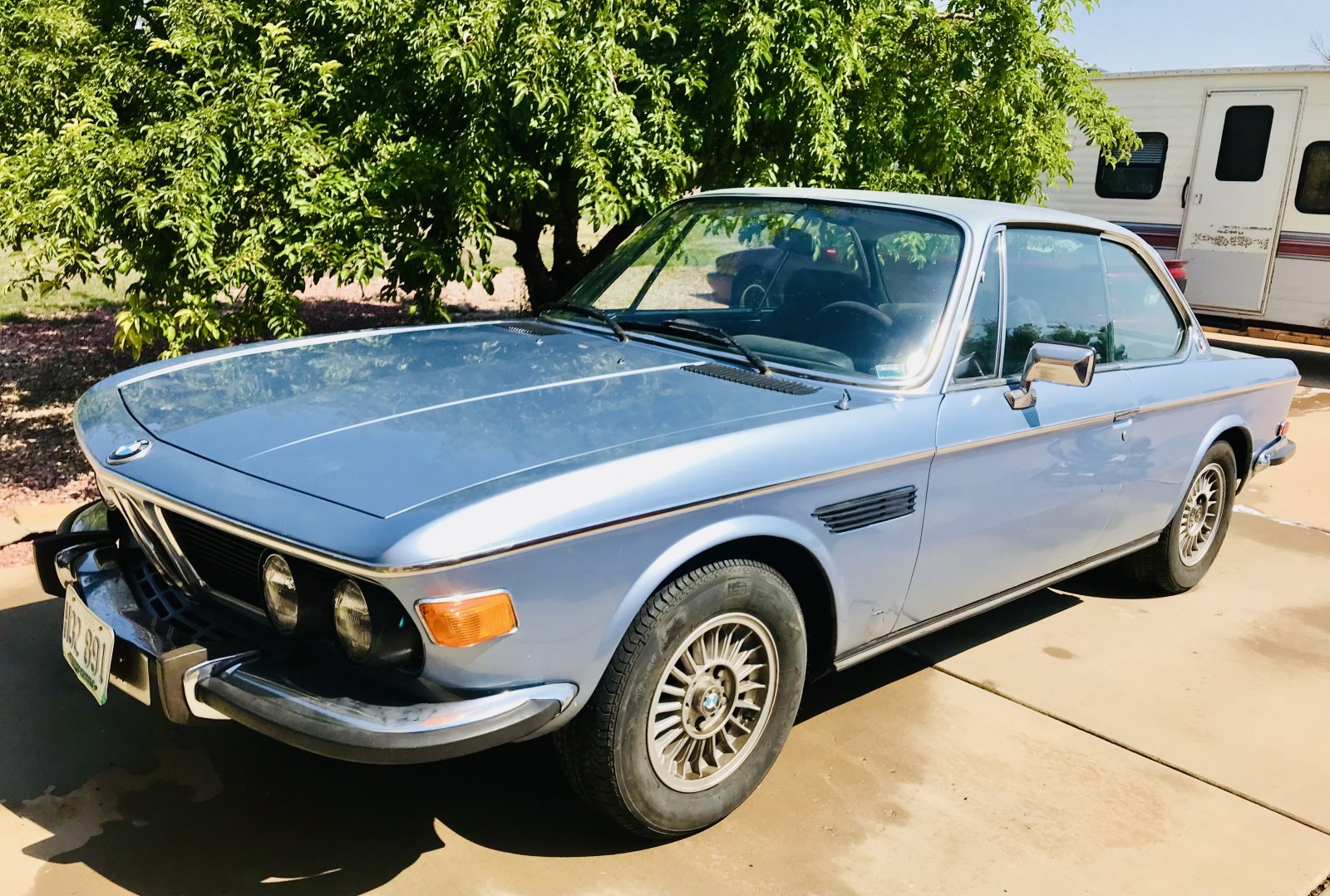

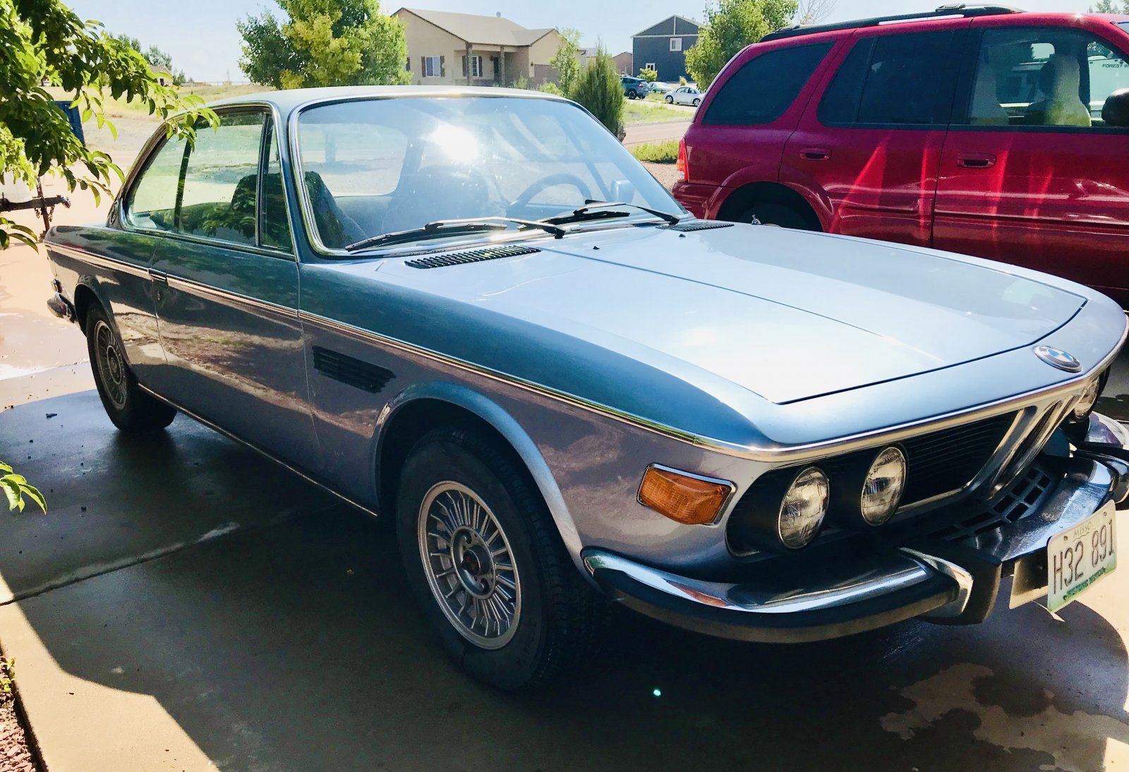

Greetings,
I have a grey market 1976 3.0CS that I’ve had stored for the past 18 years. (VIN 4300600). I bought it in Belgium in the mid 80’s so it has a bit of rust (lower front quarter panels blistering, dissolved front inner fenders, and spare tire compartment among other spots) but it still looks decent and runs ok after sitting for that long. Before taking it out on the road, I drained the small amount of gas that was still in it and replaced it with fresh gas. I also checked all the fluids and changed the diff oil with LiquiMoly 85/90 Mineral Oil. I’m planned on changing the transmission oil as well, but when I removed the fill plug, about 300 ml drained from the fill plug hole and it looked and smelled good. By that, I mean it looked clean like it was just changed and had mineral oil gear lube odor. I had the car level front to back and side to side. (Checked with a level on the door sill and on the sheet metal piece above the firewall.) I also plan on changing the oil, antifreeze and brake fluid, but may drive it a bit before I do. All these were freshly changed before putting it into storage around 2006.
I have a few questions for the group on how they recommend I proceed.
1) in draining the diff (not LSD), I removed the fill plug and heated the diff by placing an incandescent light with a reflector under the diff for ~60 minutes. This got the diff fairly warm to the touch, but not so hot that I couldn’t keep my hand on it. One consequence of doing this was that the diff oil expanded and a small amount drained out the fill plug and onto my light. No disaster, but a bit of a mess. I drained the rest of it out the bottom plug and it looked pretty dark. I refilled it with 1.5L of the oil mentioned above. With the recommended 1.5L, the oil level appears to be 1/4” below the fill plug.
Q1: does that sound correct or should it be level with the bottom of the fill plug when level?
2) The transmission oil appears new, but it also appears it was overfilled. I suspect the last mechanic who serviced it either just filled it to the fill plug and screwed the plug back in while it was draining or had the passenger side up when filling it and put the plug back in before leveling it. The current amount in the transmission is to the bottom of the fill plug.
Q2: would the group recommend draining the transmission and measure exactly 1.1L back in or is the bottom of the fill plug close enough? The car is completely original and has a 4 speed manual. Although it was sold as a 1976, a previous BMW mechanic told me it was built in 1975.
3) Does anyone know of a good vintage BMW mechanic in southern Colorado?
Thanks in advance for any advice.
Regards, John Price
