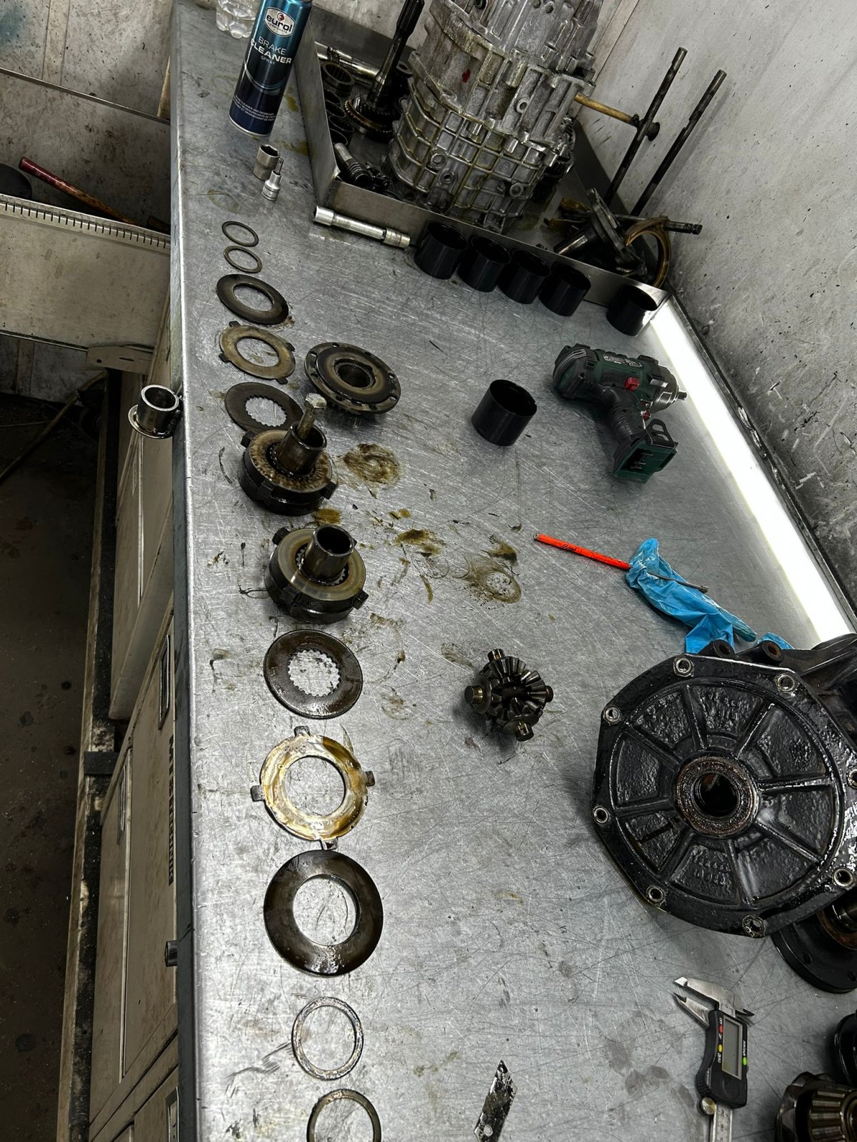

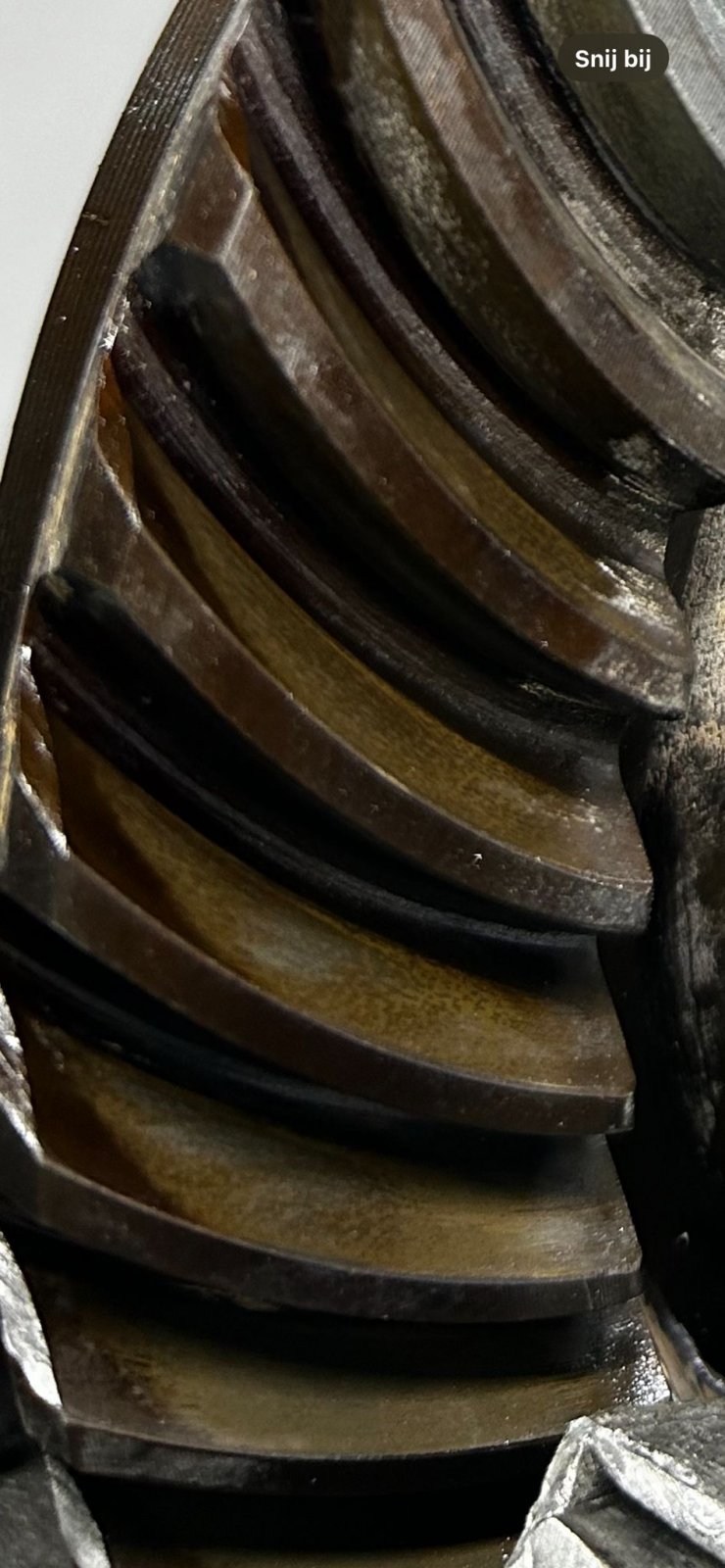

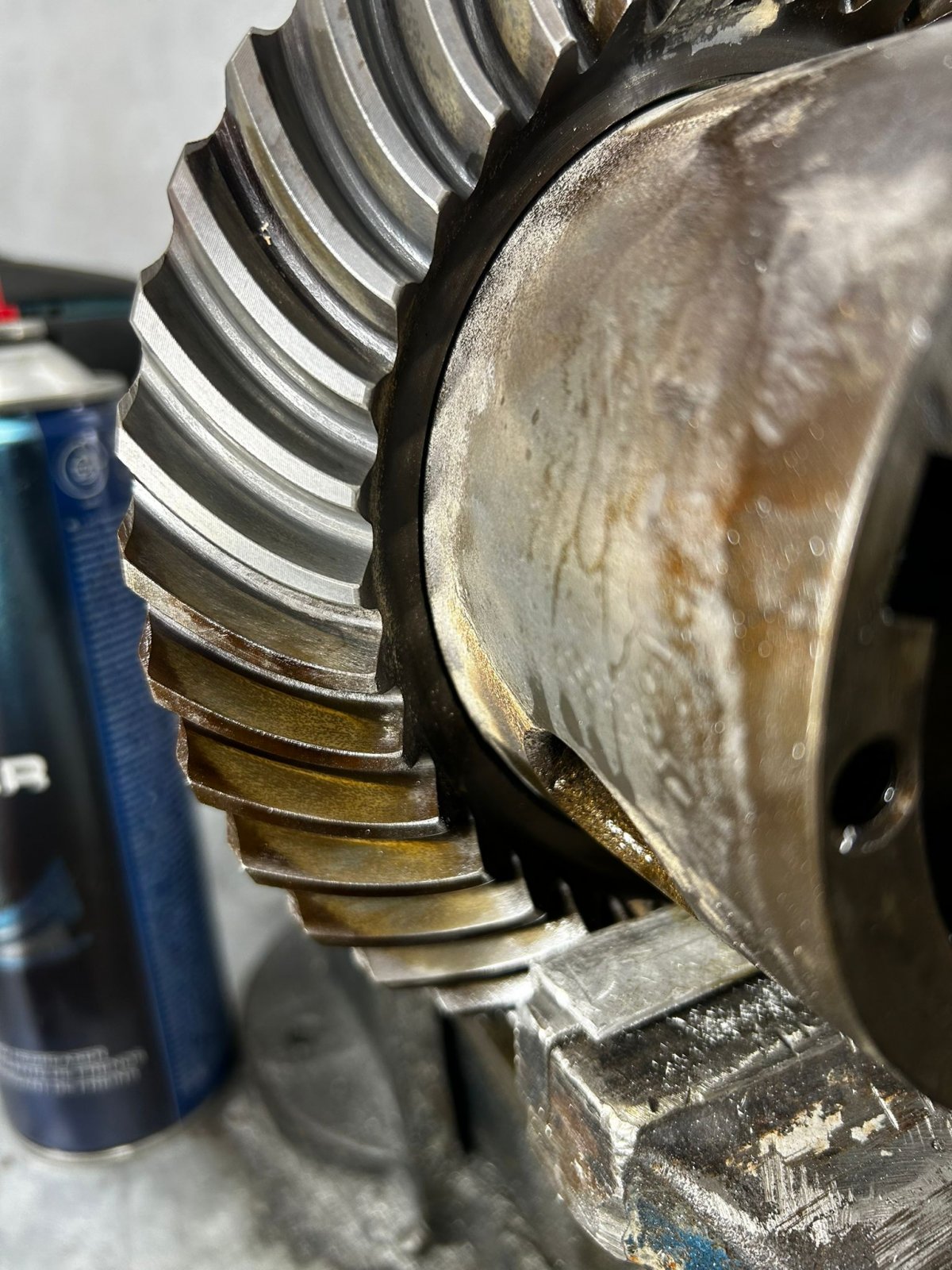

Hi all,

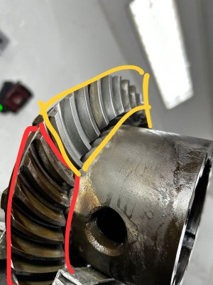

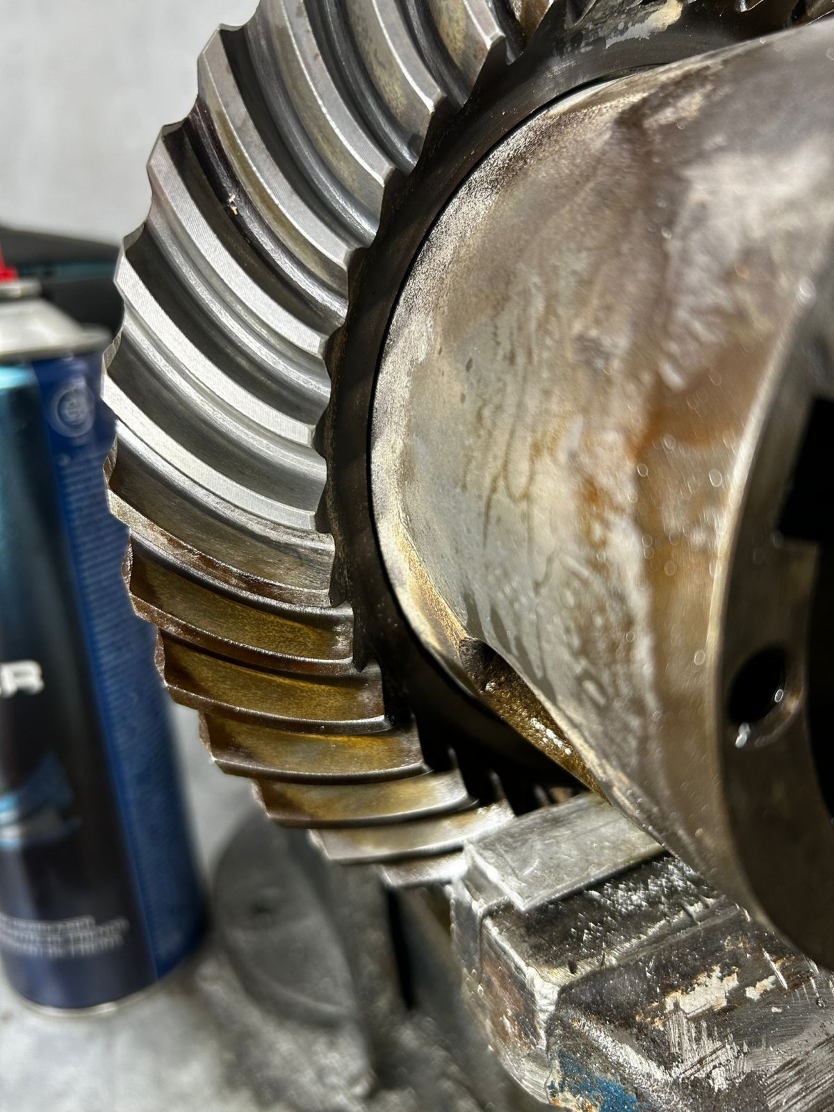

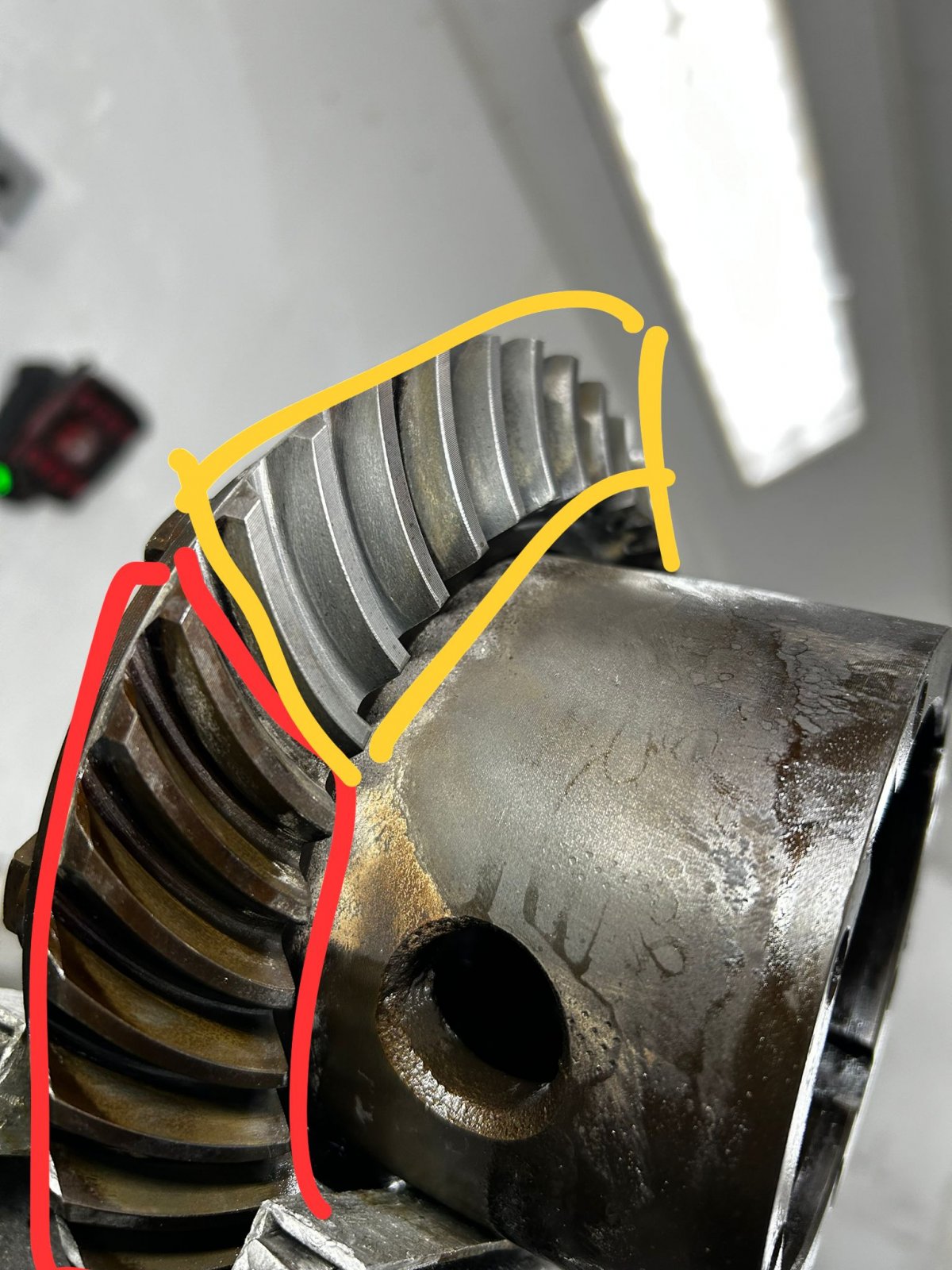

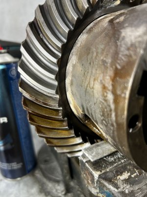

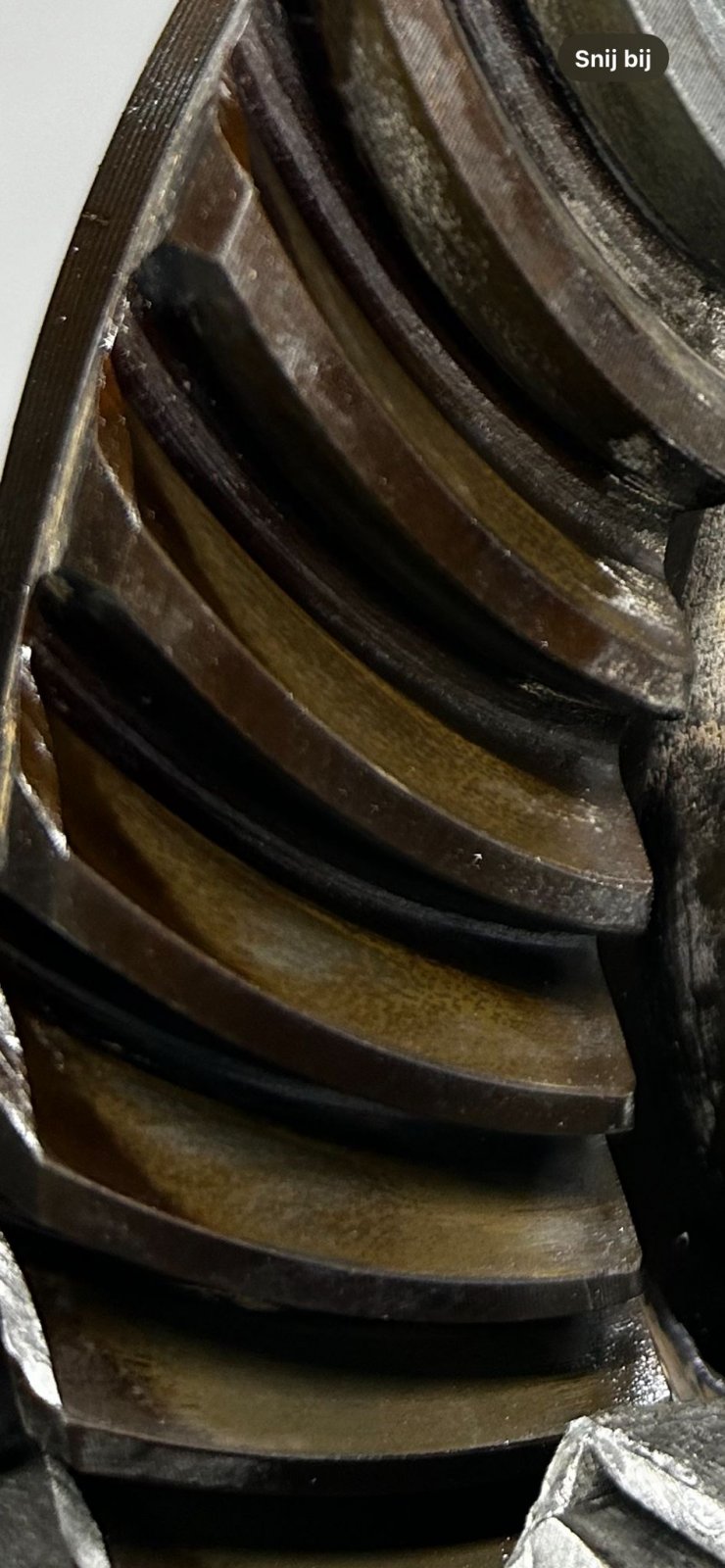

I did some research on the forum, but could not exactly find if one of you have experience with surface rust on the crown wheel of the diff just by the fact that the diff was standing on the shelf for years?
We opened mine yesterday and it definitly needs new bearings, but the question is if it would be harmfull to take of the surface rust of the crown wheel by a copper brush and then put it back together. My specialist does not give any guarantee that it doesn't start 'crying' at idle speed afterwards. And I have some bad experience with crying diffs just by replacing stuff.
Personally I think it's not an issue, but before spending 1000+ euro's for a complete overhaul I would like to check some opinions here. My specialist did a few teeth already, but never experienced the amount of surface rust as with this one.
Thx!

How many kilometres/miles do you want to drive with car? 5000 / year or 100.000 / year?
I would give it a try. Cleaning looks nice enough. Cleaning with a copper brush.

I think 1000 kilometers per year max. But still, if the 'crying' is there it won't go away anymore is my experience no matter how many kilometers/miles you drive.
I know that it has to do with the pinion and crown wheel and how they are matched up to eachother. I read on the internet that the setup of the 2 in general is unique and therefore sensative for any adjustments or fixing play. But that is all based on what I read on the internet and my first diff overhaul, so I'm a bit careful in changing/replacing to much in the diff.

I see no pitting?
Is this an 8 or 10 bolt diff?
What ratio?
I see no pitting?
What ratio?

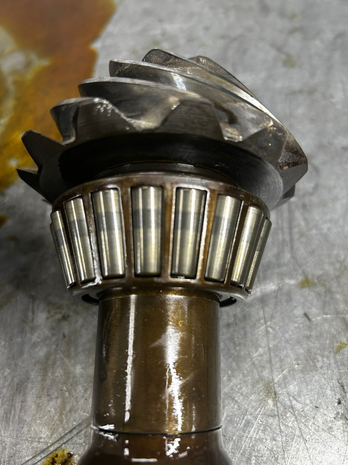

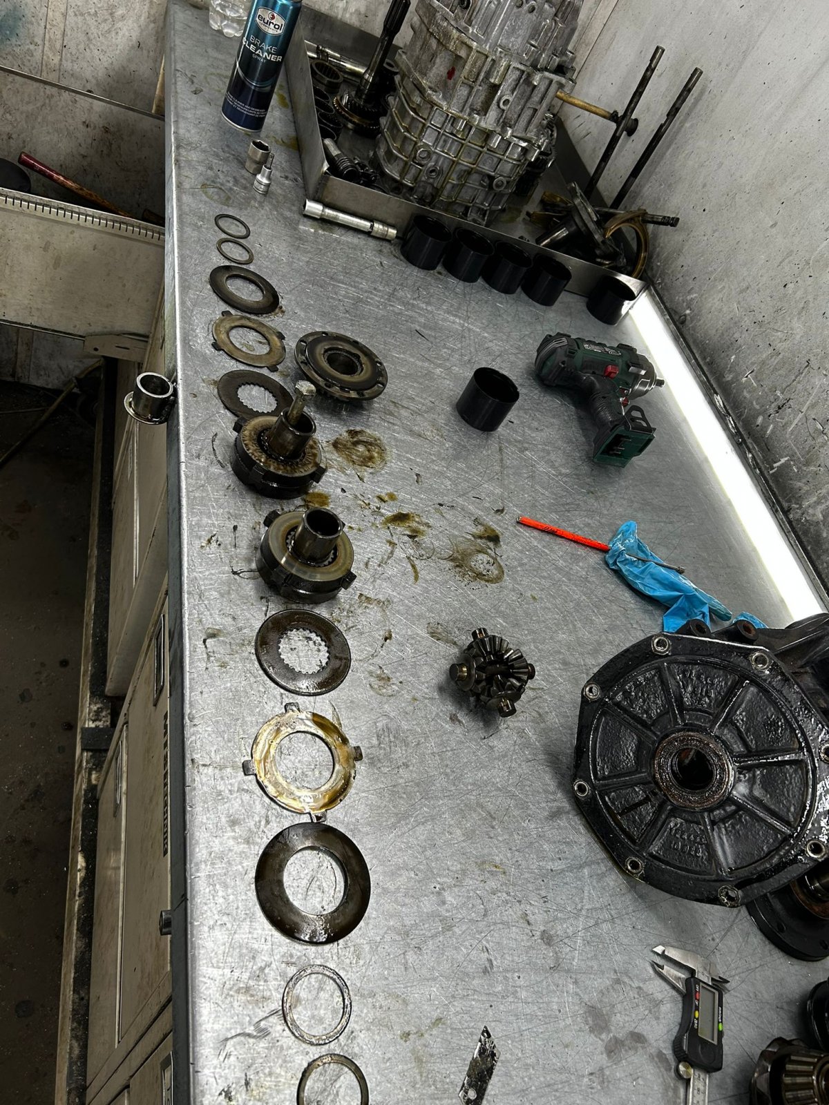

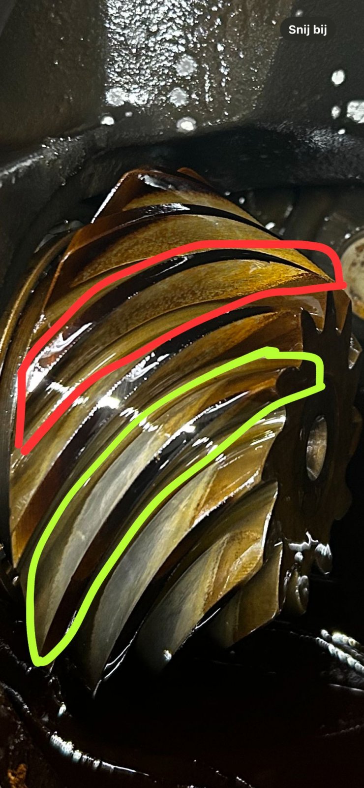

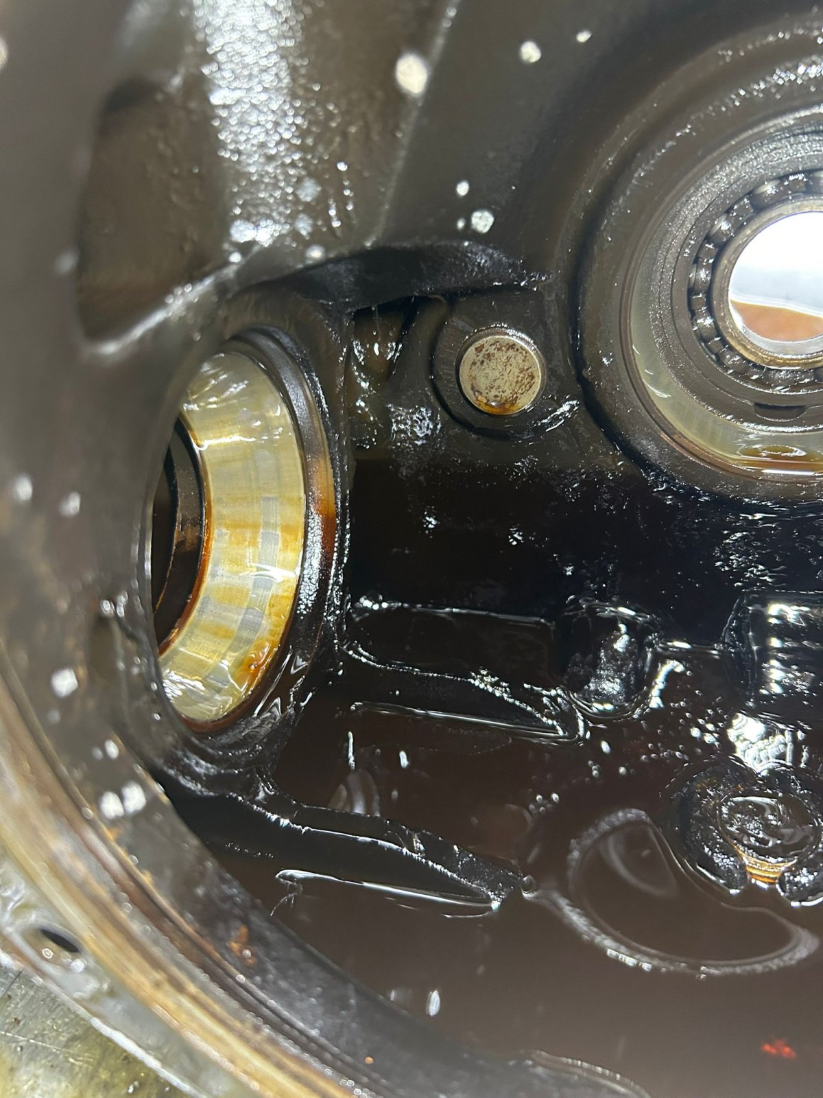

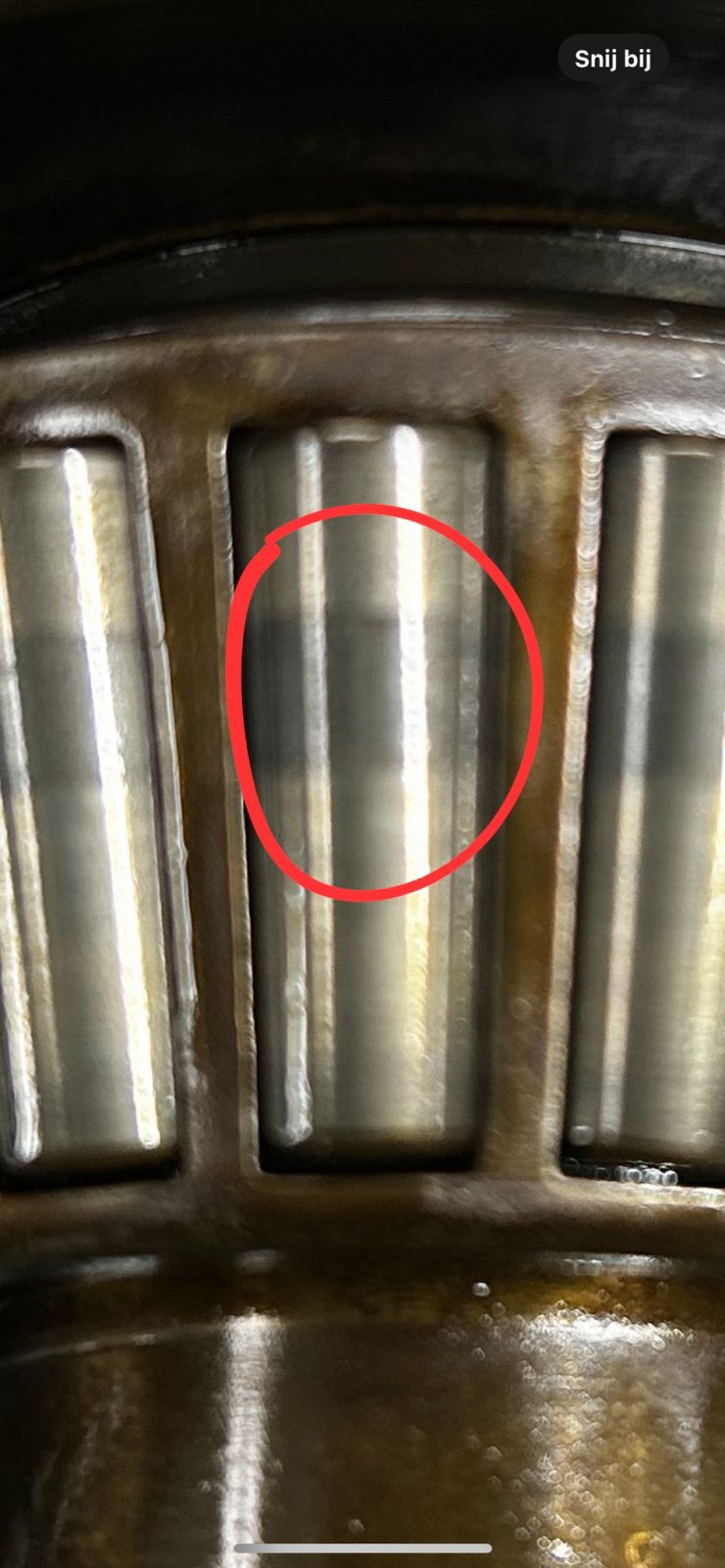

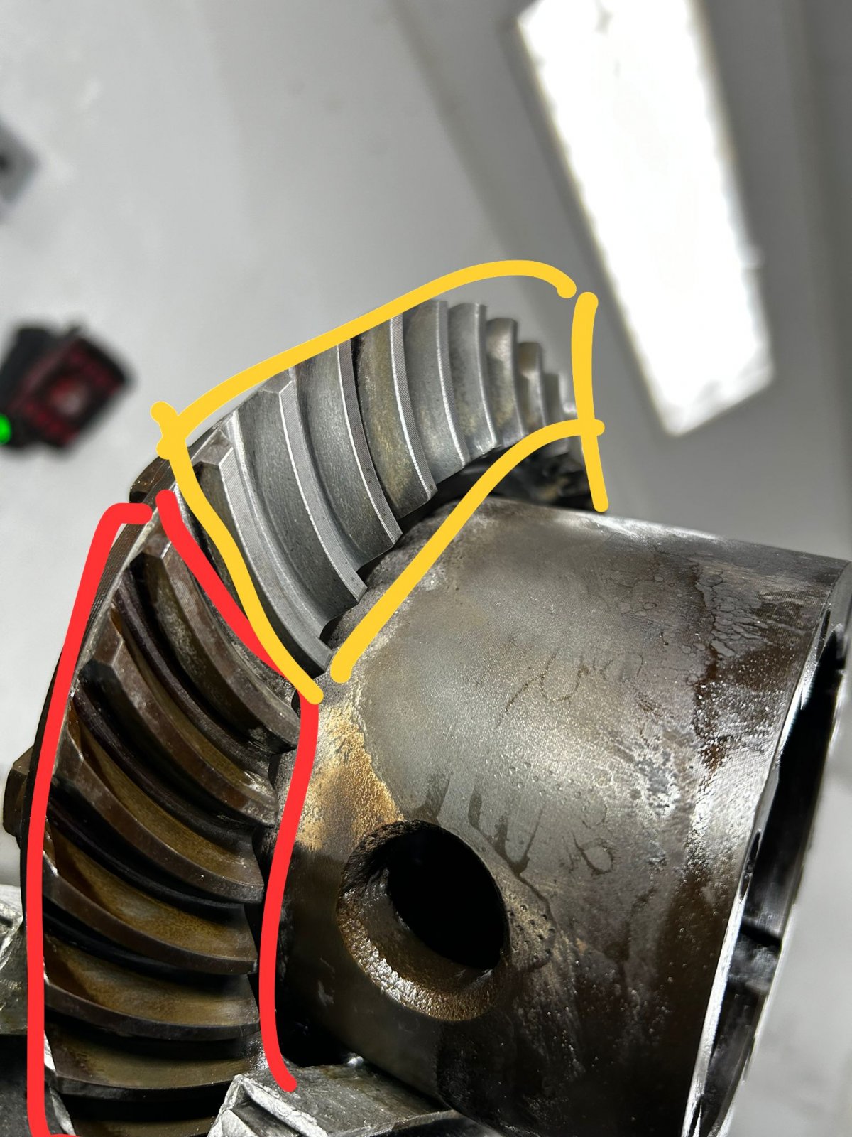

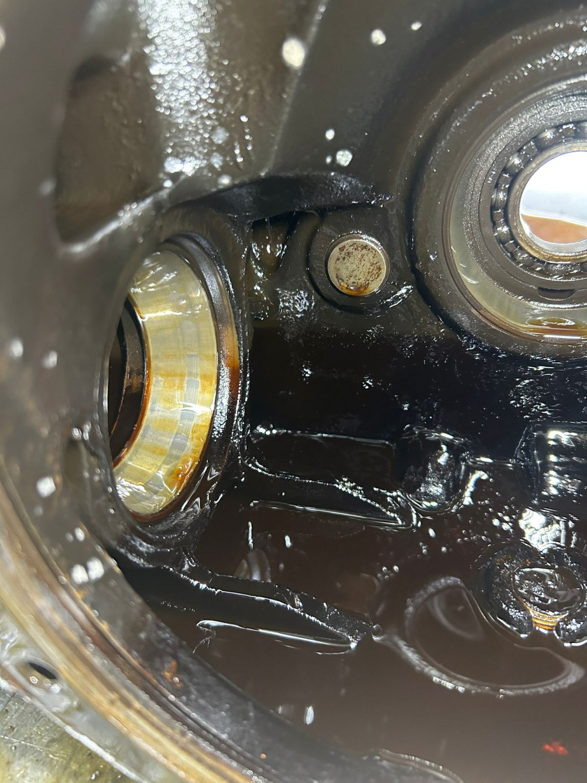

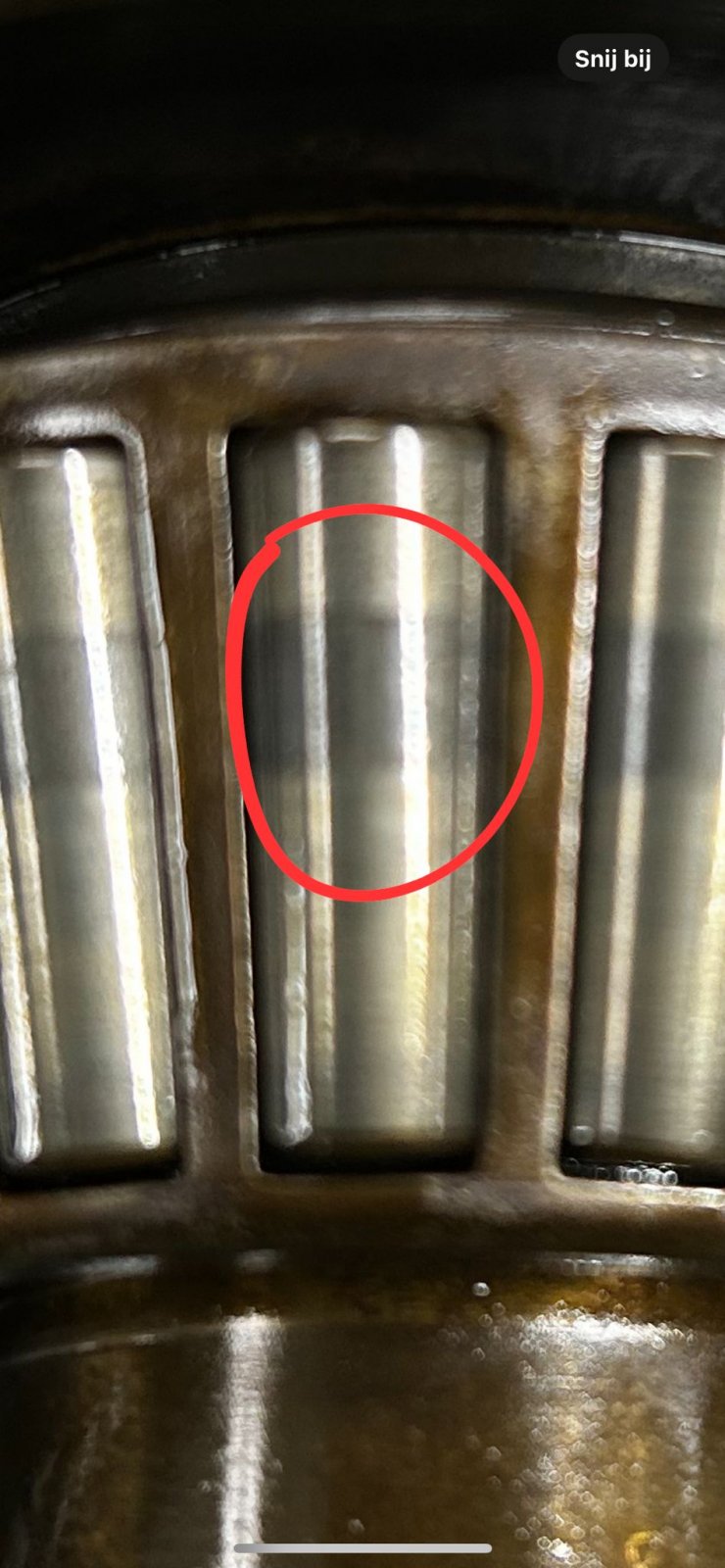

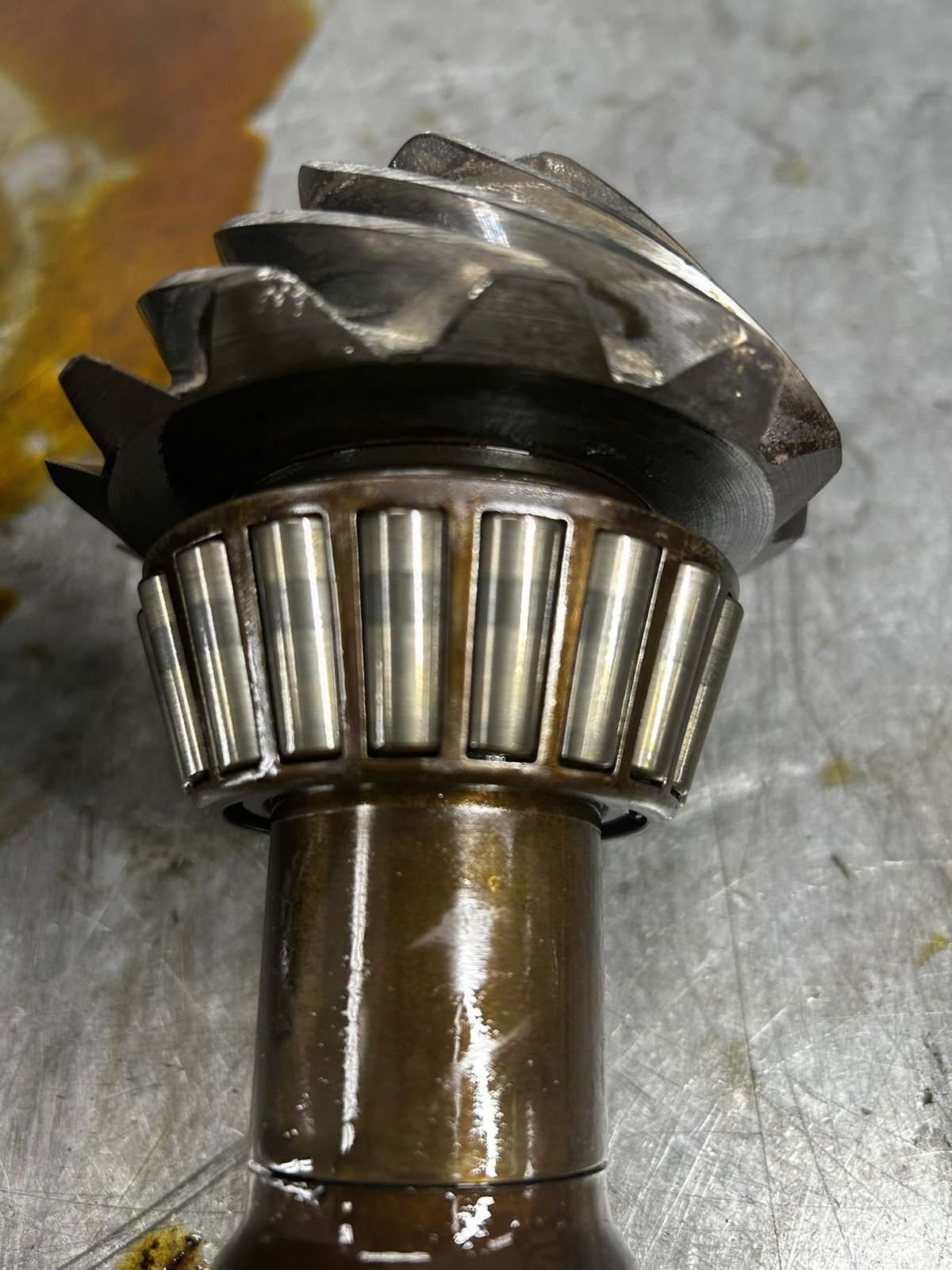

No pitting indeed, but according to my specialist it suffered enough based on below foto and the ‘blue’ line on the bearing rollers.
It’s an 8 bolt diff and 3.25 ratio.

I know the set and the bearings will be replaced, but the whole point was my experience and fear for a crying diff based on previous overhaul. Was wondering if others also experienced that and to get a feeling on how critical the pinion-crown relation really is.
If your guy is a diff specialist at a gear shop and he is good- listen to him.
