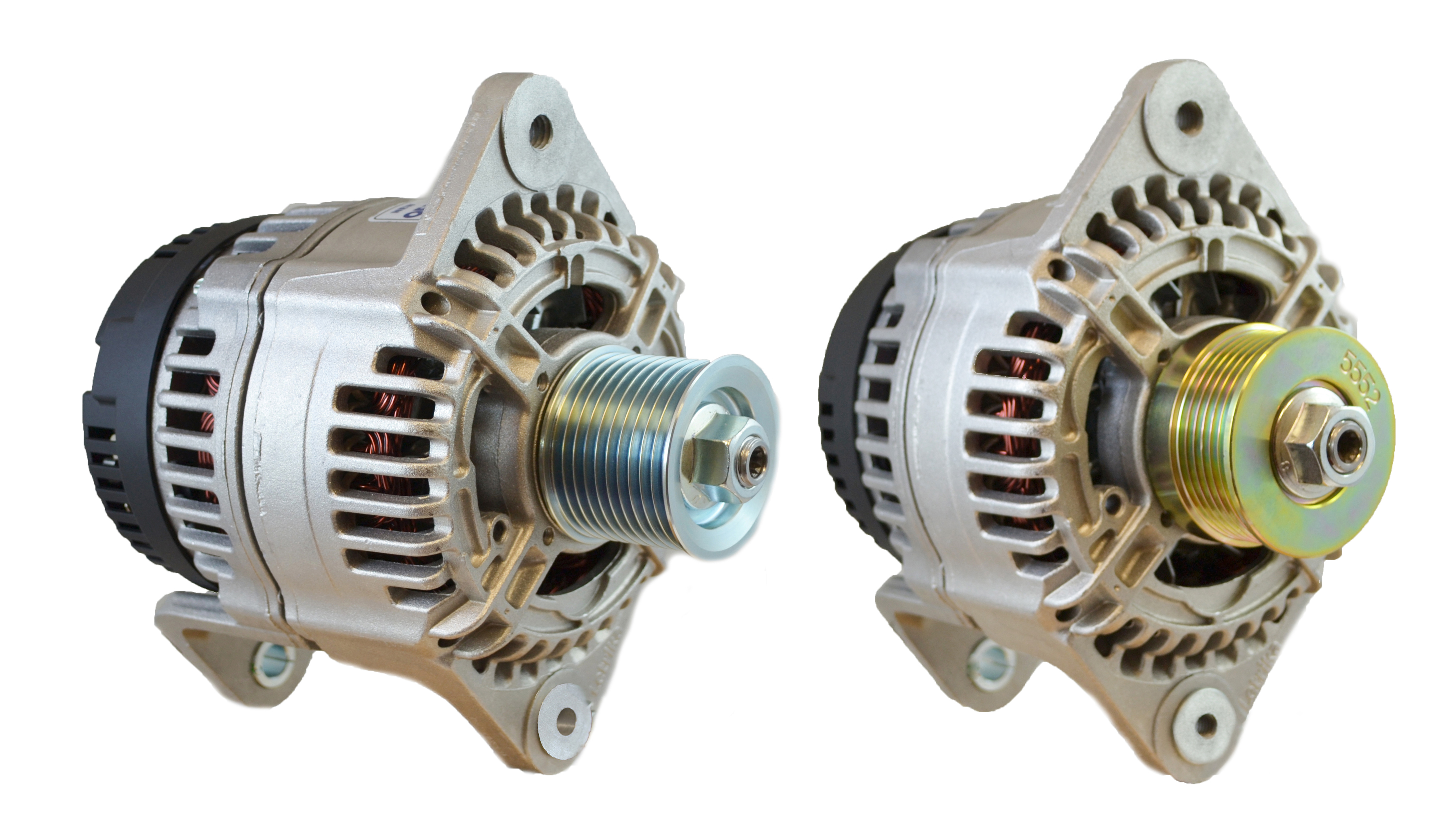

How about this?
Welp, there are a couple tech issues with that direction, but the main one is the $3500 price tag. I'm hoping for a real simple, air cooled, no semi-hybrid, 42V old-school alternator off...something that I can just swap in for the 24V one I'm running now.
