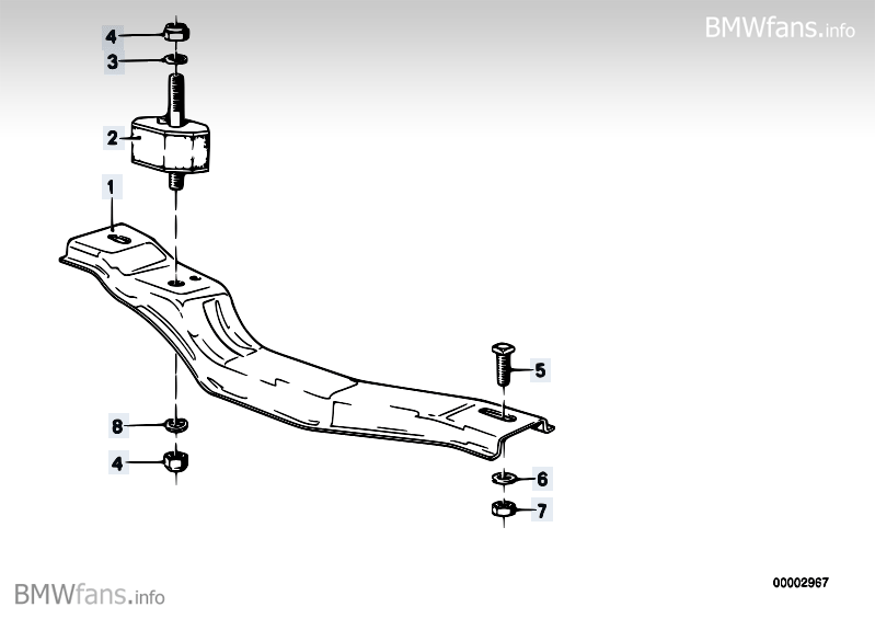

hello boys I am just finished install my new 5 step gear box, no not quite finished well I need a cross member for my gearbox as 4 speed not fit, I've tried almost everything with finding one but without success, do anyone know where i can but one! preferably in europe
You would need the crossmember # 23 71 1 175 314 !
E12 or E24 1st Series
Small modifications are necessary........nothing difficult !
Price is 21€, according to the online ETK, ask your BMW-dealer !
If the part is out of stock, I have one in my container, but I dont know when I go there next time.
