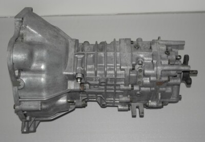

The other option that may work (yet get you in jail) is to keep a 4-speed Getrag and add a Laycock overdrive to get you 5th gear like Volvos did:
"A 256/6 is 3500€ from the Netherlands..."
You can import one from the USA for a lot cheaper than that.
Or from Lithuania (which is much closer):
