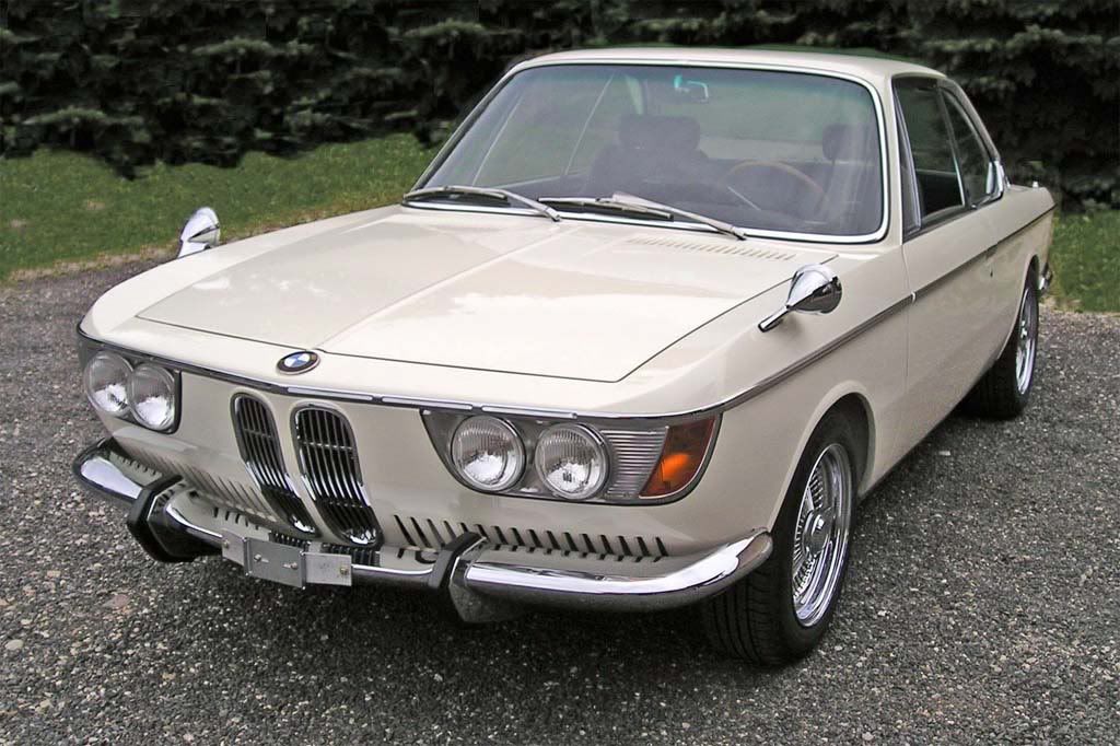

Maybe this could be for interest for you :
Car was done by a friend of mine, i made this link to our austrian forum in translated version:
http://translate.google.at/translat...19-5564256-0.html&sl=de&tl=en&history_state0=
