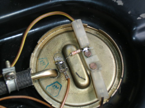

I just finished repairing the fuel sending unit on my E3. It had the same broken wire issue. Although I didn't have any luck finding resistance wire locally, I did find some on ebay. I ended up using 40 ga nichrome and then added a resistor in parallel (external of tank) to get the resistances right... works just like new. I think the single wire can be regular solid core copper wire. I also have some extra wire if someone needs some.
Could you snap a pic of the resistor and which wire it is on? As it turns out my gauge will sometimes hang up near 1/4 tank so I am gonna redo it with new wire.
I can post a pic this evening when I get home from work. The resistor I added is outside of the sending unit across the gauge (yellow-tan) and ground (tan) terminals (the picture should clarify).
Factory spec for the fuel sender is 3.2 ohms (full tank) & 73.7 ohms (empty tank). When I replaced the resistance wire I had 6 ohms (full) & 100 ohms (empty). Placing a resistor in parallel with the sending unit will lower the empty tank resistance while maintaining the full tank resistance. Adjusting the empty tank value using a resistor in parallel works only if your empty tank resistance is larger than the desired resistance.
In my case, using a 330 ohm 0.5 watt resistor in parallel with the 100 ohm changed my empty tank resistance value to 75.6 ohm
