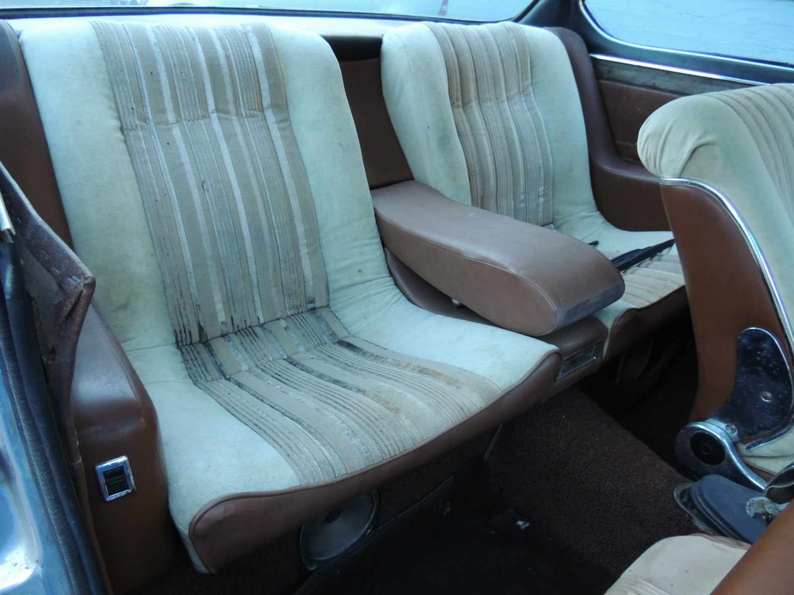

I went and looked at this car, Rust is just showing along bottom of doors. Rear of rockers has some rust holes. Floors need replacing. Upper part of body is good. Interior is a total wreck, good thing or someone would put some bond and respray for a quick flip. Car is a project that needs everything, Motor has noise but runs and drives. I passed !
Interesting placement of speakers. Not ideal for sound-direction:

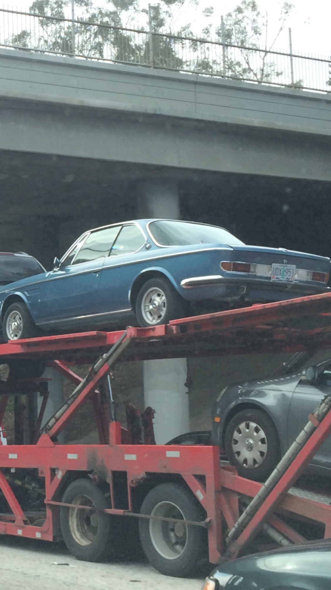

I accidentally came across this car driving through Portland on Tuesday. Stopped to take a quick look. Definitely a project car. $17k seems a bit high to me. Everything needs work. The interior is scary. Low miles but roughly used.
Positives - the front wheel well at the base of the A pillar does not look too bad.
