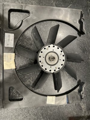

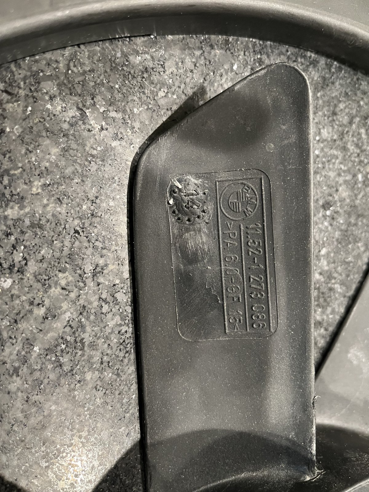

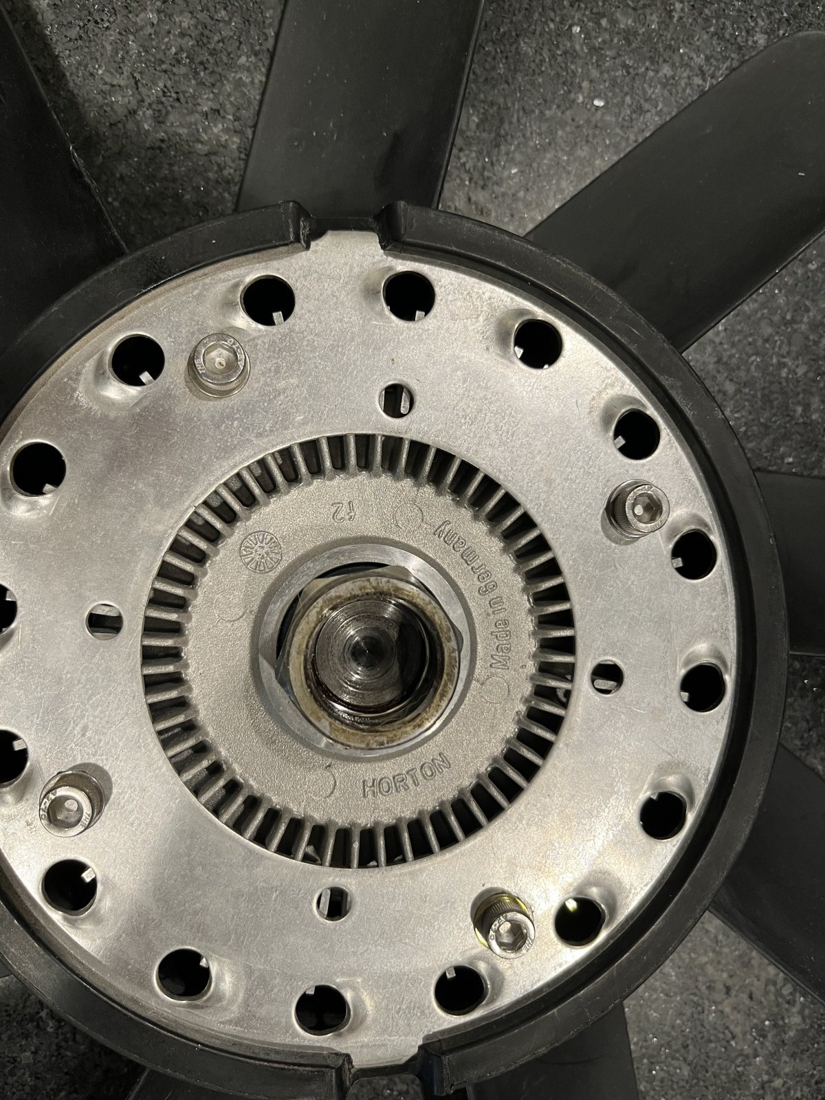

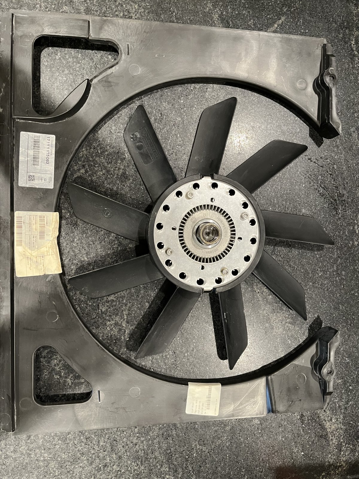

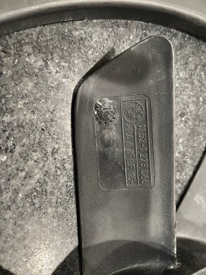

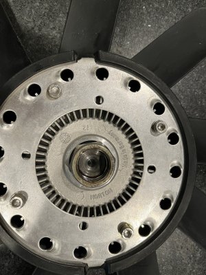

Regarding the gen 3, I got this from another forum member, here are the pictures for the items with part numbers shown. I no longer have the shroud, another member bought it, but the shroud appears to still be available. Reach out via DM, thinking about $100 plus shipping would be fine.
Note that you'll also need to change the pulley. I don't remember what the part number would be for the gen 3 version or whether it's the same as the gen 4.

And since @D Calkins is new and I distinctly remember this confusion, the way to identify all of these is
Gen 1 has red 5-blade fan and no shroud
Not sure about gen 2 but I think it's just 9-blade fan upgrade?
Gen 3 is pictured above and has 9-blade fan with upgraded viscous clutch and a separate shroud
Gen 4 as Don mentions in that thread has a fan with an integrated shroud, also with an upgraded viscous clutch (different from gen 3). Advantage is the integrated shroud and the thinner fan in a relatively tight area.
The challenge for me for the gen 4 did end up being the pulleys because the one needed for the gen 4 is somewhat hard to find and unfortunately often expensive. I know Don is able to find them, it seems like all old BMWs go to California to be scavenged by rebuilders there. All I get here in Washington are rusted-out cars in fields.
Just use the original water pump, the first gen viscous clutch called a ‘bolt on’ as it uses the center mount with the bolt on the forward side and existing pulley. See diagram in Post 26. The second gen clutch is a ‘spin on’ with the large 32mm nut on the rear of the clutch and requires a newer water pump and pulley. Don knows that I think the fan with the outer ring just does not look correct. Use a shroud if you want, they were introduced on 74 coupes.
