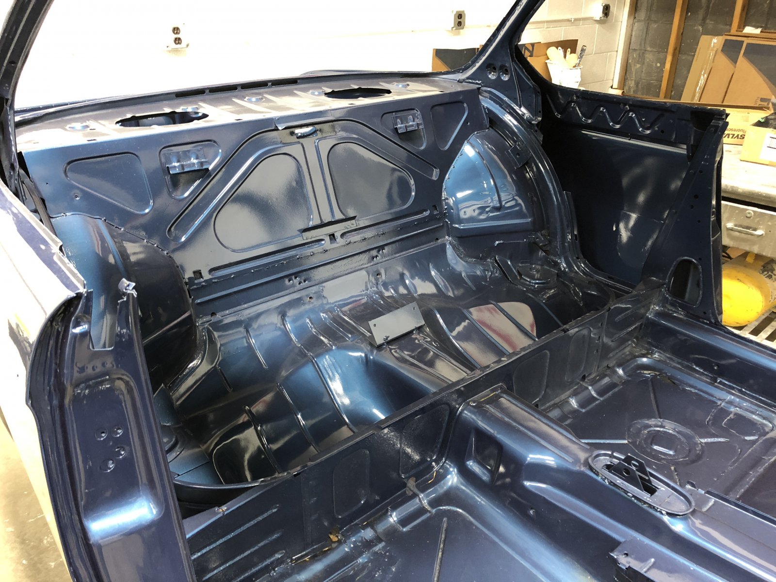

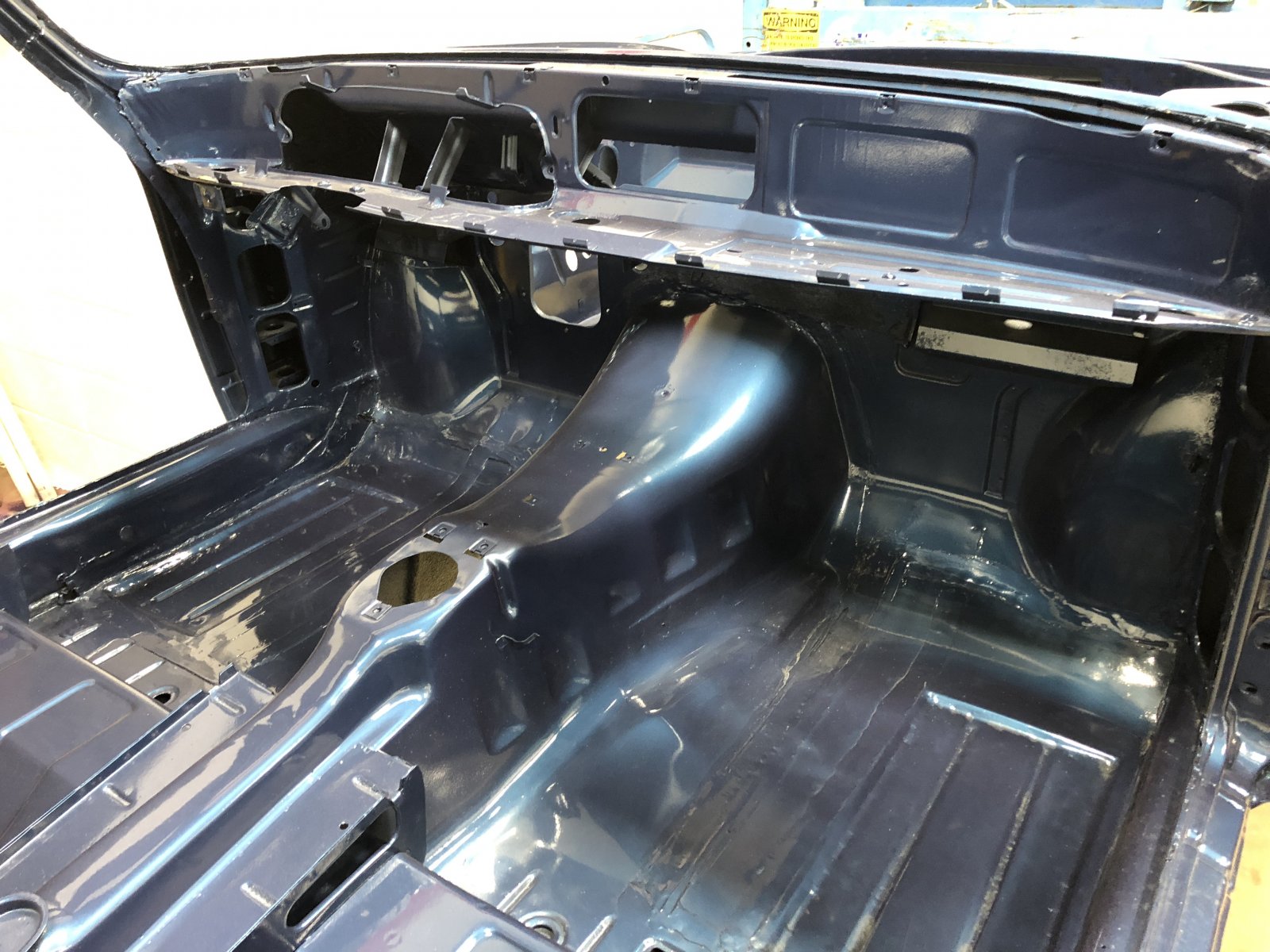

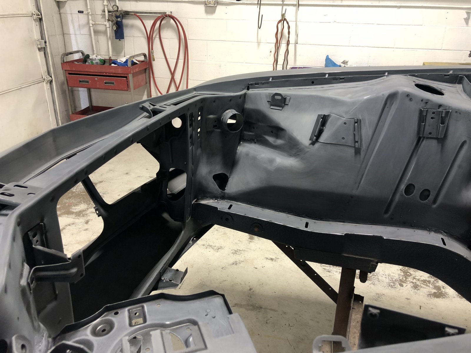

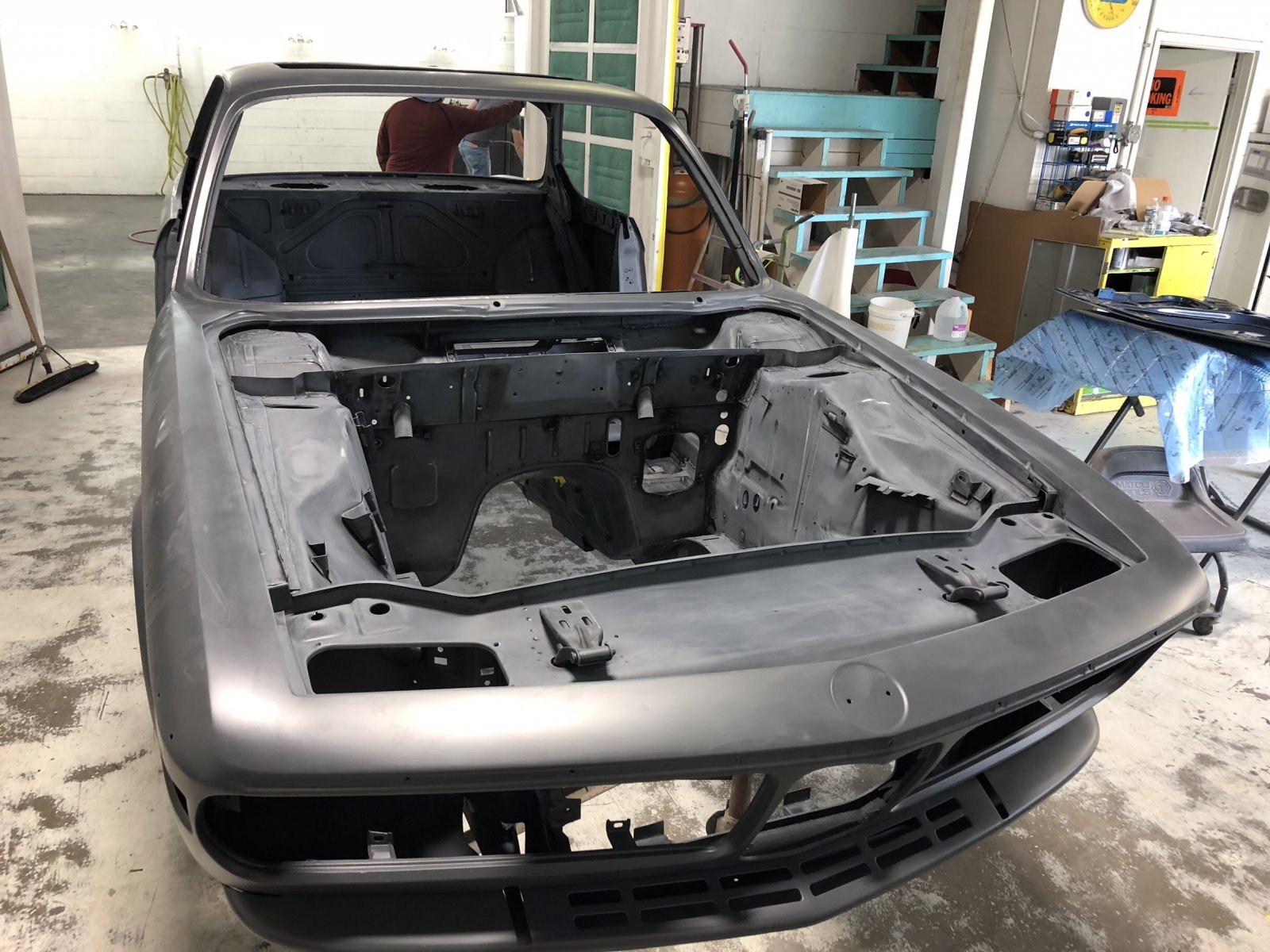

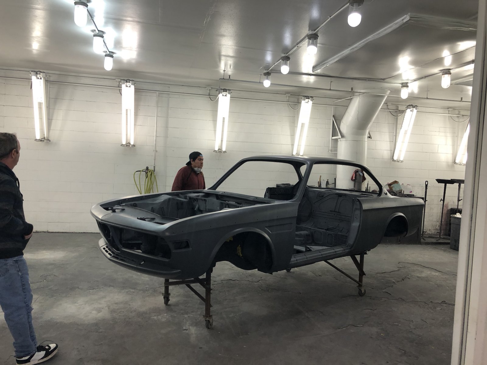

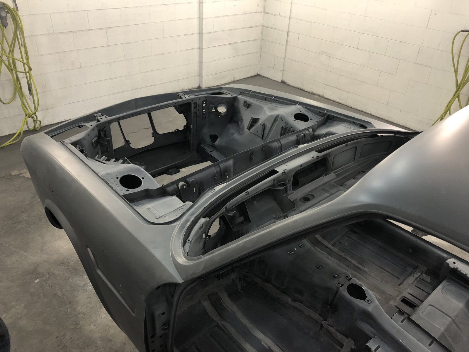

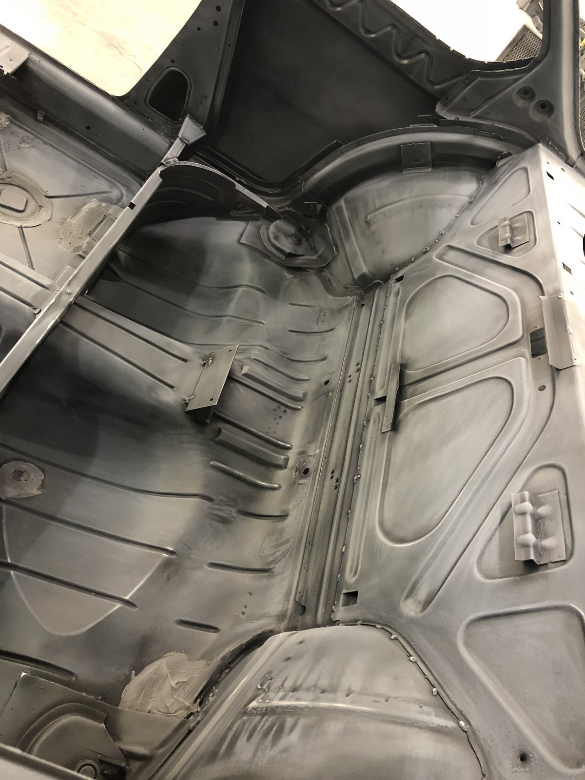

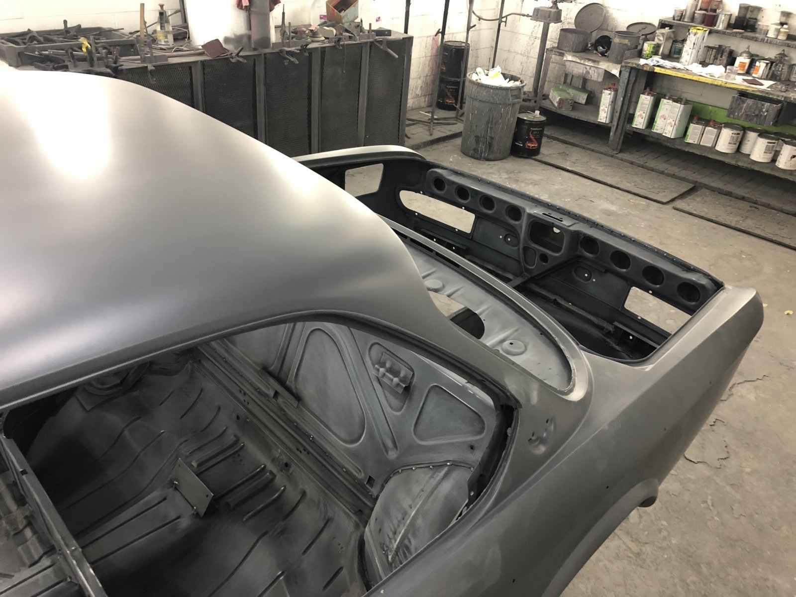

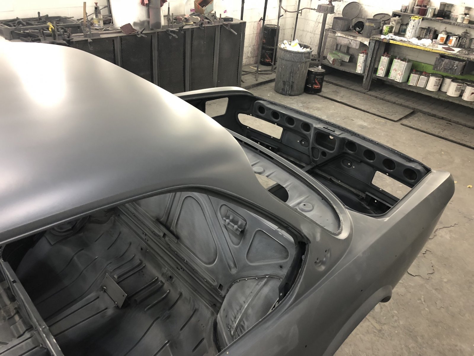

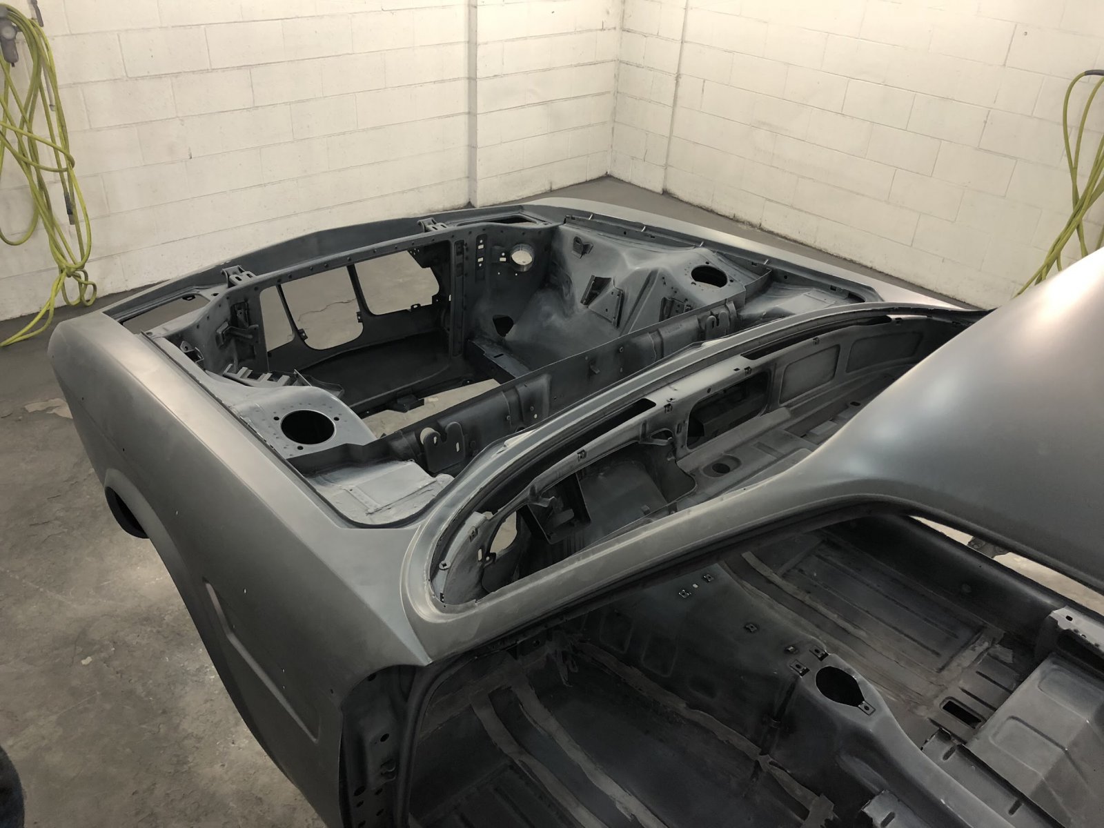

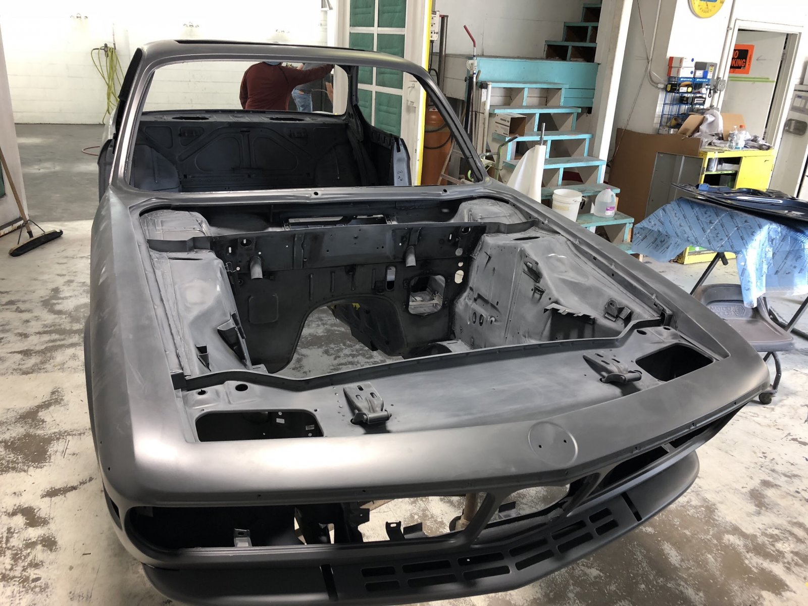

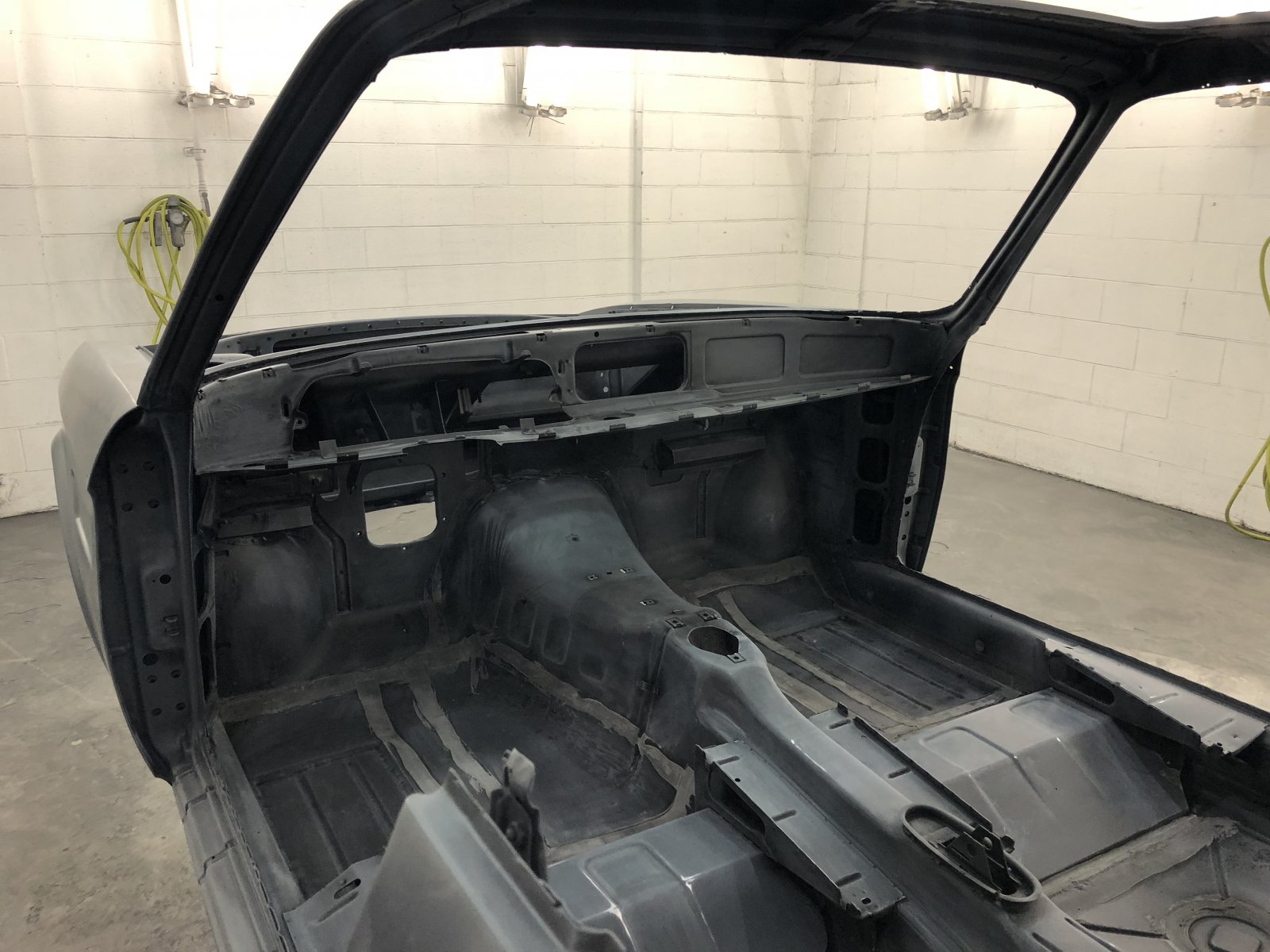

Chassis and Body Prep

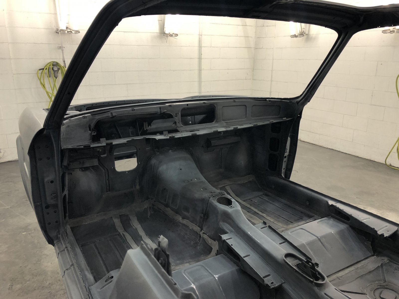

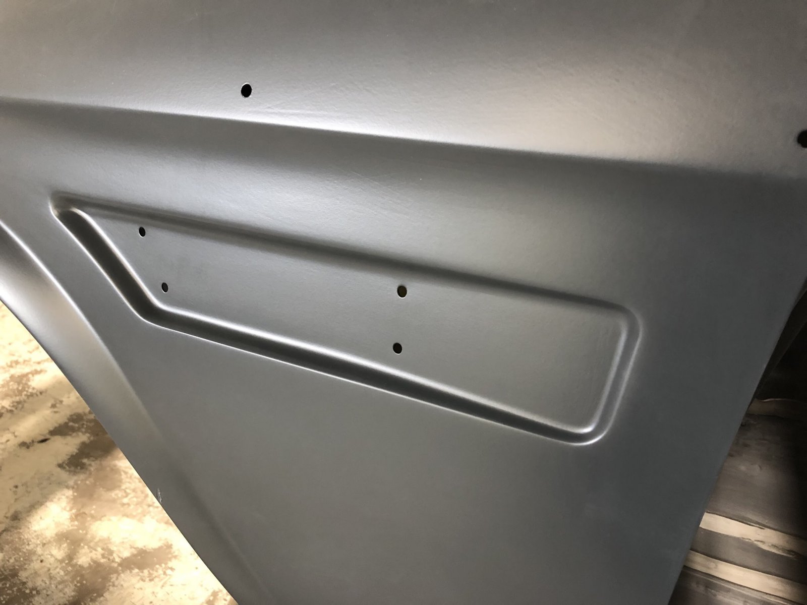

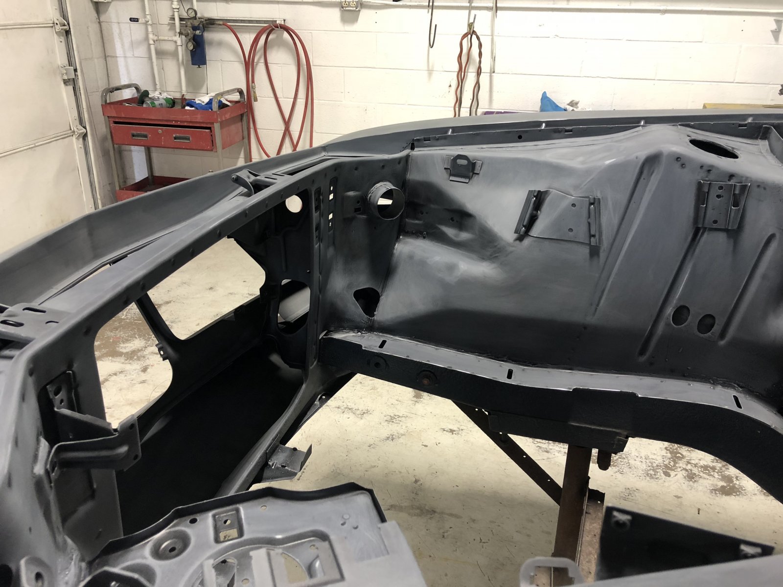

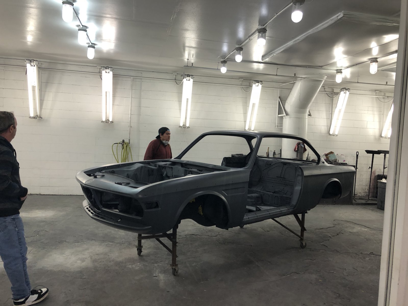

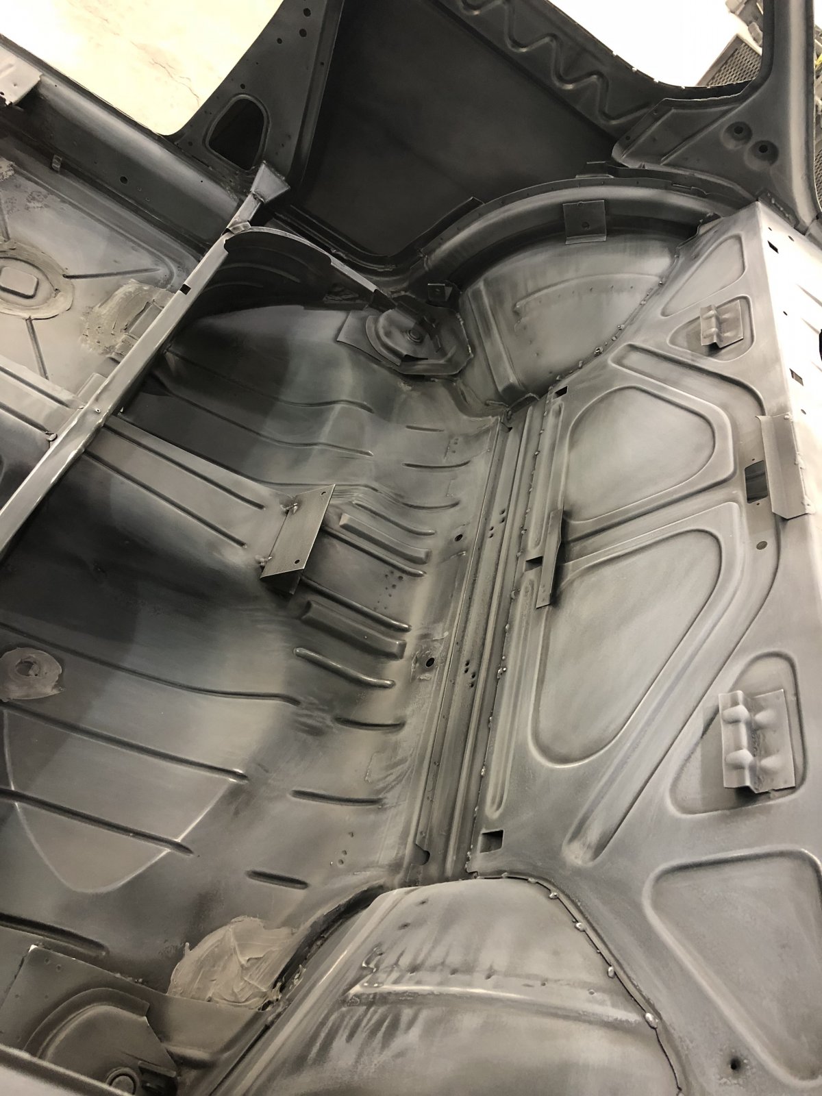

And step one complete - back to metal, then all lower seams filled with seam sealer. Underside was epoxy coated. Chassis was amazingly straight and rust free thanks to the prior owner's work and a life spent mostly indoors. Did not require any rust correction, cutting or welding, almost no blemishes.

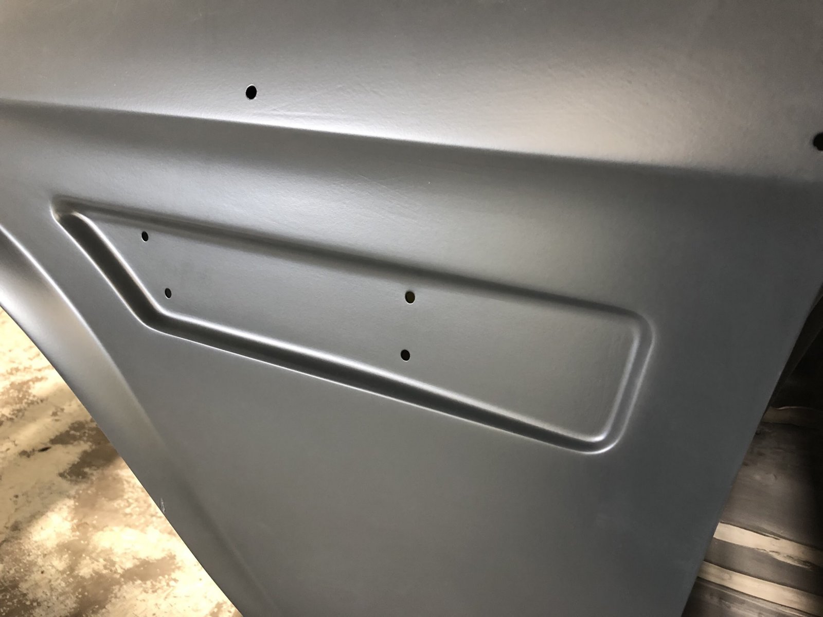

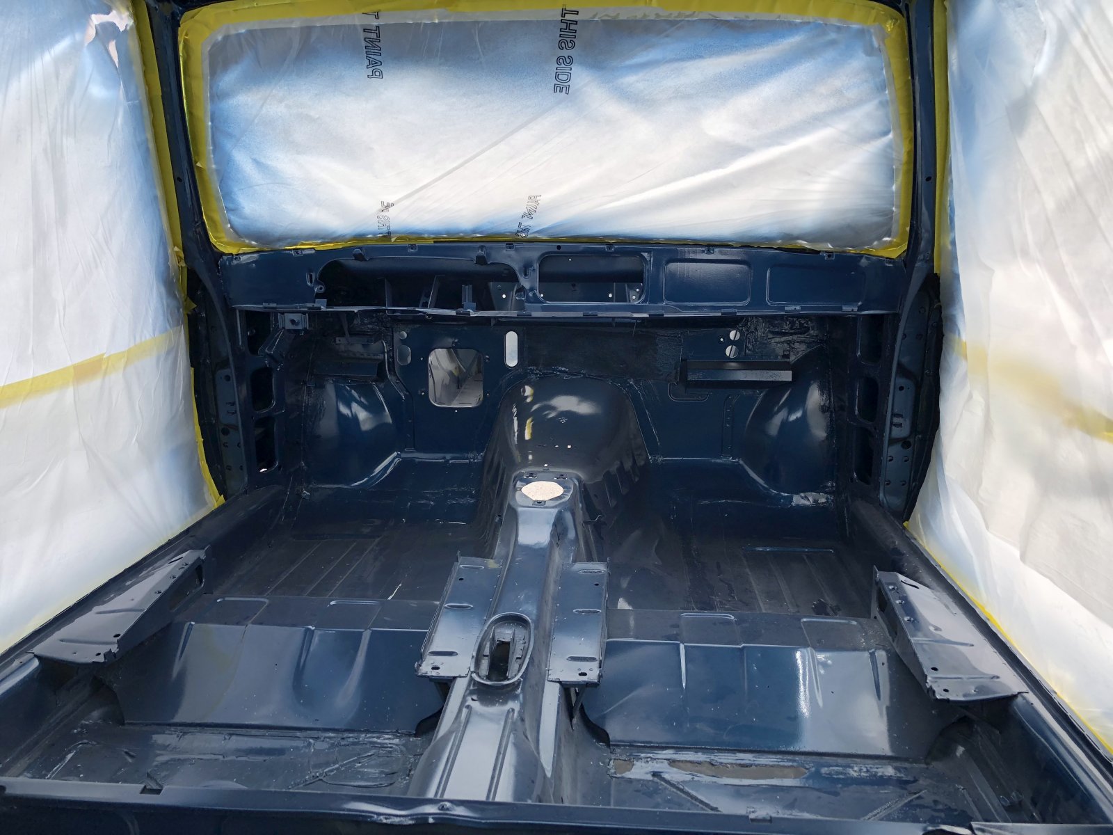

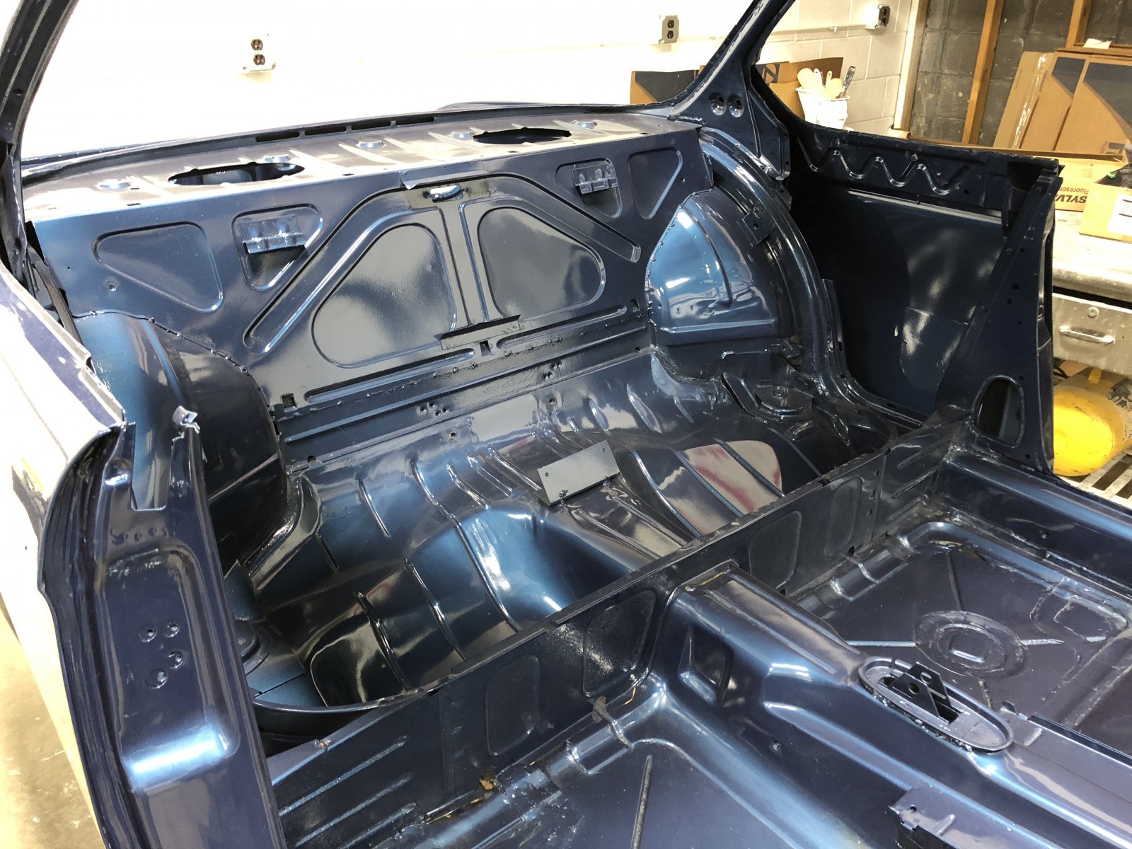

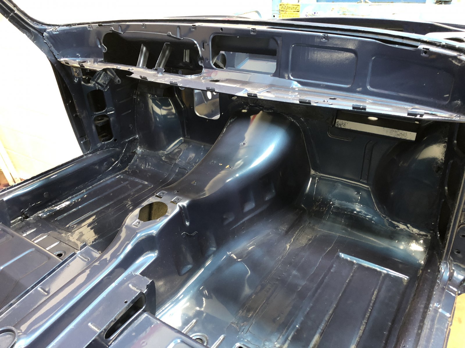

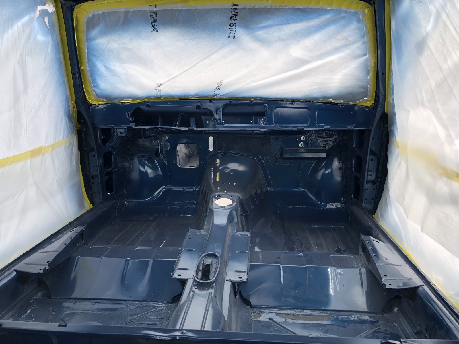

First bits of paint - inside/underside of doors, trunk and hood. Color is Nachtblau with a saddle interior

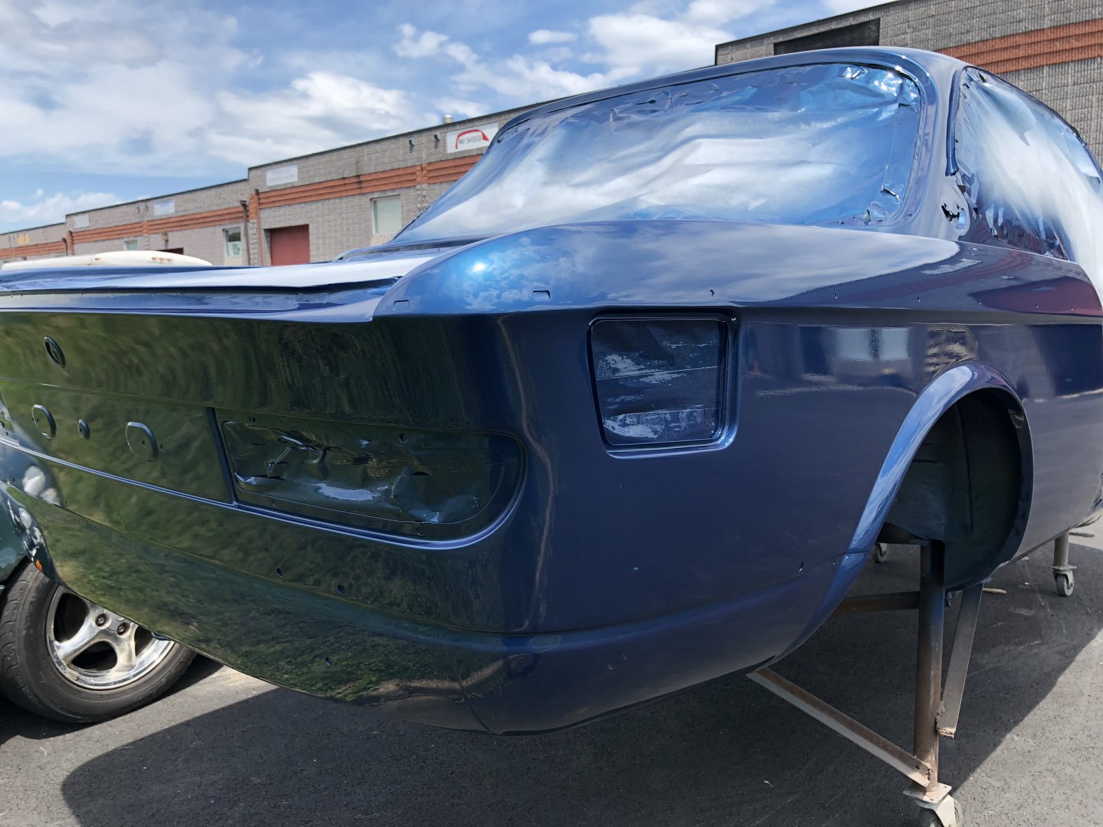

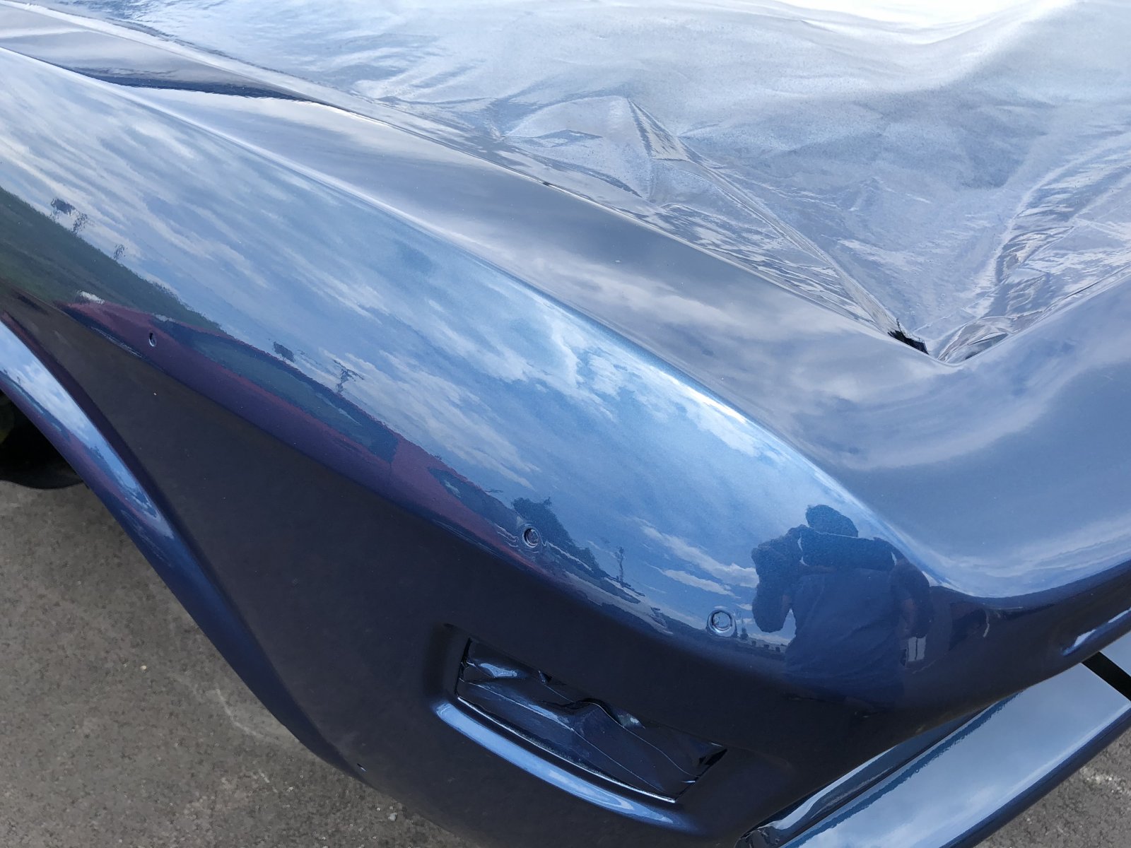

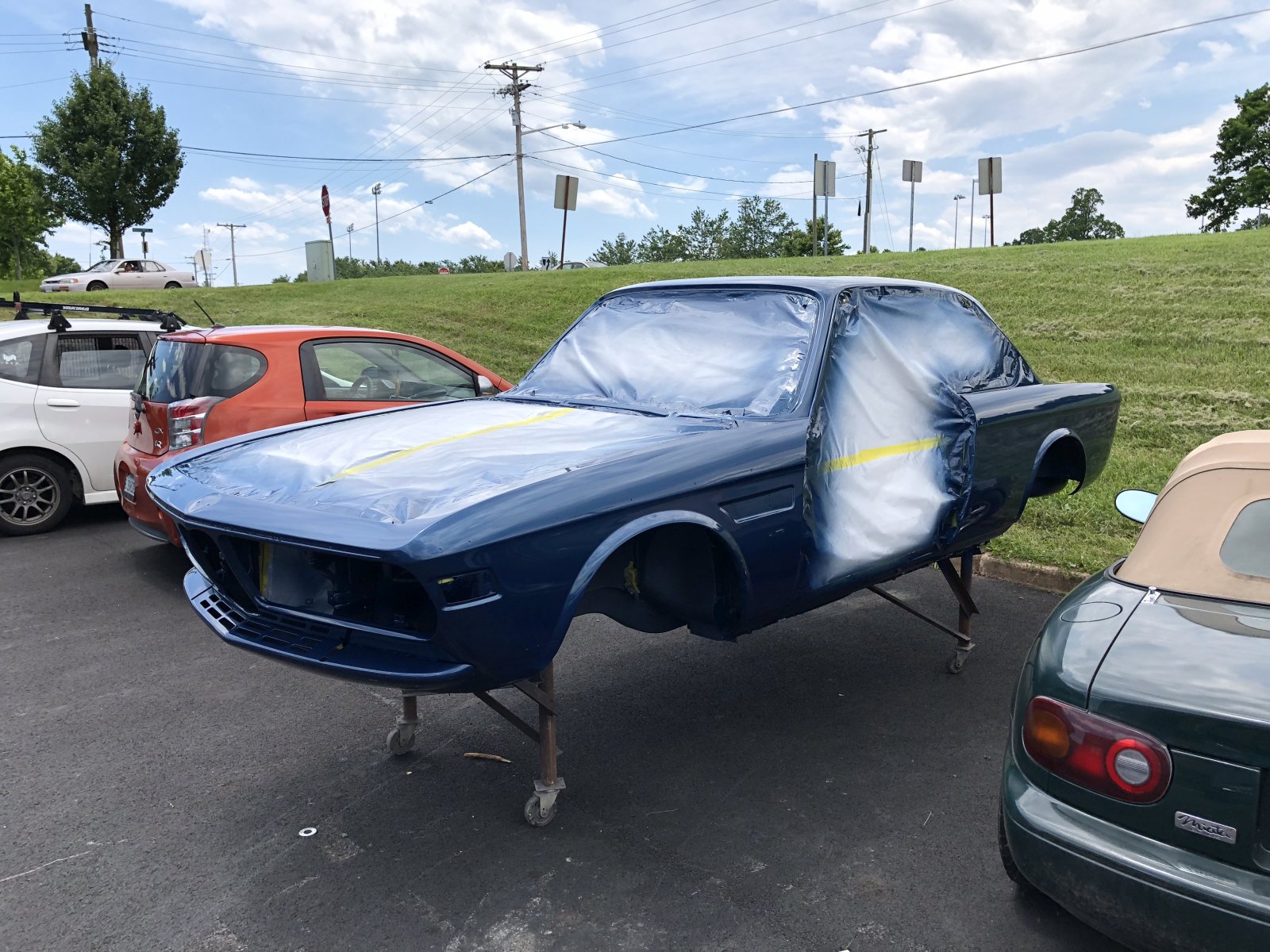

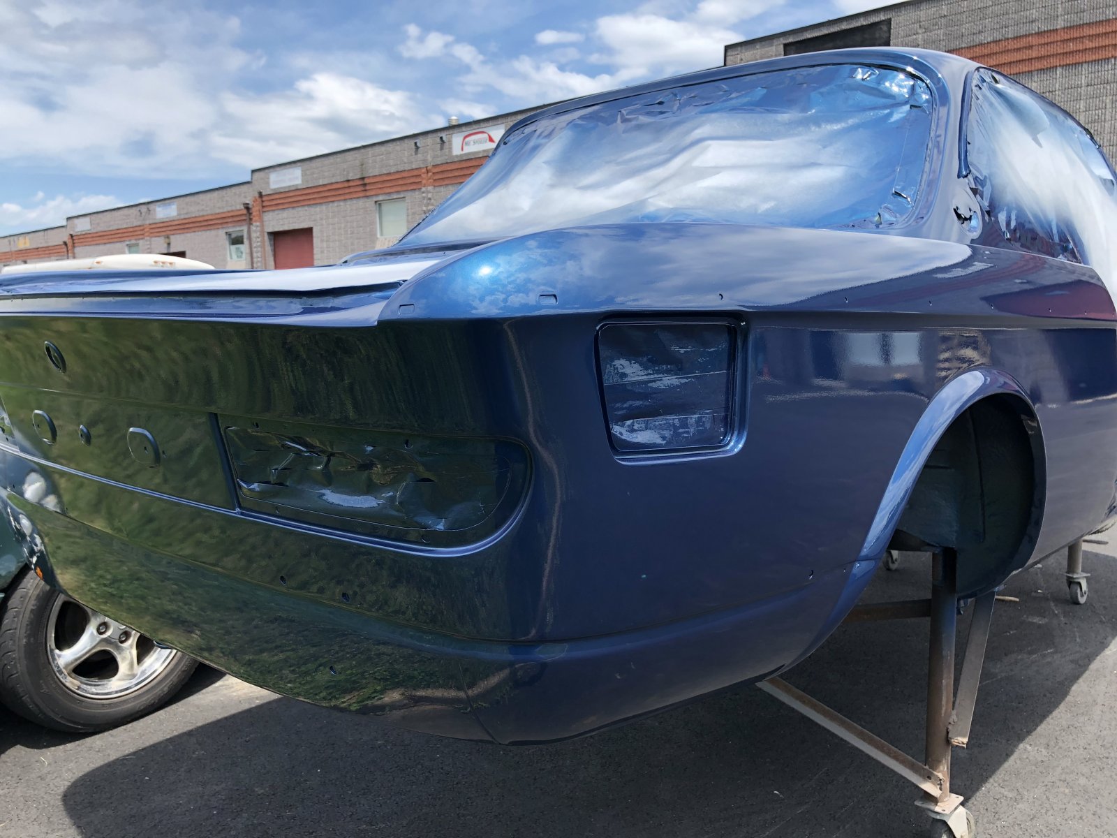

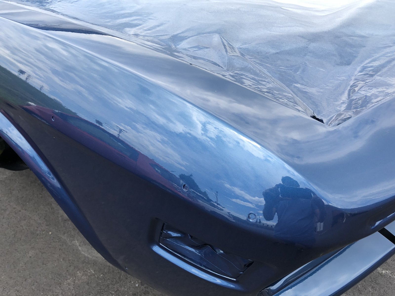

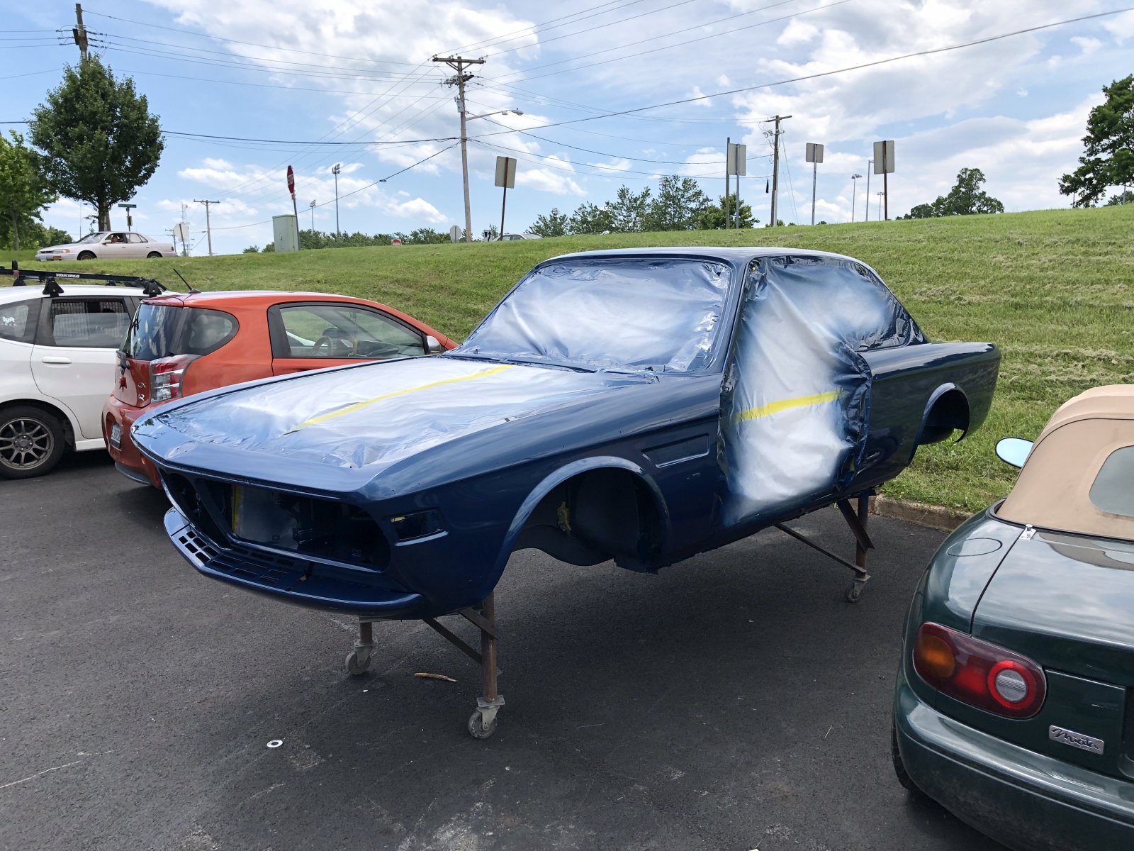

And now have a painted exterior, looking good.
