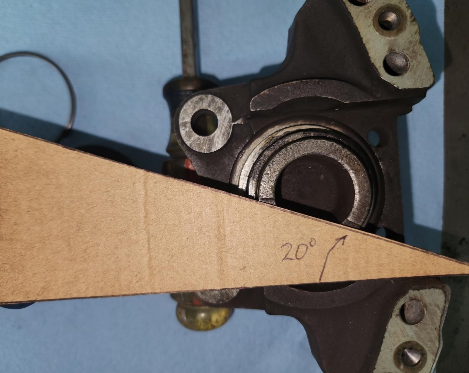

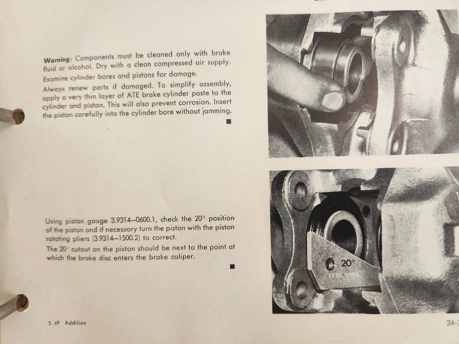

So here's where we are. Got the piston started and spent a lot of time creating my substitute for the BMW tool to orient the piston that supposedly quiets the brakes, not that the Blue Bible tells you why this is so important (if it really is).
4. Here's how my expensive 3.9314 - 0600.1 tool is used.

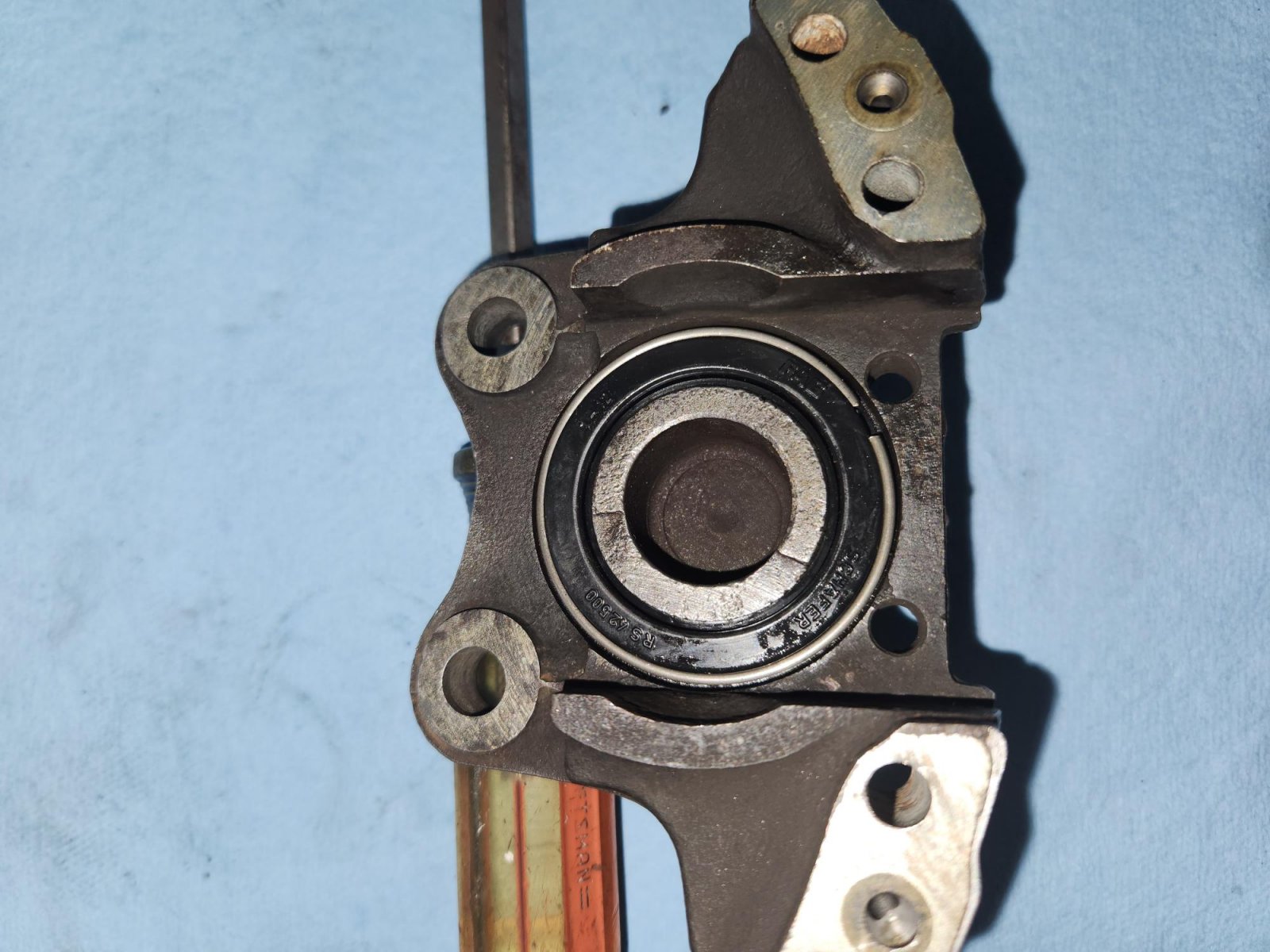

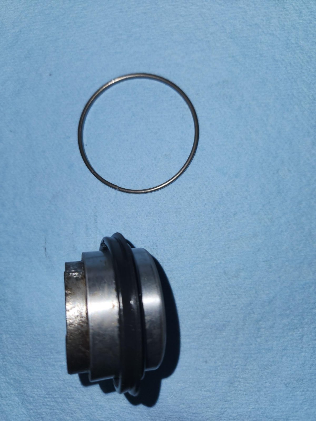

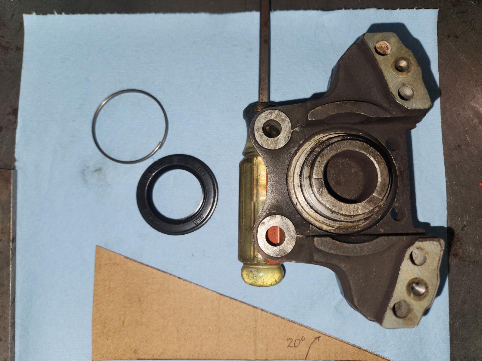

5. But what about the darn dust boot? More YouTubes that don't really seem to answer the problem. And some guys have done it so often that they are not inclined to be, uh, too helpful. I tried getting it on with the piston in place, but that was not gonna happen. So I took the piston out and put the boot on the piston.

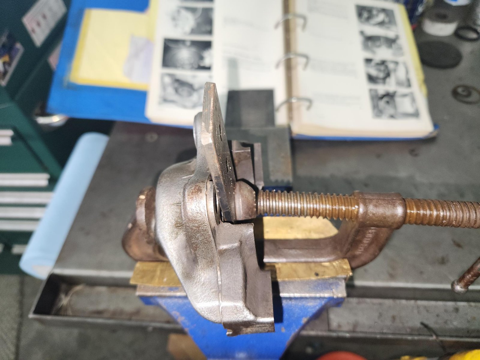

6. Put the booted piston back in the bore and press it in -- all the way in -- with a C-clamp held in a vice.
7. With the piston all the way in, the dust boots edge fits down in the groove and the retaining ring can be spread and slipped on.
