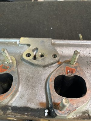

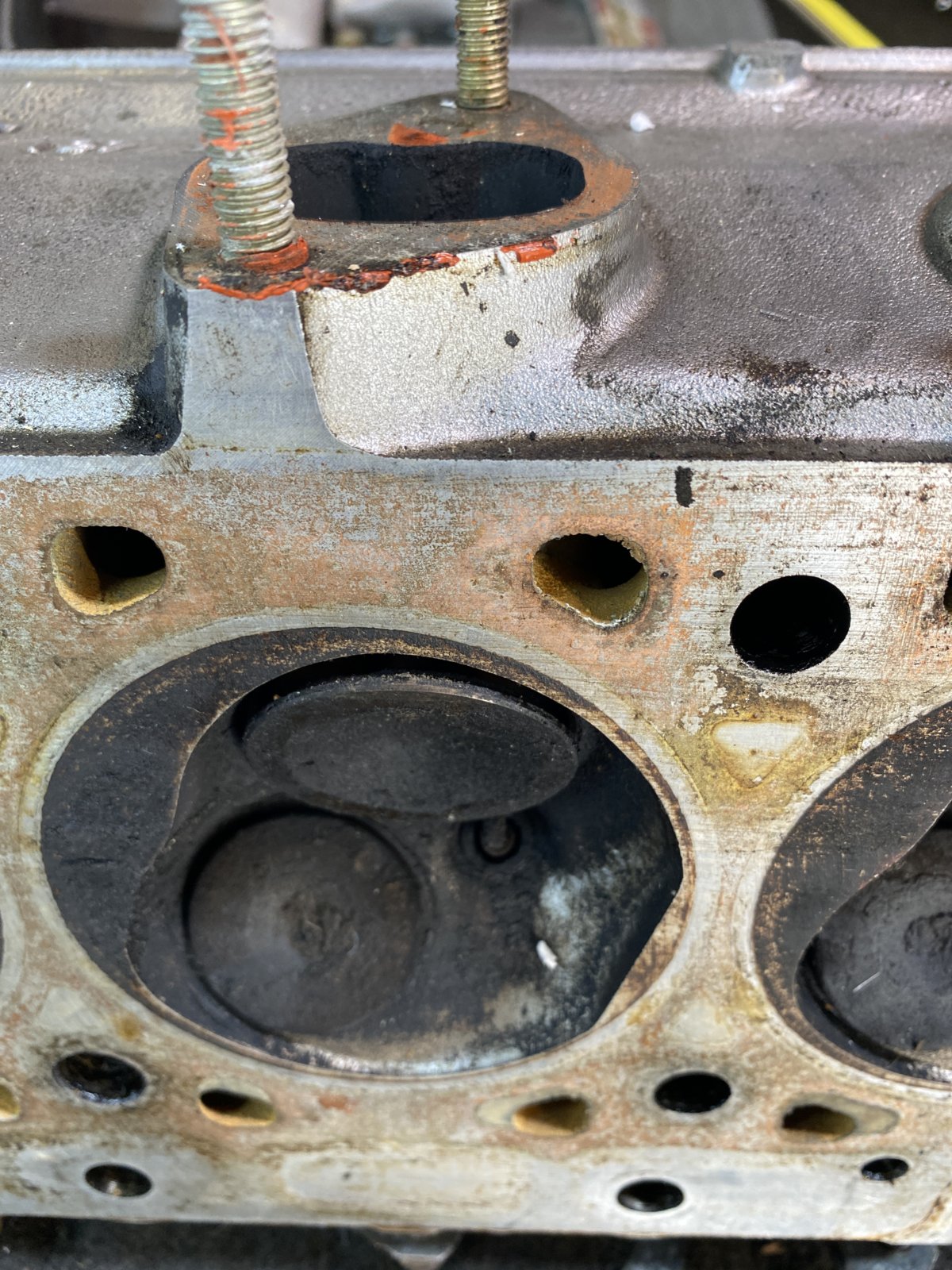

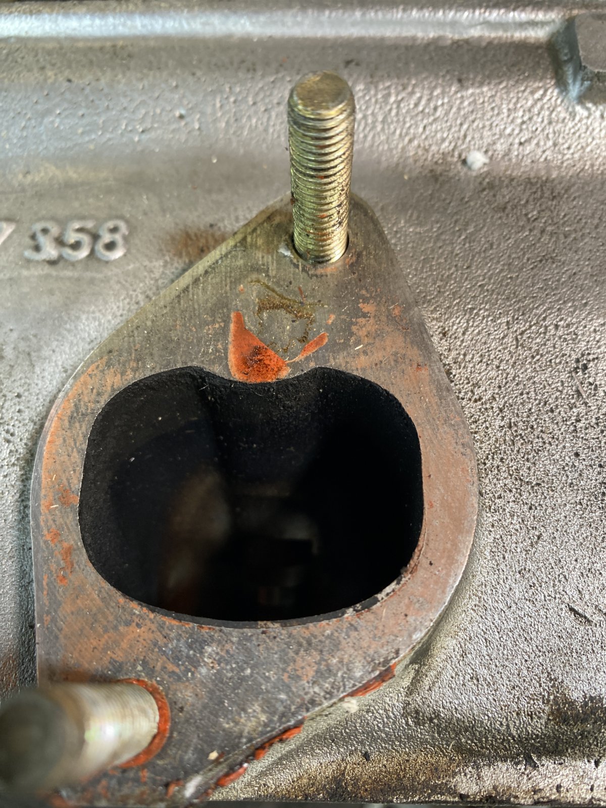

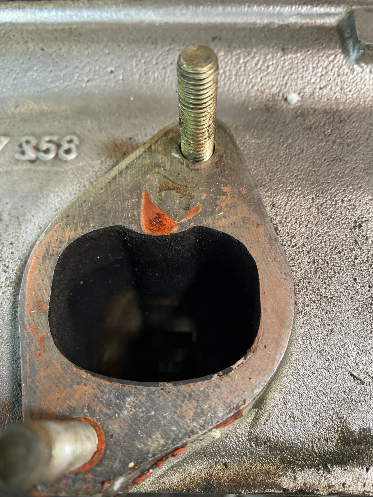

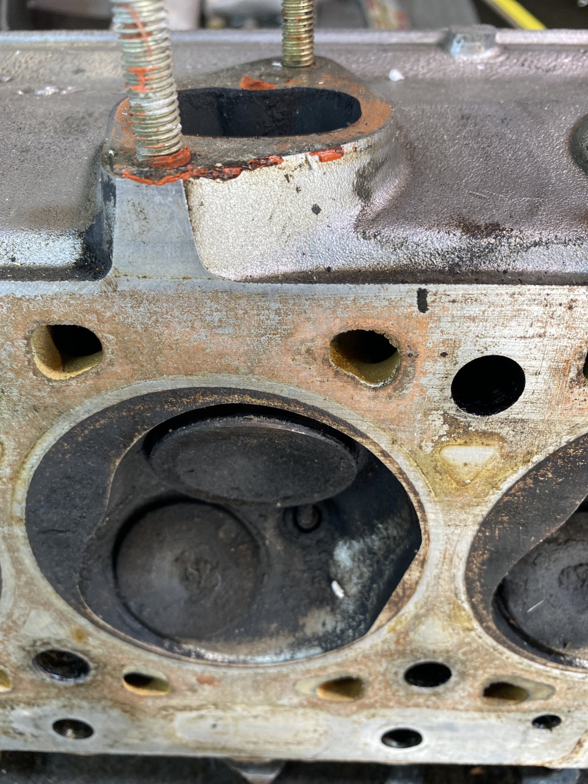

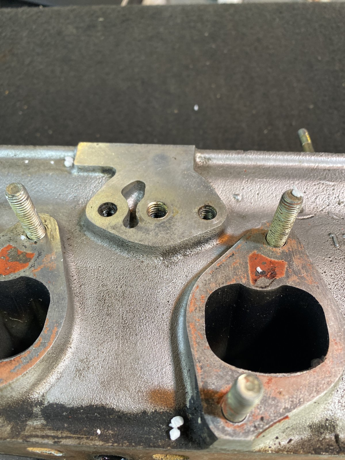

I have an ‘82 1277378 head that came off my ‘74 3.0CS parts car. I’m building (one day) a M90 for my ‘70 2800CS, so I don’t need it. Start a conversation if interested.
Later coolant passages
Later intake port
Fuel pump head
