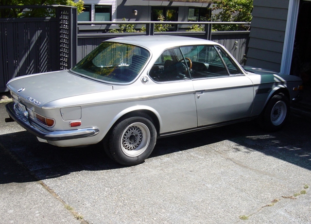

I have owned my coupe since 2004. Been sitting in my garage past 6 years. I put an add on CL Seattle yesterday and was flooded with emails from non bimmerheads so I pulled the add. Has rust. Passenger floorboard is thin, rust in sheet metal near both front strut towers and minor surface rust. Asking $5,500.
Polaris on blue cloth interior. 4 speed. Engine rings are worn. Webers need to be rebuilt. Runs like it has been sitting for 6 years. Email with questions or photo requests. Put "e9couple.com" in the subject line.

Hi Kevin,
Email sent. I don't need another project coupe but I would be happy to take a look for our members if you are nearby.
Looks like a good project- price very fair, probably could not recoup the cost in parts if it's unrestorable but for the right person it looks like it's worth the risk. Forget the seals, Save the coupes!
I met with Kevin today. What a nice guy! Pics on the way!
I would say that this car is definitely worth the full asking price. One would be hard pressed to find a better car for the price. Honestly, if I wasn't emotionally invested in my car and I didn't have a detailed history on mine, I'd consider swaping them out.
This is a good car for someone who wants a cheap project driver. It could be a candidate for a full restoration, but it looks solid enough for a cheap respray, low budget metal work, and pure enjoyment.

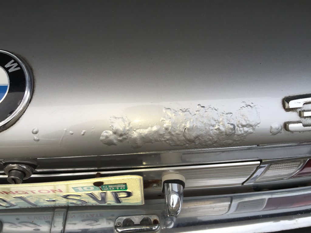

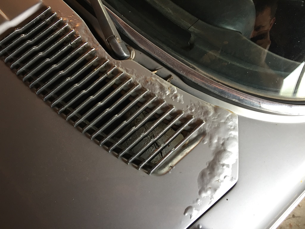

The car appears to have an original color of Granatrot, with a respray to Polaris. There are random rust bubbles around the car, likely highlighting some past bodywork. At 15' the car looks nice.

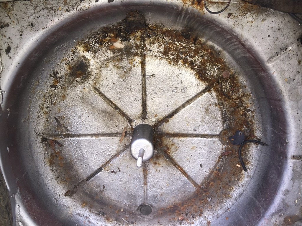

I pulled the passenger rear seat and the subframe mounts are rust free and I didn't see much of any rust under the seats. The rear floors have some rust forming in the seam that catches water (see Peter's video), but the rear pans look good enough.
I pulled the spare tire. It looks a bit thin and has surface rust, but seemed sturdy enough with no sign of repairs. The underside looked good.

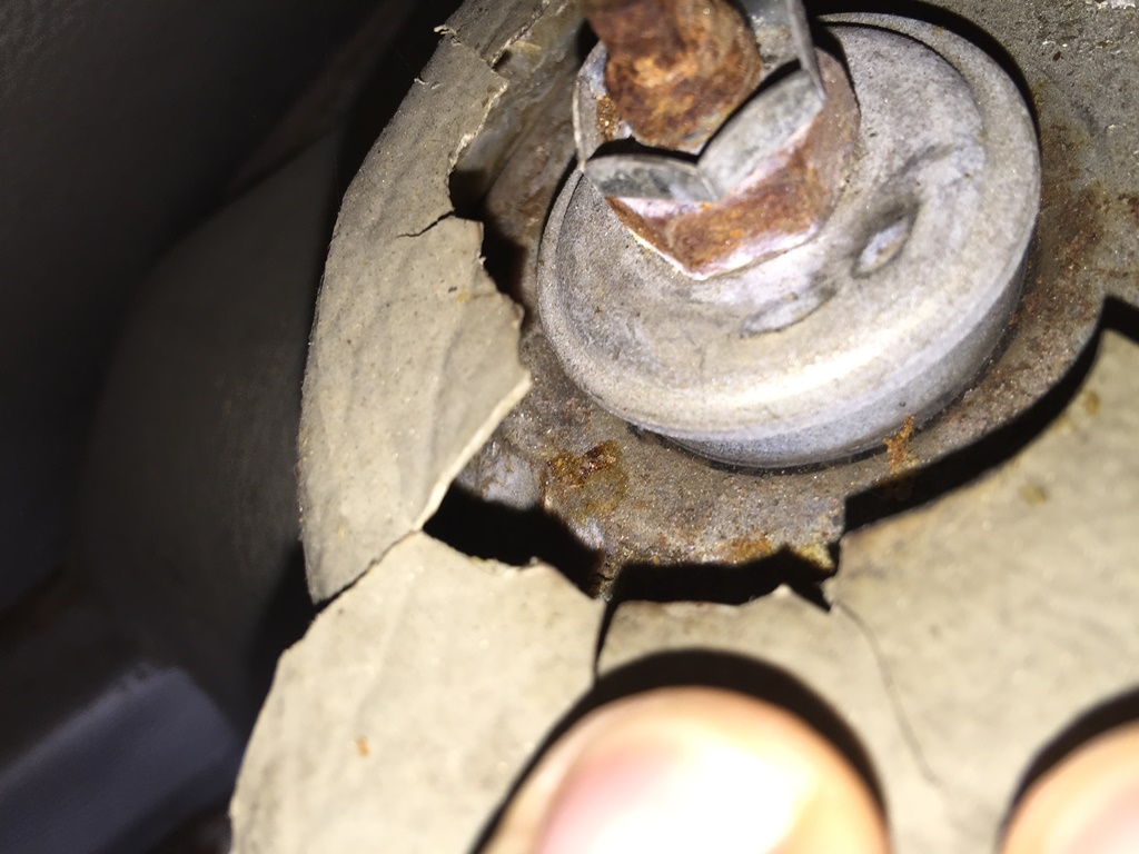

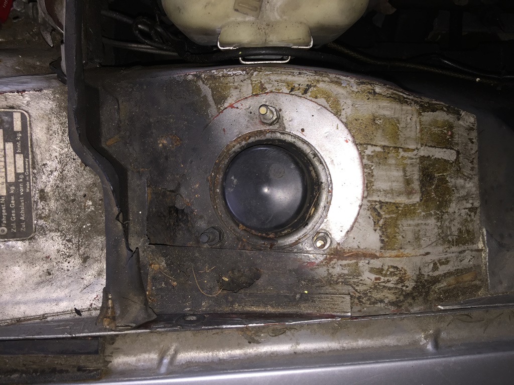

The shock towers looked solid but I didn't want to pull too hard on the elephant skin. There were some very large washers on the shock mounts, but I don't think they were welded in place. I took pics that may help.

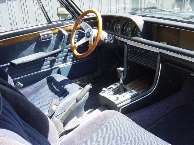

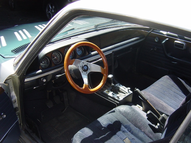

The interior is in fair shape for the price. The rear seats are in good shape. The passenger seat is in good shape, the driver's seat is in fair shape. Kevin also has spare factory stitched seat fabric in very good shape.
The center console is partially assembled and the wood base is disconnected from the console sides. The car has a nice factory boot and a later model , but period correct leather knob. The steering wheel looks like an 350mm (or less) 80's Personal. Kevin has the factory wheel and it's in good shape.
The dash is in fair shape. I don't recall any major cracks on the cluster cover, and there may have been a crack on the main dash top. The dash wood has flaking clear, but is not delaminating. The same goes for the door wood.

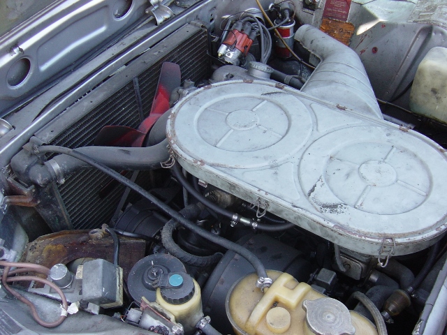

We fired up the motor, using some starting fluid. It has weber down drafts. The motor mounts require replacement. The engine is missing and it feels like one cylinder isn't firing. I didn't investigate for long.

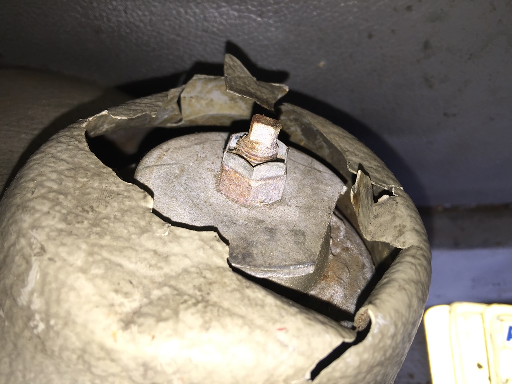

Kudos to Kevin for being such a good sport about putting his coupe under a microscope for the benefit of our community. As mentioned I definitely think this coupe is worth $5K. I hope that a member jumps on this one.
With that said, I'll focus on the 'opportunities'...

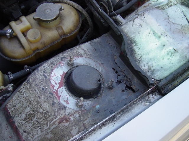

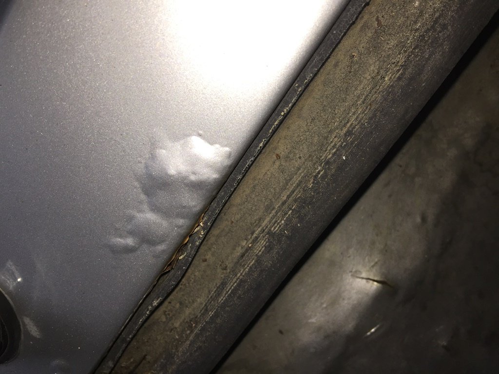

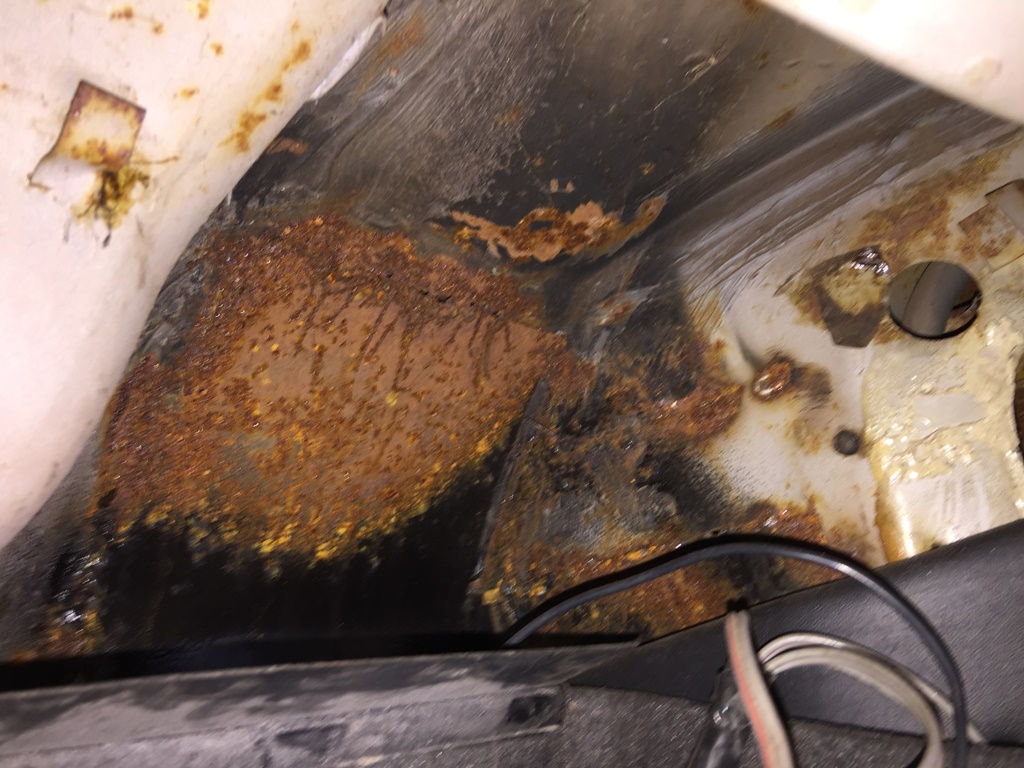

Inner fender tops starting to erode. Very fixable IMO, structure underneath seems sound.

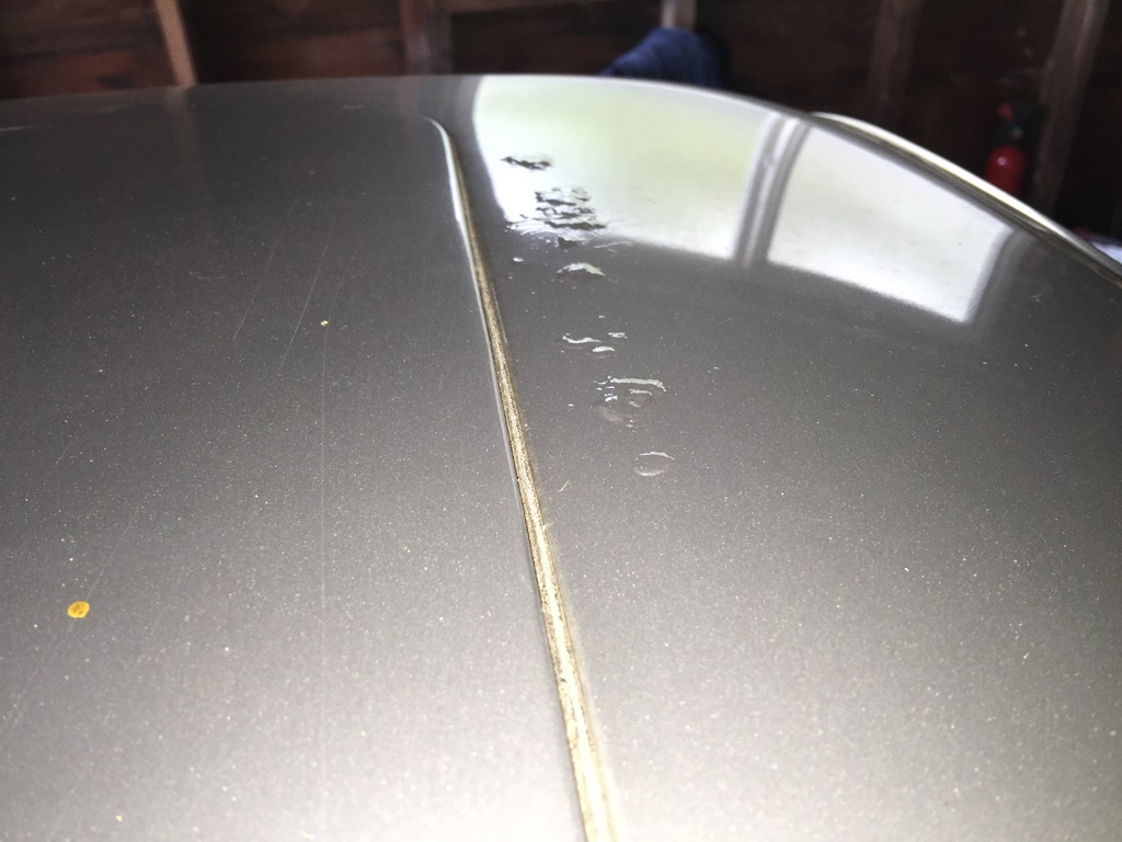

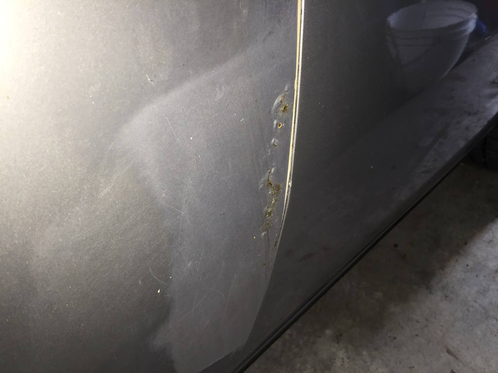

The bubbles

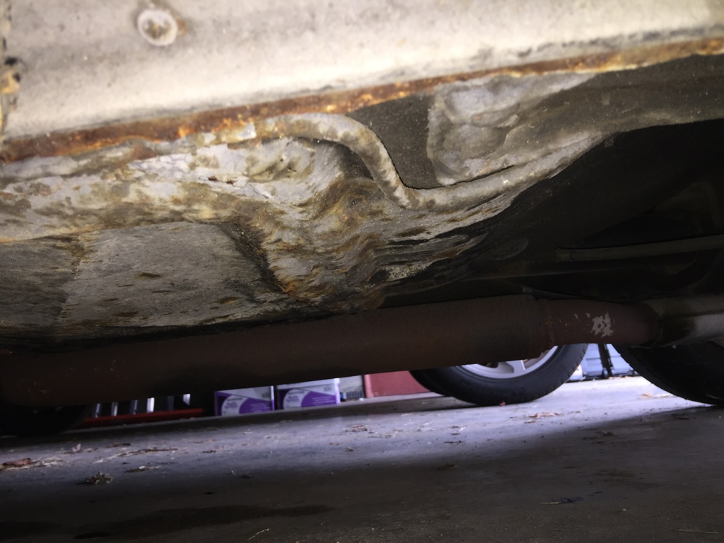

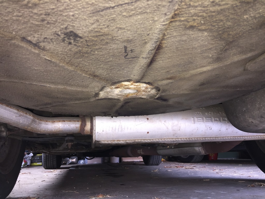

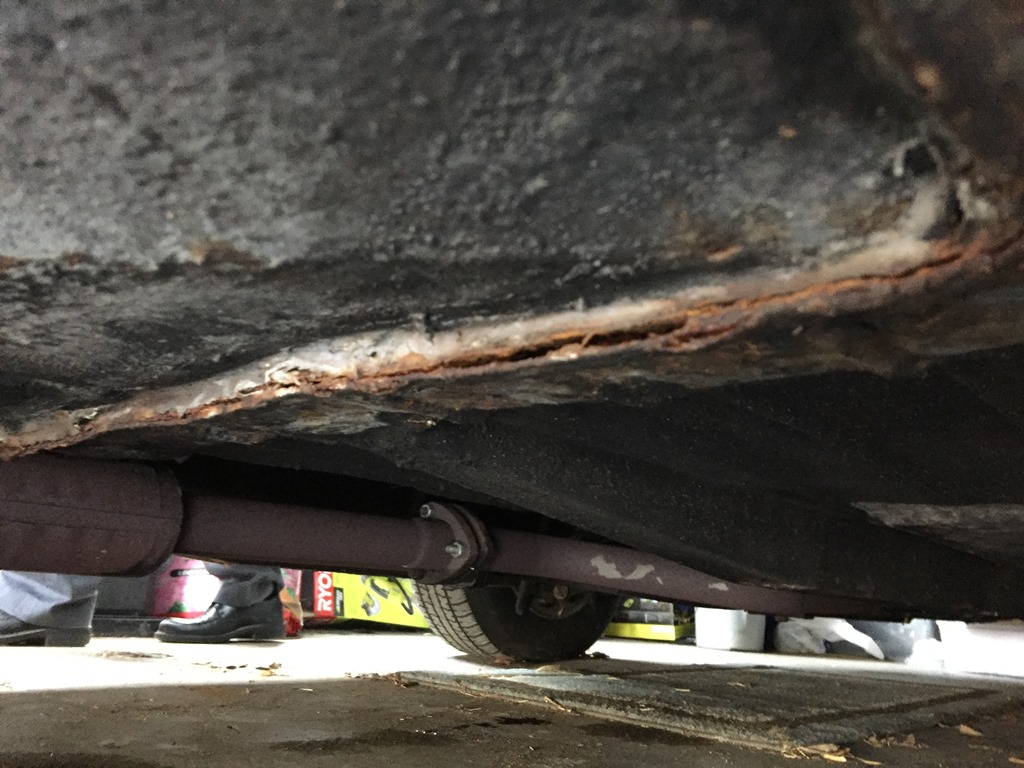

A glimpse at the belly

$5.5k is definitely fair.
However, car like this needs to be completely stripped, dipped in caustic solution/acid/galvanized (they do that at Redi-Strip up in Vancouver, BC) to get out all the rust. That's about $5k.
Then I forsee another $15k in body work alone (not including paint). But you'll have the most solid body E9 afterwards w/a known history. Something $50k cars don't always have.

Thanks for posting the images Markos! I agree that the 5.5k asking is fair. I am a bit on the fence though about the number of places where there is corrosion and whether it suits what I am looking for to complement the 2800CS I already have.

Markos, Option 2 is problematic as the strut area rust surely has more below so a sheet metal fix there is cosmetic only and not fixing the real rust issue.
I totally agree but the area below the rust hole is fine IMO. The rust starts from water under the sound deadening, and works its way down to the 'fender box' (which looked good when I stuck my phone in there. The plate below the inner fender is pretty thick, and this looked solid to me during my cursory look. I'm intimately familiar with that area at this point because I have complete access to it on my parts car. :) I think it's fine to drive and the current owner has done so for years. It looked like that when he got the car, which makes sense for everyone who garages their project coupe.
I think the biggest risk of a 'respray and drive' would be new paint that started to bubble due to not properly fixing the surface rust
