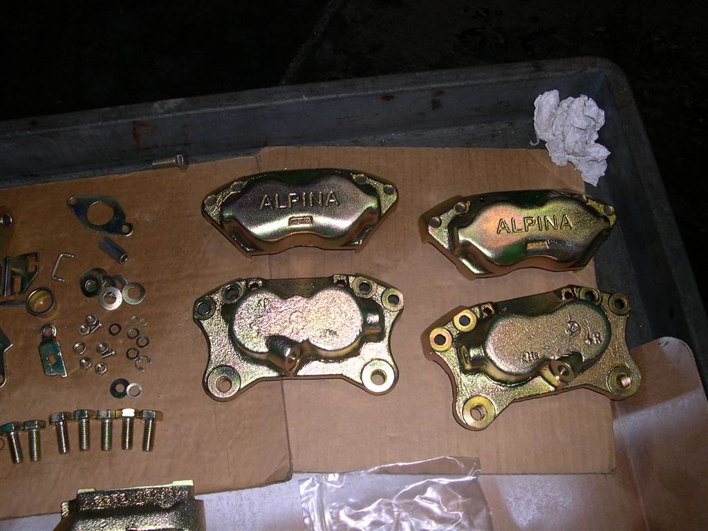

Thanks for the info. I do want to reiterate - I would like to see original pics to determine original color of calibers/shields/etc.
Believe the original calipers were yellow zinc plated which rust pretty easily. They should look very similar to the attached pic below. Not mine! If interested, I can put you in touch with an E24 Alpina enthusiast who refurbishes and rebuilds calipers at very reasonable prices. He is located somewhere near Atlanta, I believe.
