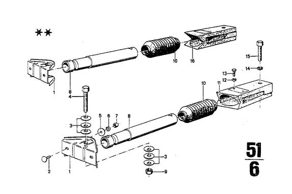

Hi Everyone. Looking for the '74 front bumper shock absorber (pn 51111826692) and rubber block (pn 51111830678). Doing a conversion to '73 bumper and accidentally discarded those parts not realizing that I needed them.
not sure that you would need any of the 74 parts to go to a chrome bumper - radically different mounting scenario. so here's the question, US 73 (2.5 mph) bumpers or euro 73 bumper (which is the same for all 69 to 72 coupes.
i would try to stay away from the USA 73 bumper since some of the specific parts are hard to find. if you need the mounting brackets, i believe our friend @alprada70 makes them (and his products are first rate). the euro / early US chrome bumper brackets mount to the frame rails.
