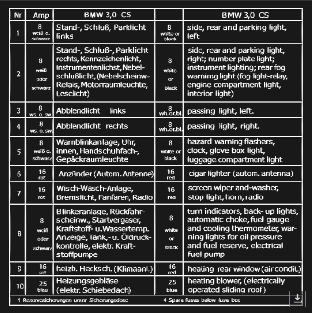

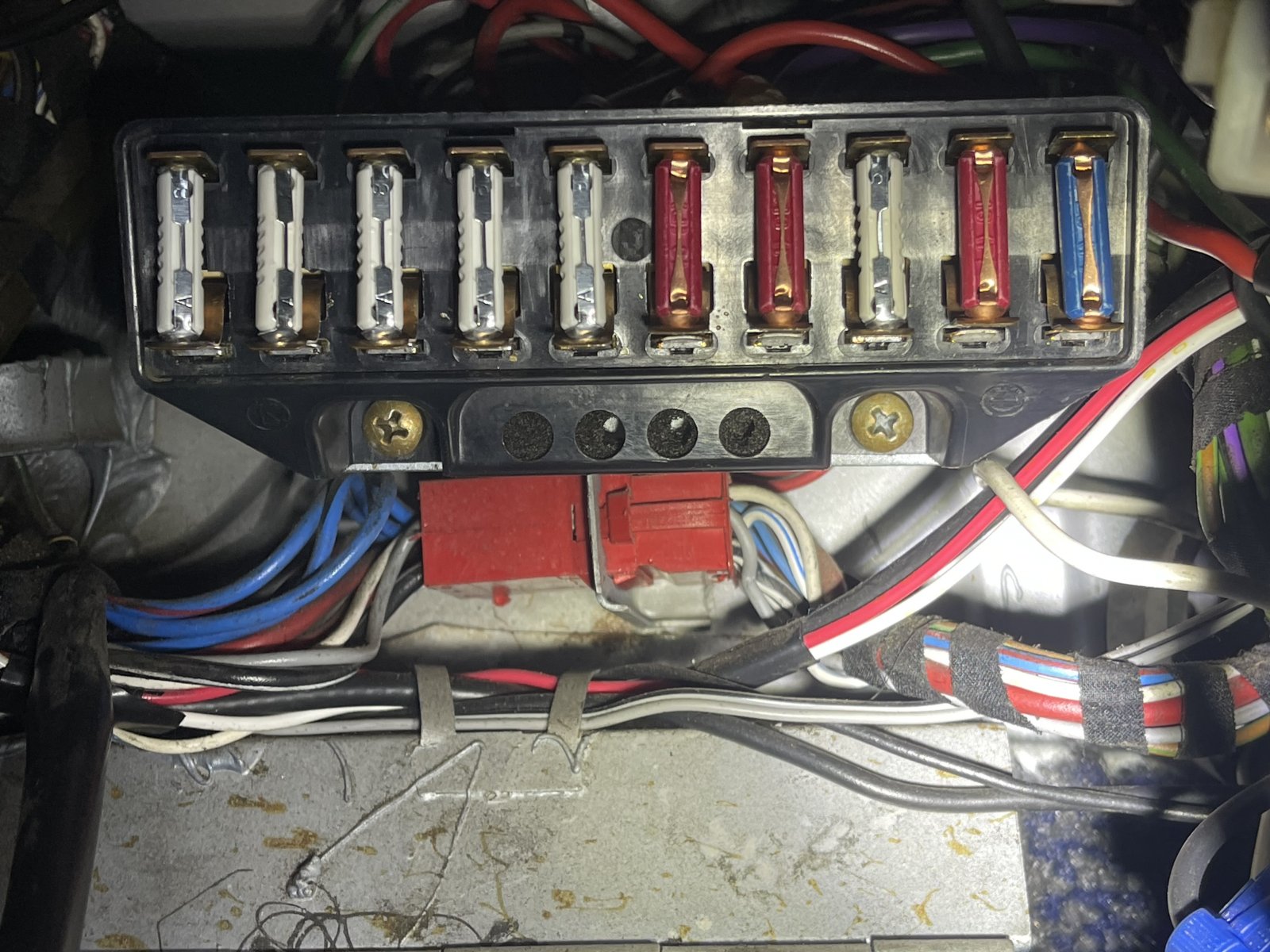

Was tracking down a blown fuse and looking for a reference photo of a '74 fuse box and didn't find one via search.
Did find a '74 sticker photo in another post here and used it to replace the blown fuse and some other installed glass fuses with ceramic and thermoplastic continental-style fuses. Photos of both posted here in case its of any use for others and for any corrections if there's any errant placement in the assortment.
