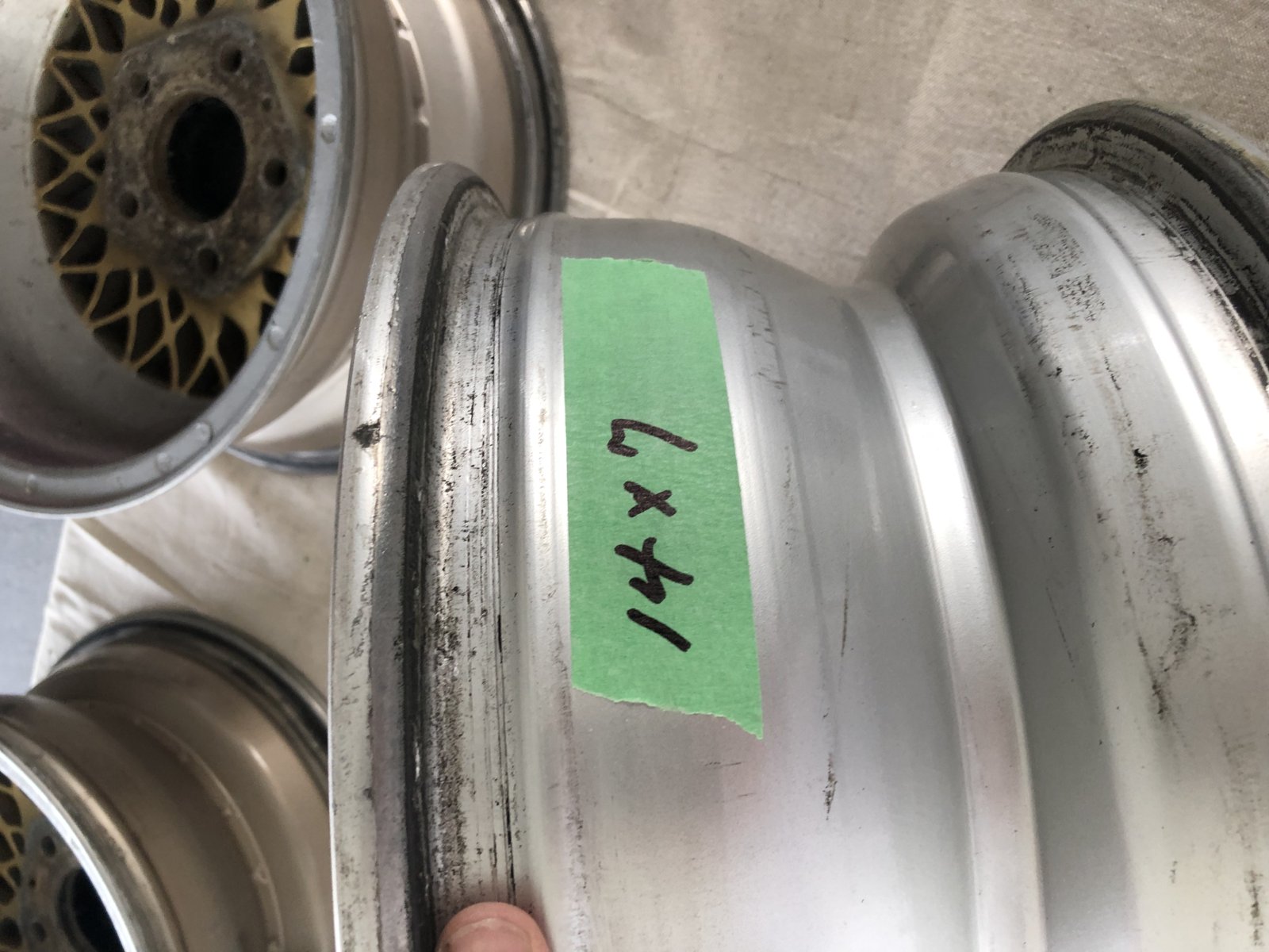

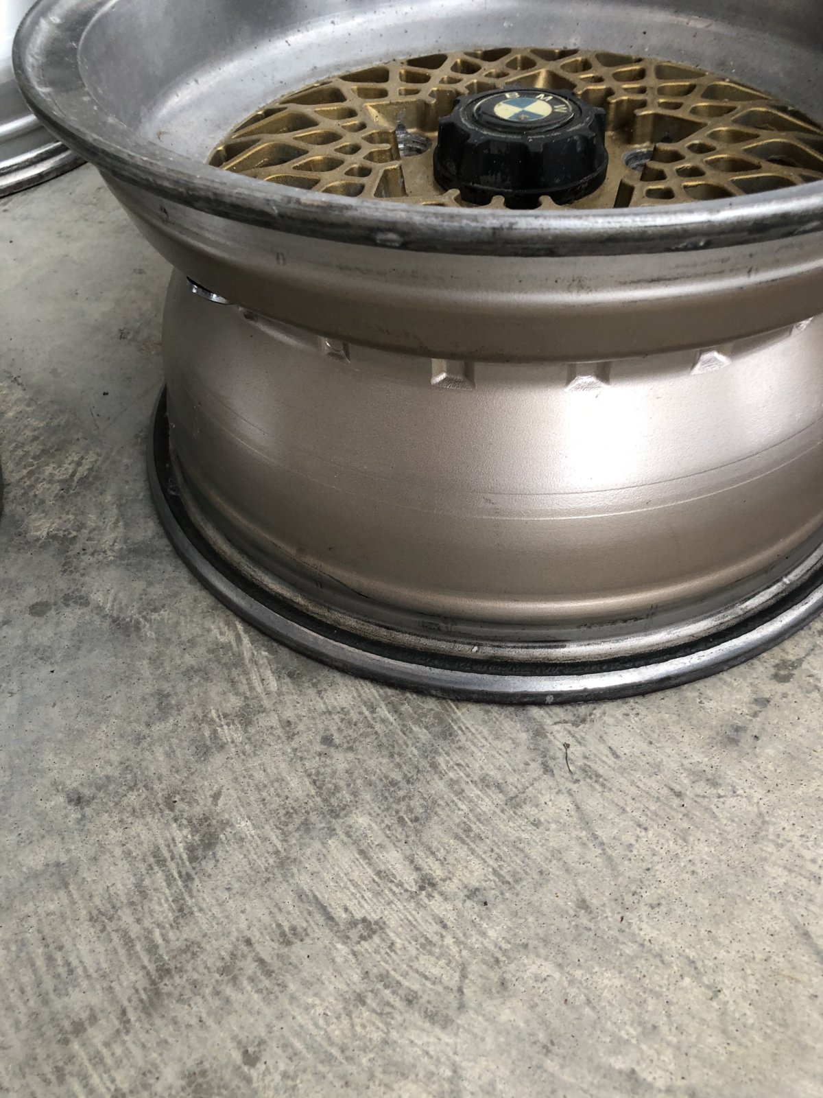

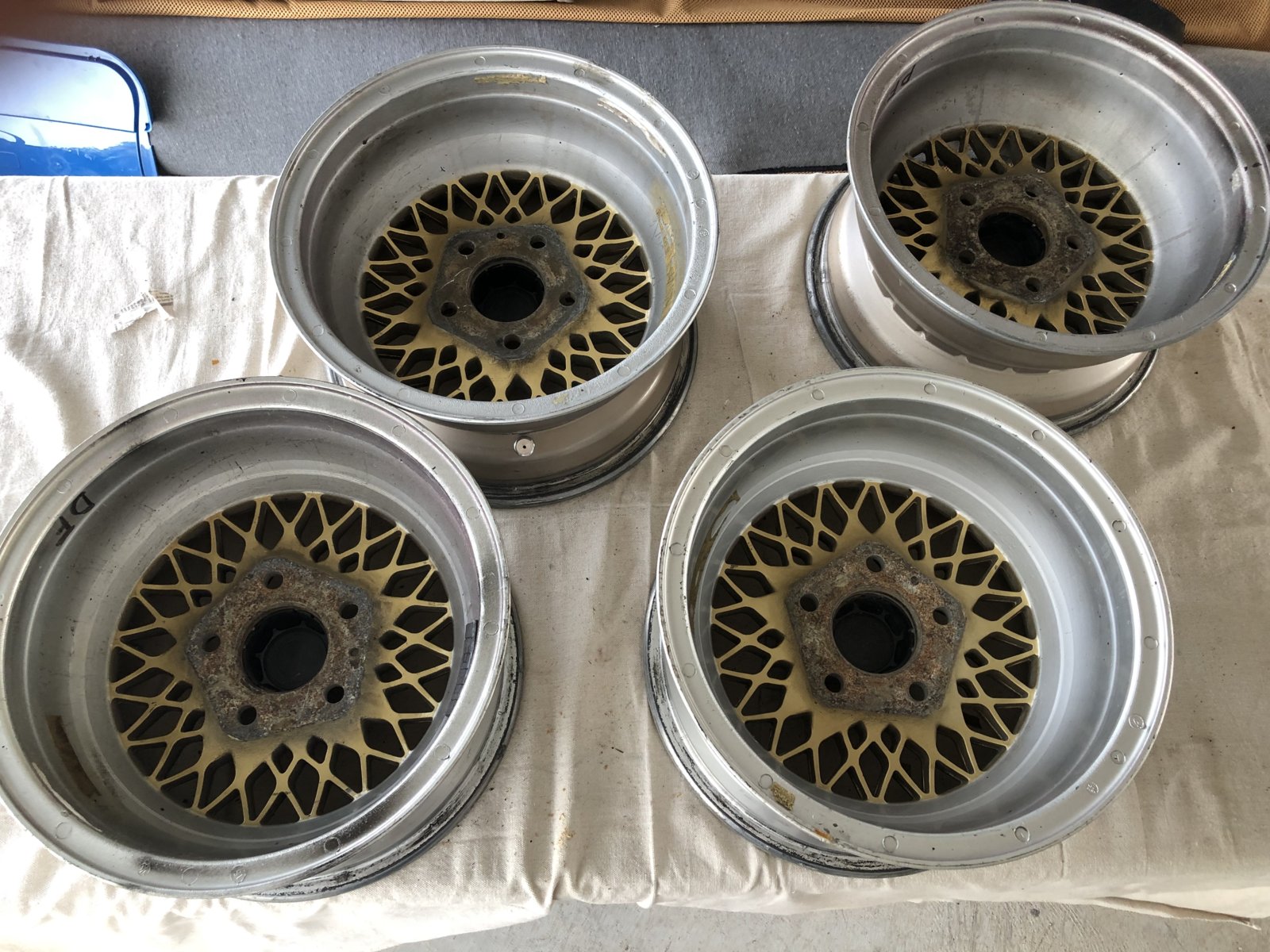

Will consider any reasonable offer. I’m located in the Houston area and just finished my e9 restoration. The wheels were used for a few years in the mid 80’s then put up in storage since then. Looking for them to go to someone that can put them to good use.
4 1/2 inches. Please see pics attached.

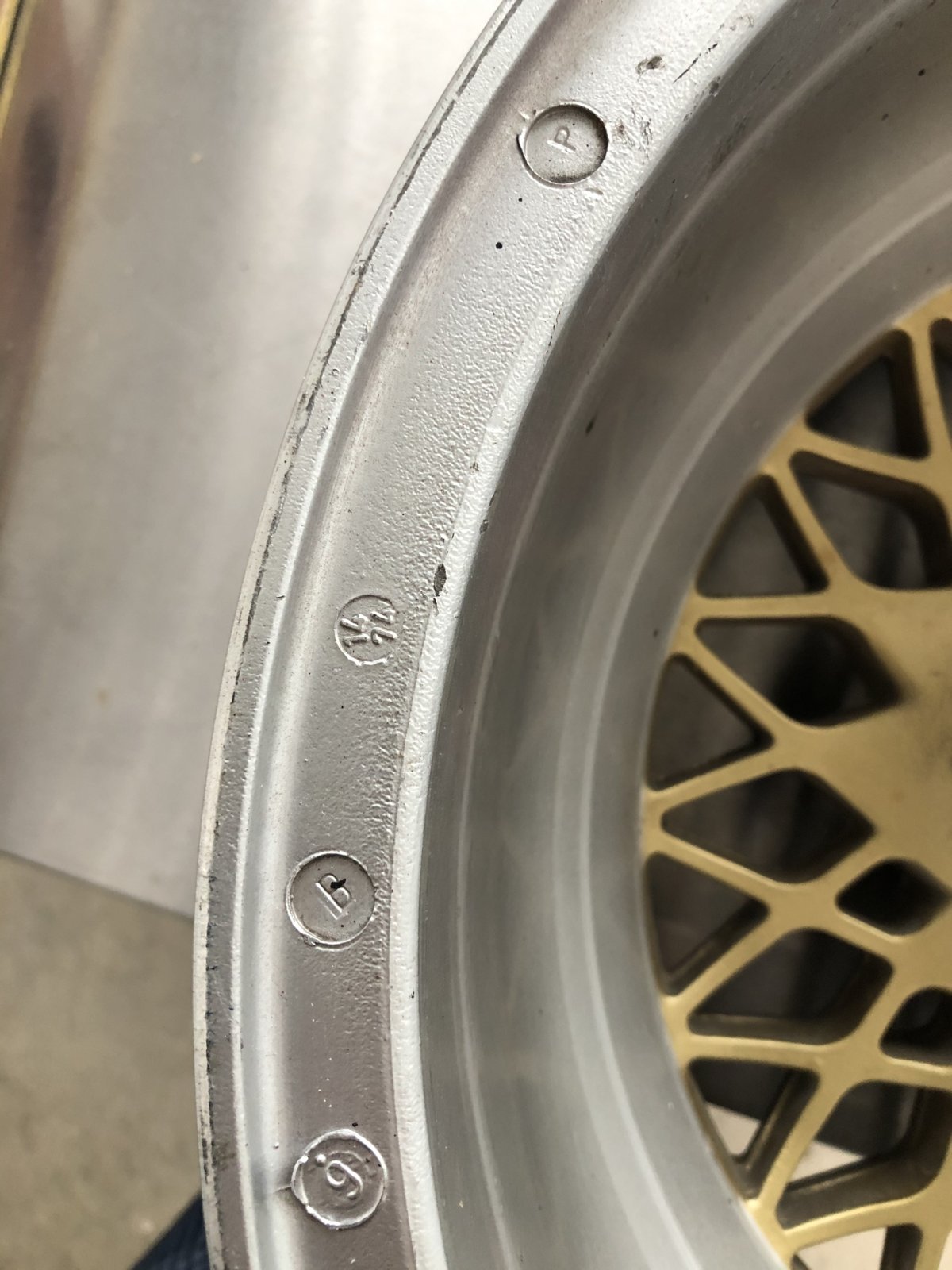

That would be 4 1/2” of backspacing, which is not the same as offset. A 7” wheel is approximately 8” wide. That puts the center line at 4”. This means the wheel is 1/2” closer to the strut than the center line. 1/2” = ET 12.7mm. The offset is likely marked on the wheel, and is likely somewhere between 9mm and 13mm, all of which fit an e9 front and rear.
I've looked at the photos but I can't see any of the factory markings on the wheels? As Markos said above, it'll either be ET11 or ET9.3.
Here are the only markings on the wheels. I see a “9” so maybe it’s 9mm offset ??
