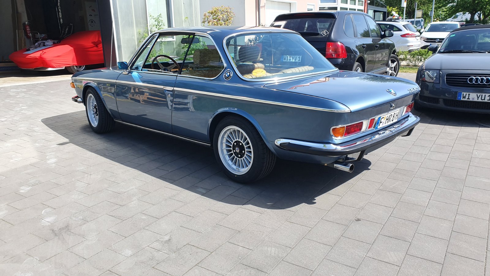

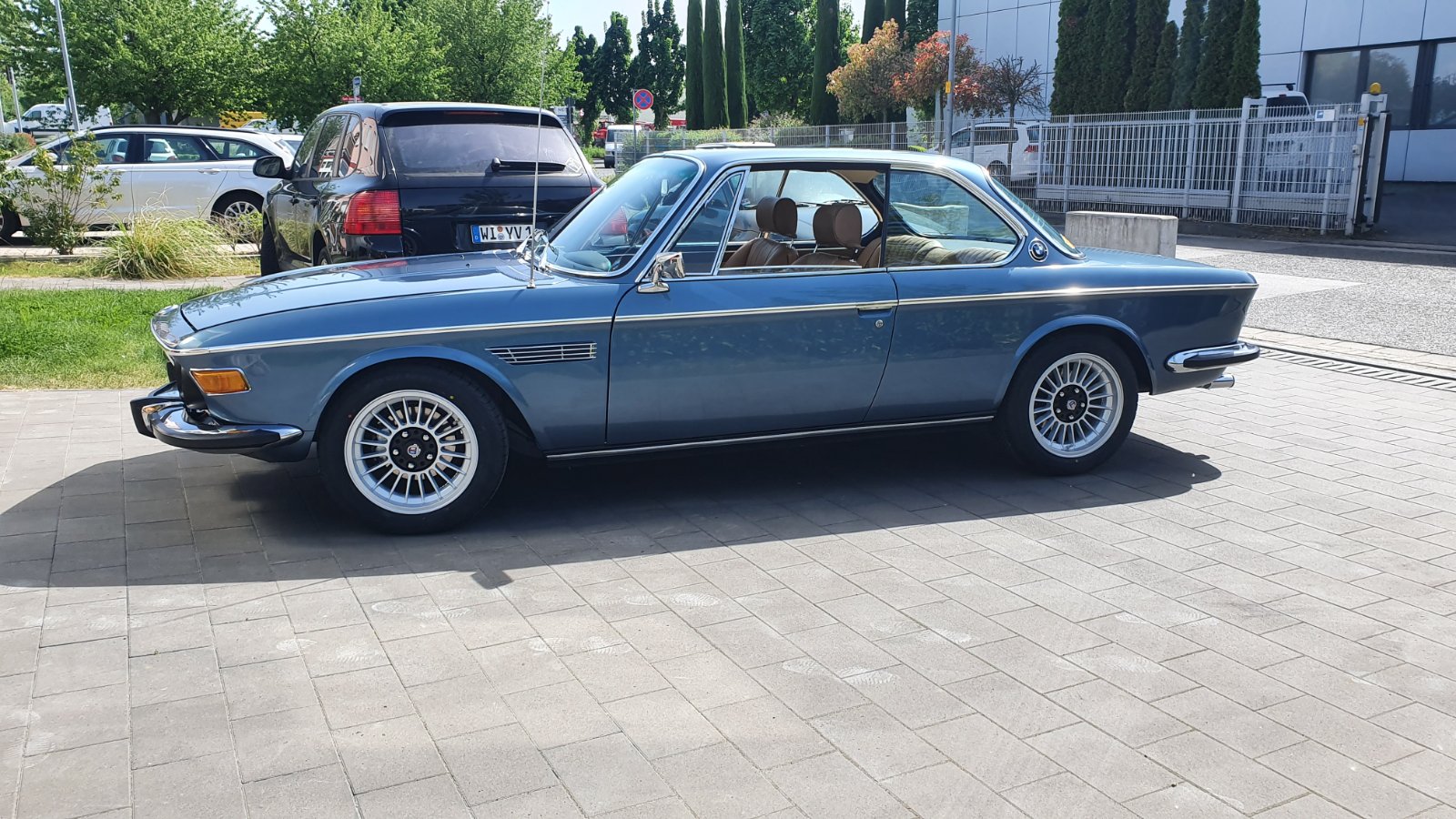

Breiti Well-Known Member Site Donor Messages 366 Reaction score 539 Location Mainz Germany Yesterday at 3:58 AM #2 225 50 16 At the rear Front with 7x16 e11 205 55 Front fender has to rol a bit the edge. Got 5mm track wide on rear axle Breiti Attachments 20250502_153454.jpg 300.7 KB · Views: 16 20250502_153443.jpg 364.4 KB · Views: 16

halboyles Well-Known Member Site Donor Messages 745 Reaction score 749 Location KC Yesterday at 8:44 AM #3 Those look great on your E9. So I guess their is no easy way to use 8X16, E24 wheels on the front?
Breiti Well-Known Member Site Donor Messages 366 Reaction score 539 Location Mainz Germany Yesterday at 9:28 AM #4 Depend on the tire size I think. But also due to the big backspace they could have contact on the back side. All over, I don't know You have to try it. But why so big rims on the front? They both look identical from the outside due to the different backspace 11 vs 24 Breiti
