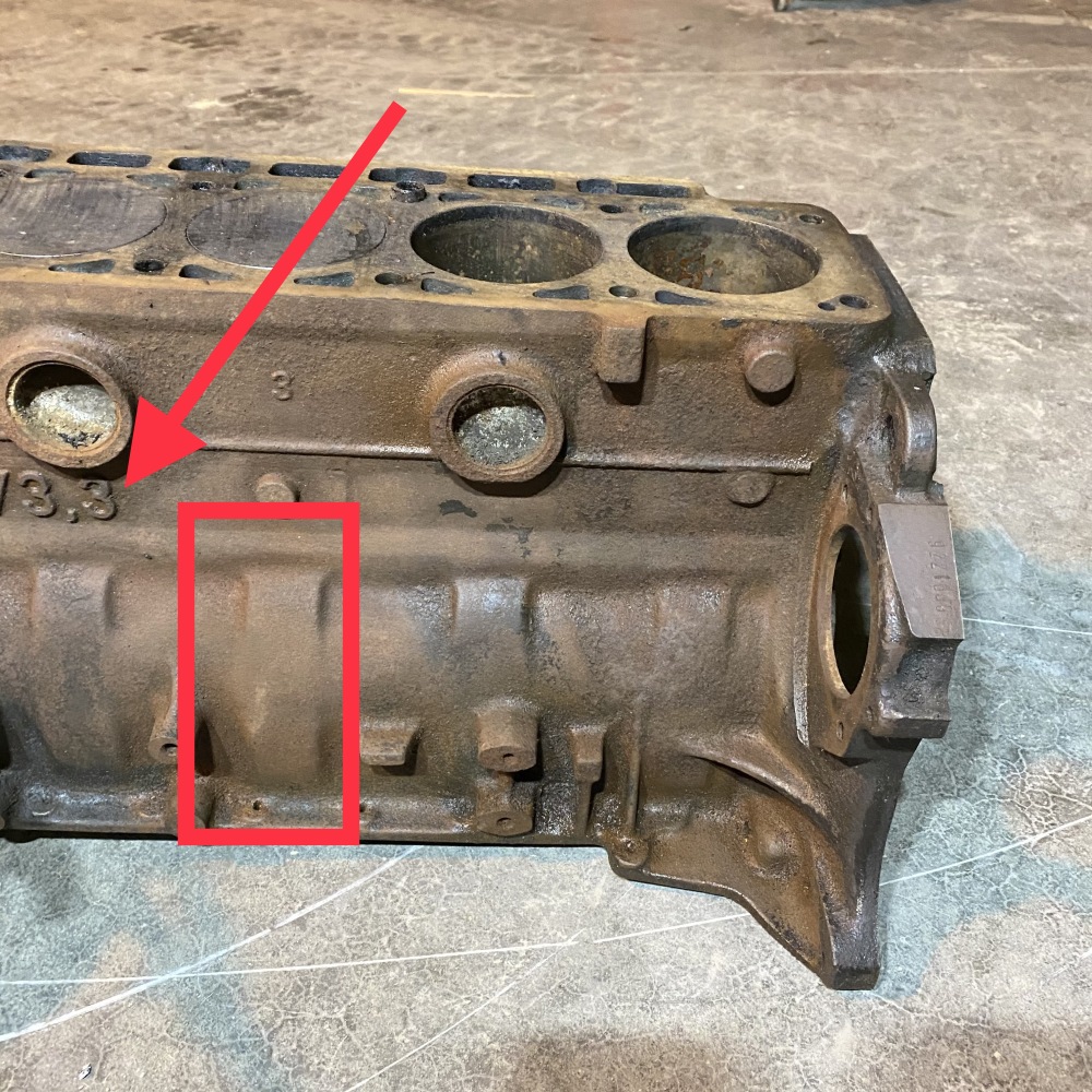

3.7L makes sense for a 3.5 core. I’m fairly certain that you can’t bore a 3.0 to 3.5+, and you also can’t stroke it all that much. The 3.0 does not have recesses in the block to account for the connecting rod clearance. You can machine the block a bit but not much. As mentioned, there are/were 3.0 race motors running 300hp+.
Long stroke reliefs cast into 3.3L+ blocks:
